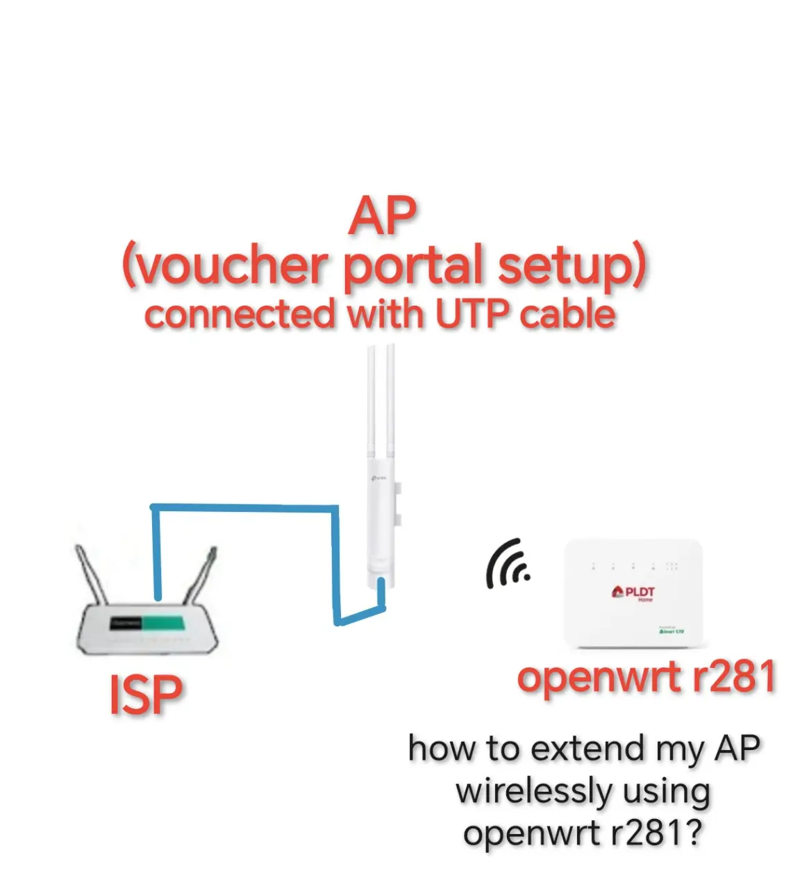

Ganyang setup po sana. I'm still getting trouble po. Na setup ko na sya as extender at successful naman lumalbas naman ung portal ni AP doon sa r281. Kaya lng, kapag na authorize ko ung r281 kay AP at na ok na ung internet niya, nag mamatic na lahat din ng mag coconnect kay r281 may internet na. Di na lumalabas ung portal nya.
https://phcorner.org/threads/how-to-make-openwrt-r281-as-extender.2331506/

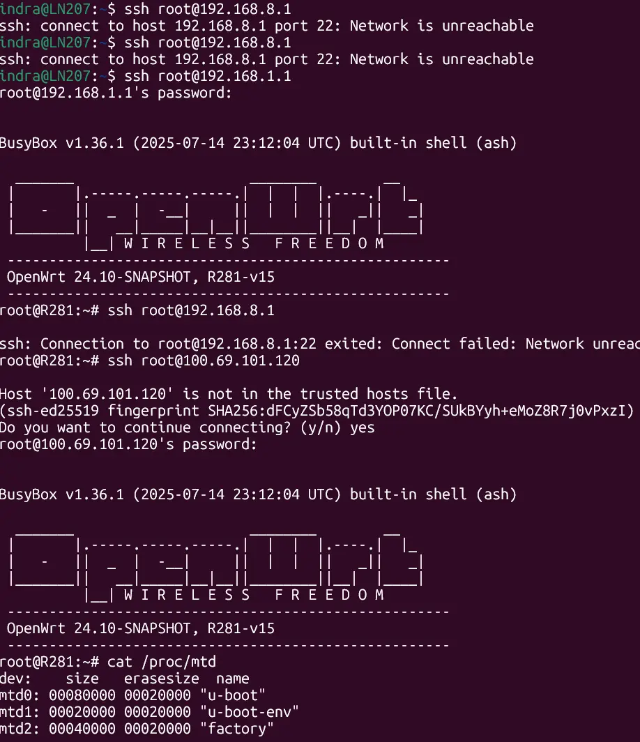

Hi, Boss Lenar. Thank you for the great OpenWrt support for the R281.
i have issue, the network cell is ready connect., but i see on wwan_4 just local ip 192.168.8.0/24. so when i try to ping 8.8.8.8 or google.com there no internet connection.
is it related to checkatvalid, because im not putting on ncm.json? i dont have a backup, and all my original/stock mtd already erase:

i think you need to flash cp and module

you don't need to add checkatvalid if you're using modded firmware.
can you try to enable pipe mode in System/Custom Commnands
why are you using PLDT firmware why not HKM

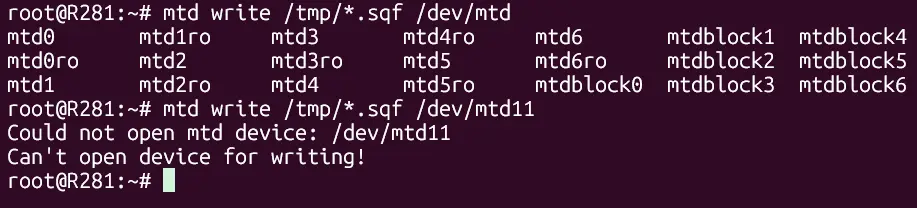

i cant follow install P28M26ITelkomsel_HKM281_CP_V003.sqf, because i don't have rootfs partitions now:
mtd0: 00080000 00020000 "u-boot"
mtd1: 00020000 00020000 "u-boot-env"
mtd2: 00040000 00020000 "factory"
mtd3: 07dc0000 00020000 "firmware"
mtd4: 00400000 00020000 "kernel"
mtd5: 079c0000 00020000 "ubi"
mtd6: 00080000 00020000 "stock-env"

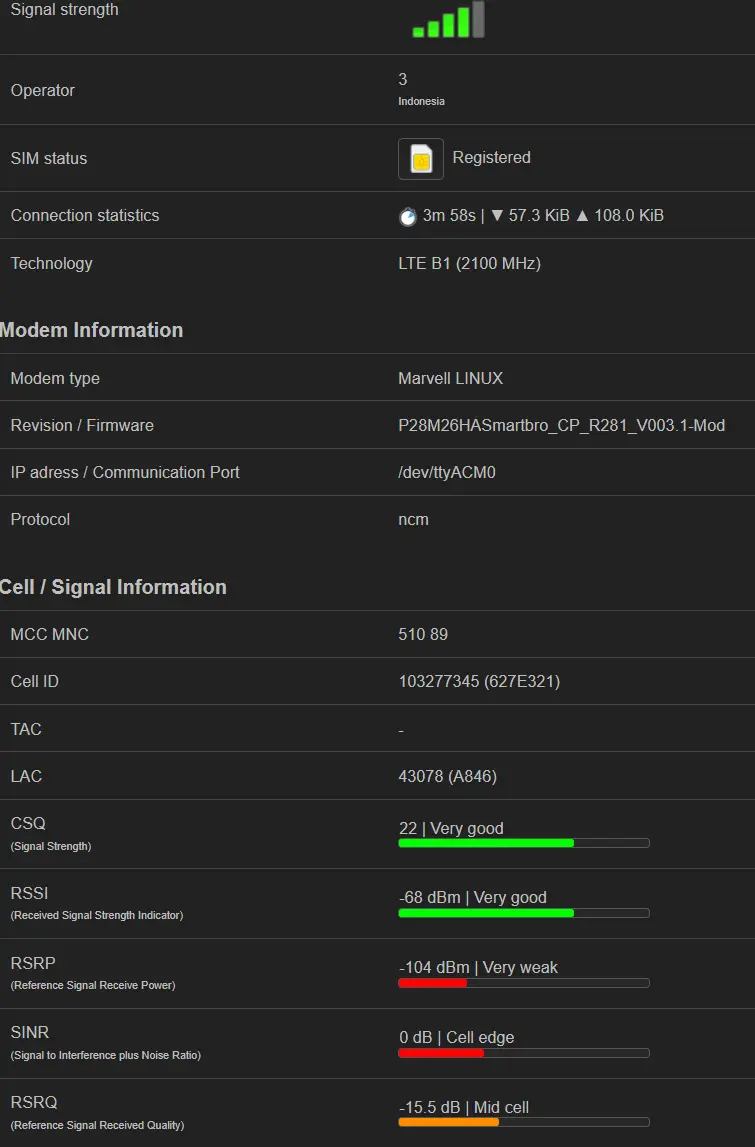

also in mediafire CP folder, there only CP PLDT, and CP Smartbro. or do you have for HKM now? how correctly install for HKM281.
my state now, reflash CP to smartbro and i feel its fast to connect to cell tower than before. try pipe e reset factory, result 0 success. but still get local dns & ip

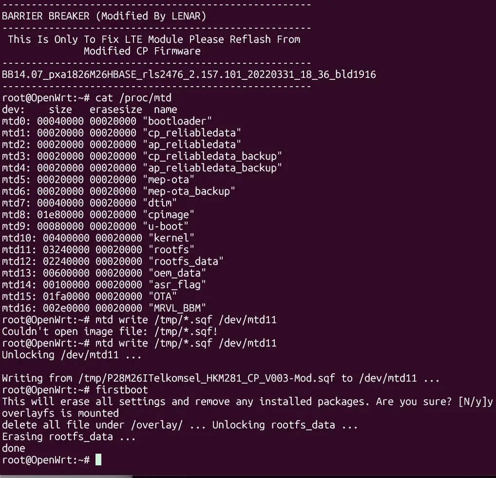

here's the modified file You do not have permission to view the full content of this post. Log in or register now. but you need to reflash the CP Firmware.
try to access the 192.168.8.1 using ssh.
Code:
ssh root@192.168.8.1
the password is notion
and upload the You do not have permission to view the full content of this post. Log in or register now.
Code:
scp -O /path/of/P28M26ITelkomsel_HKM281_CP_V003-Mod.sqf root@192.168.8.1:/tmp/
and flash it to mtd11
Code:
mtd write /tmp/*.sqf /dev/mtd11

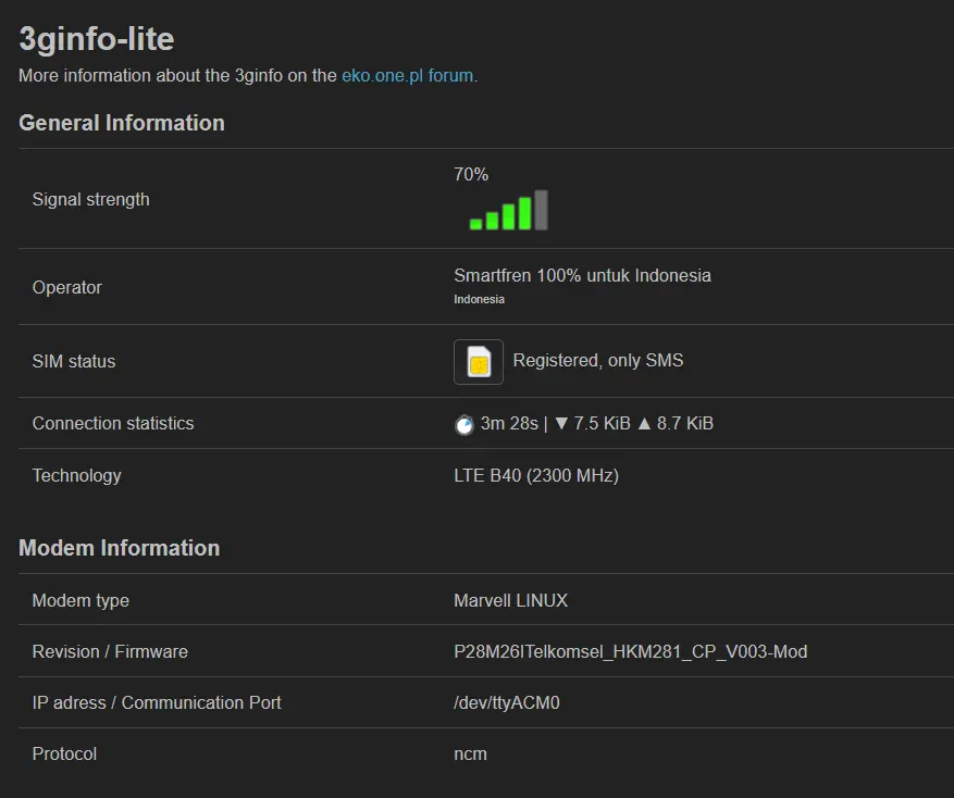

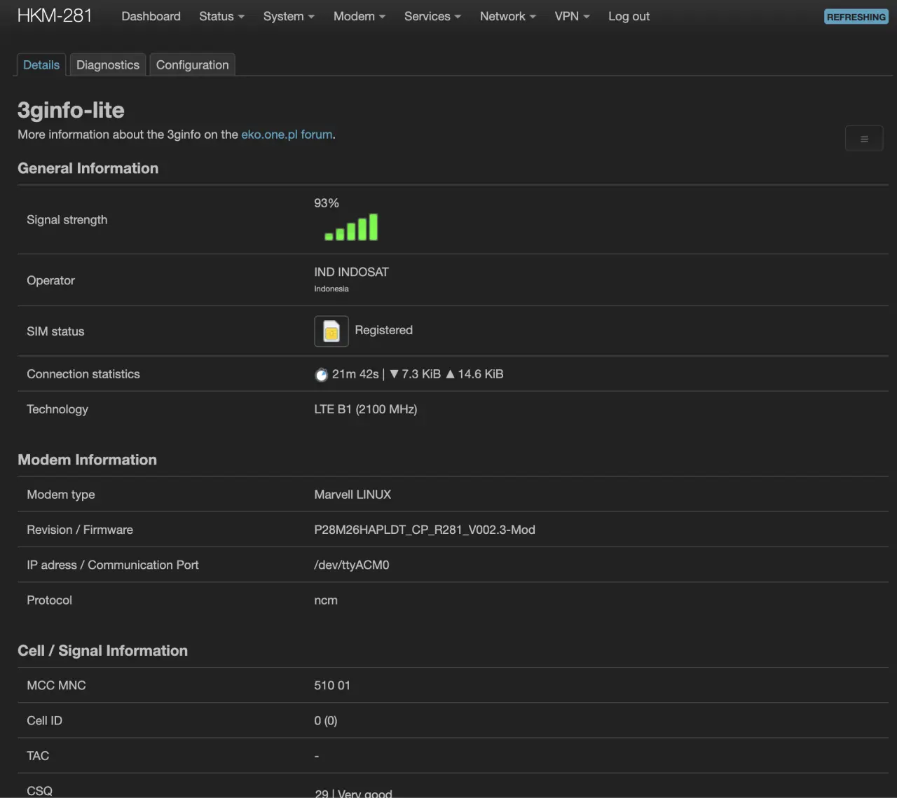

i just flash the CP and it fix the issue,
i cant write to mtd11 becaouse i dont have. and it cant be force, it must be available before write.
Thank you Boss Lenar your update CP, fix my problem.

your running the command from AP side not the CP side.
you need to access the CP side using this command.
Code:
and you still need to disable PIPE Mode to access the CP and i recommend to disable it so you won't lose internet connection randomly.

sorry wait to long, i need to reboot after PIPE d,
flash to mtd11 done.
now how to enable again? is it 'e' argument?
Thank you Lenar, it works after PIPE e.

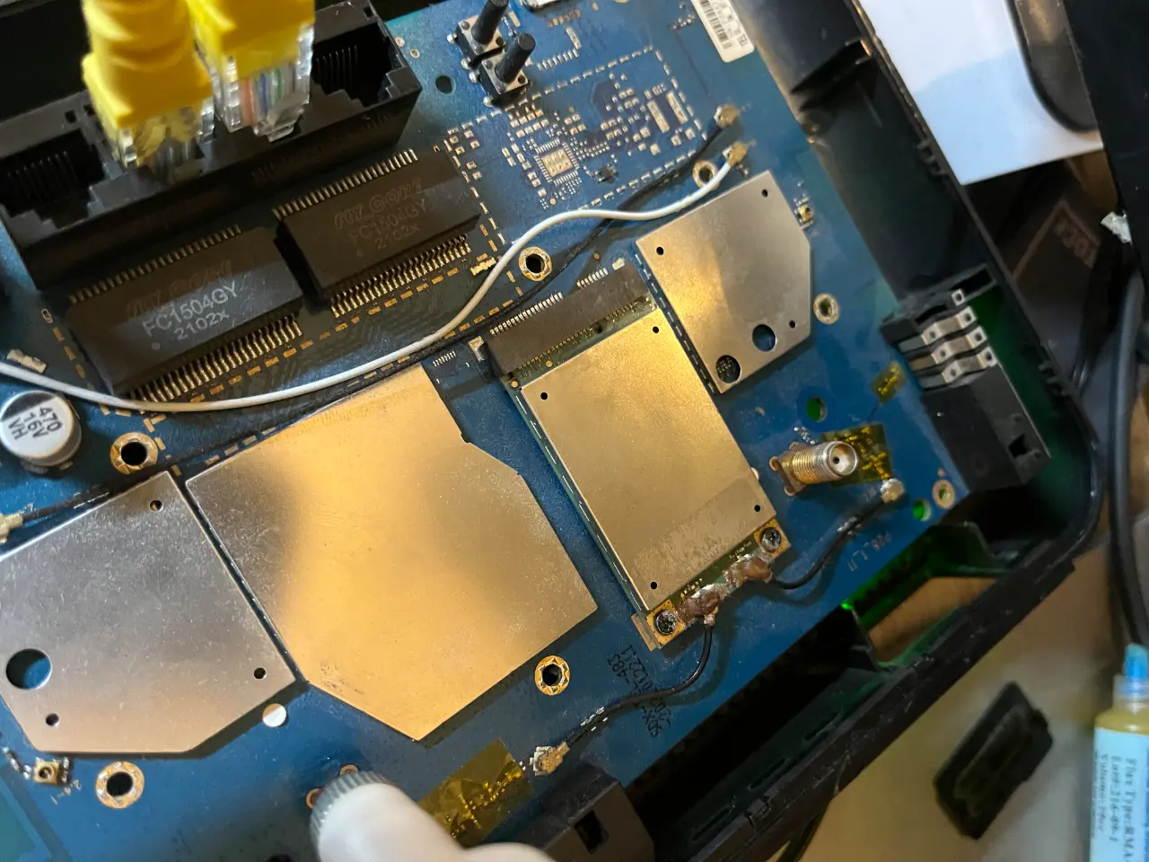

final question i have old hkm281 version. without soldering LTE module. do you think is possible to swap to another higher cat module. without making significant adjustment?
Fibocom L850-GL, Modem lt4220,dw5821e​

so my step is:
1. got ssh access.
2. full backup nand ssh -o KexAlgorithms=+diffie-hellman-group14-sha1 -o HostKeyAlgorithms=+ssh-rsa root@192.168.8.1 "dd if=/dev/mtdblock0" > full_stock_firmware.bin
3. boot initramfs
4. flash sysupgrade, no dhcp after restart for long time.
5. re-boot initramfs, try flash mt7621-sxx-u-boot.img. got error "Failed to get erase block status"
6. try flash without UART with flow hold reset and flash tftfp with firmware: You do not have permission to view the full content of this post. Log in or register now. , got success normal boot.
7. try boot again initramfs
8. flash sysupgrade still stuck, no dhcp for long time.
i mean different CP version. here is my screenshoot when it stockrom.
change the mtdblock to 4 before you flash.
check mtdblock
Code:
fw_printenv
and set mtdblock to 4
Code:
fw_setenv bootargs console=ttyS1,57600n8 root=/dev/mtdblock4
