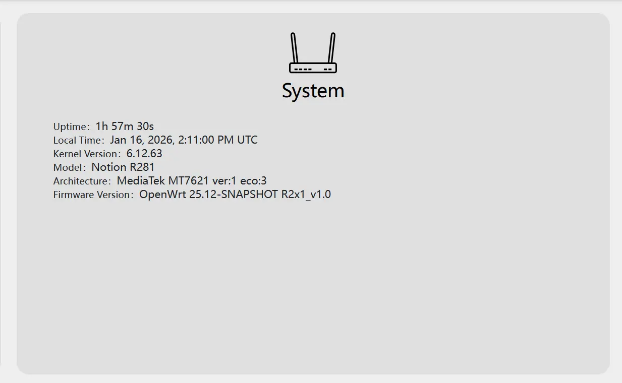

the CP version is different from my first device. will it compatible with "P28M26HAPLDT_CP_R281_V002.3-Mod". ?

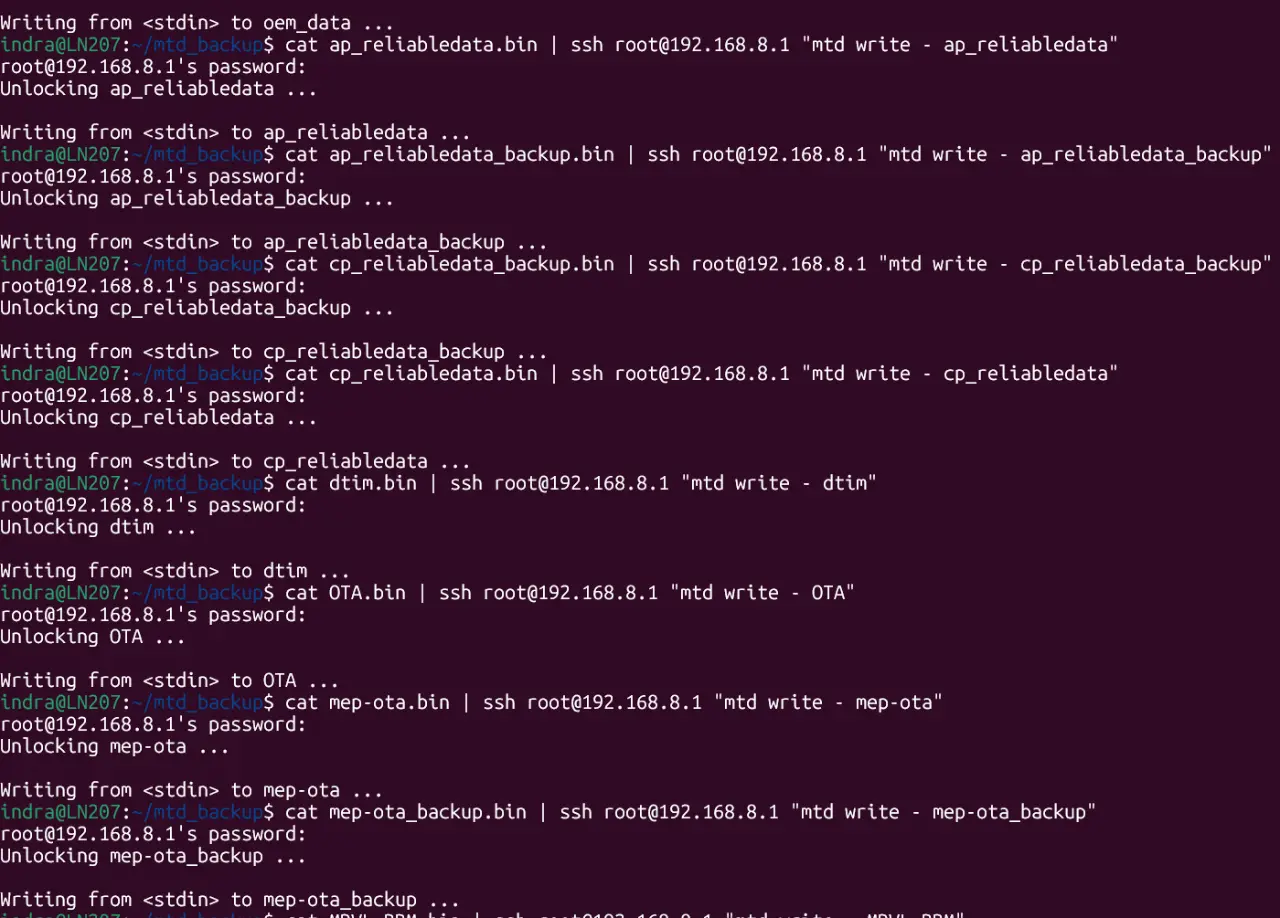

1. flash: P28M26ITelkomsel_HKM281_CP_V003-Mod.bin
2. disable Pipe d success. a minute
3. reboot.
4. access 192.168.8.1 write mtd11. P28M26ITelkomsel_HKM281_CP_V003-Mod.sqf, firstboot, reboot.
5. do system reboot.
6. Pipe e success. wait for a minute do reboot.

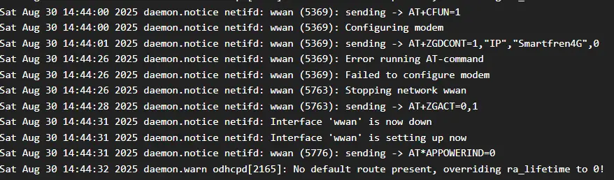

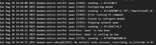

APN is Already set, with same SIM card like first device.
but i see 3ginfo sometime randomly got wrong provider. intermittent connect disconnect.
and when it connect i got same issue, like got local dns and ip 192.168.8.1
after many testing, so i think "P28M26ITelkomsel_HKM281_CP_V003-Mod" not working properly on P28M26ITelkomsel_HKM281_CP_V002
you should used the HKM not the PLDT.
could you help to support that baseband version, sorry bother you again. L E N A R

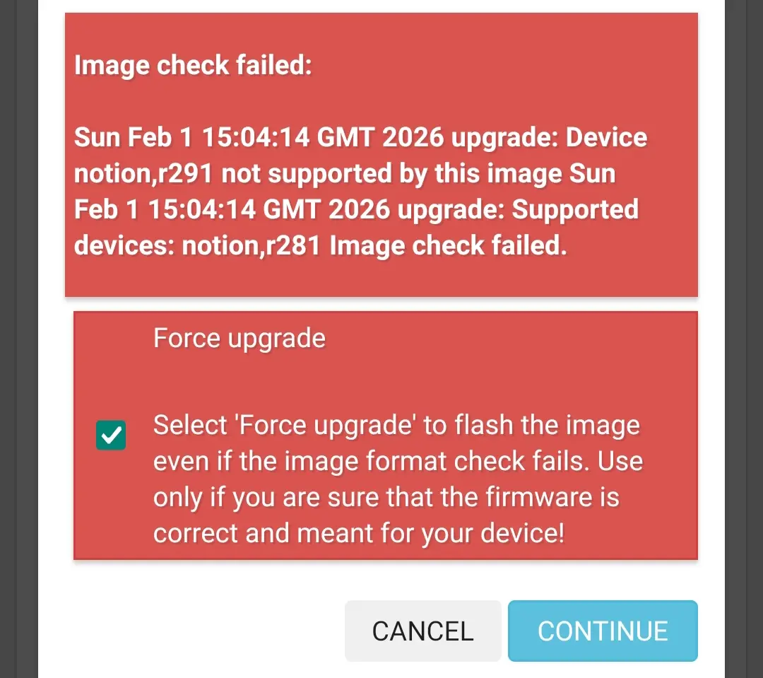

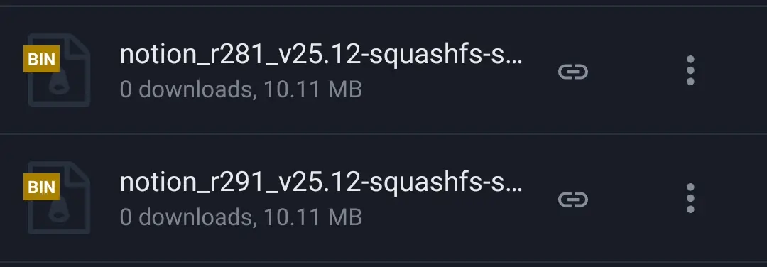

yung pong r291 ko po ginawa ko pong ap router ng globe fiber ko po, ang problema ay naka r281 firmware po nyong openwrt,
gusto ko po sana install yung r291 openwrt kaya lang, yung router ay gamit ng kabilang bahay po
pwede gapo na flash ko gamit yung sa flash image dun mismo sa router, na walang mawawala, walang masisira po pala sa ginawa ko pong settings doon sa router
boss lenar
pano po to
i-reconfigure mo na lang yung settings na ginawa mo.
hindi ko recommended i-retain yung settings pag mag-switch ka ng firmware uncheck mo lang yung "Keep settings"
pag may warning na ganito ignore mo lang parehas lang naman device tree nyan hindi naman yan masisira.

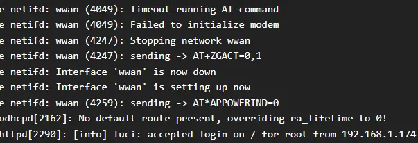

kalako nagana na yung modem nya para sa sim kaya ako nag upgrade from r281 openwrt to r291 openwrt, wala parin pala, di nagana ehh
