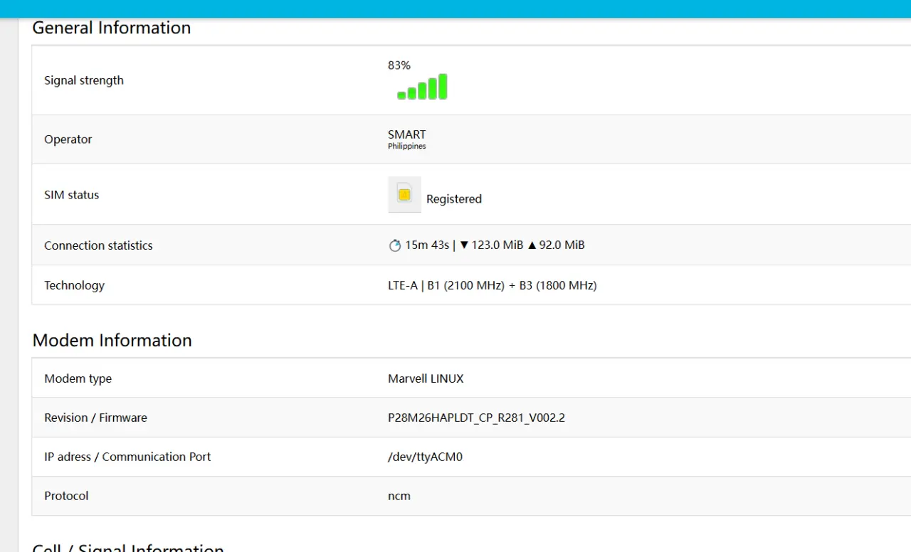

Hello LENAR. I installed OpenWrt R281 on my YOTA C300-1 and
I tried to flash the Modified_FBFDownloader P28M26HAPLDT_CP_R281_V002.3., but I did not remove the SIM card and the process did not complete. Now the modem does not work.

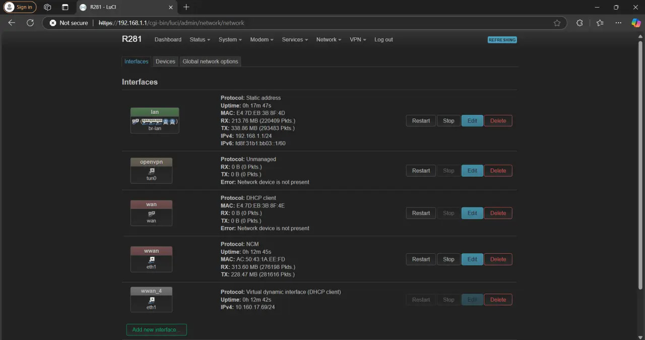

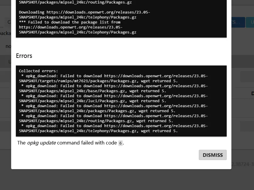

Boss, pano po gawing extender ung openwrt r281 ko?
I followed this pero hnd nagwowork eh. Nag try na rin ako mag install ng luci-proto-relay pero ayaw
