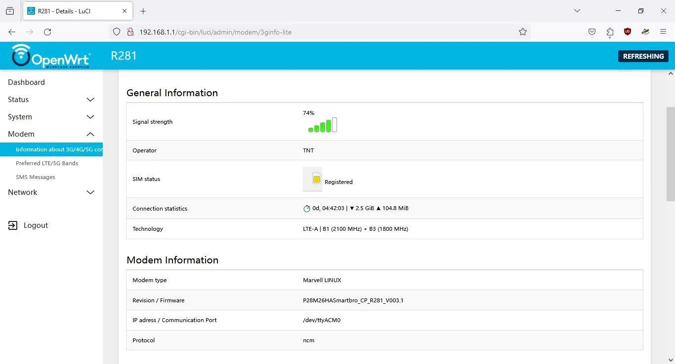

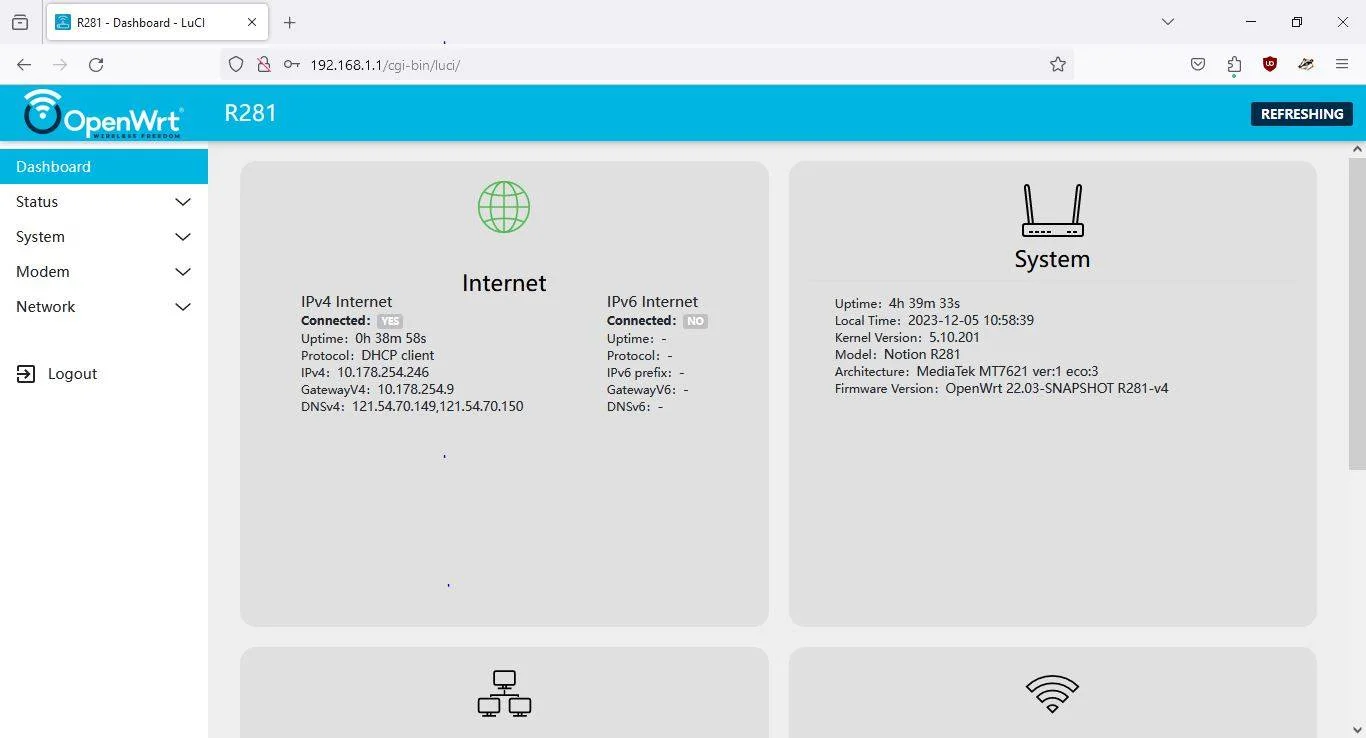

Boosteven R281 (OpenWrt Build)

The 'at+checkatvalid' line of the ncm.json in the initialize section might fail on V002 firmware versions because the checkatvalid is not yet implemented in this version. This might cause the ncm script to not successfully initialize and bring up the mobile network.
Another issue in V002 is that zcainfo does not show sensible values for the secondary band when operating under CA, only for the primary band.
