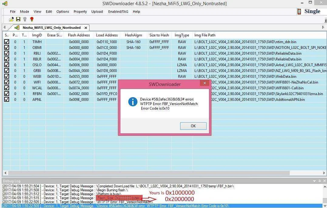

Current firmware of my device is: L02CCameroon1_M023_LCD_V005
I don't know where to check if is stock firmware. But can you post again the link of the firmware that worked for your two L02C devices with a small tutorial step by step?
I haven't gotten mine to work yet.

Is your modem OK?
No... Ï flash L02B succed with this Swdonwload .. Ï think it's firmware.. Please can u upload your firmware ?
Flash the last firmware you burned on that modem.
Select the format option and eject when it says 100% like I described earlier.
