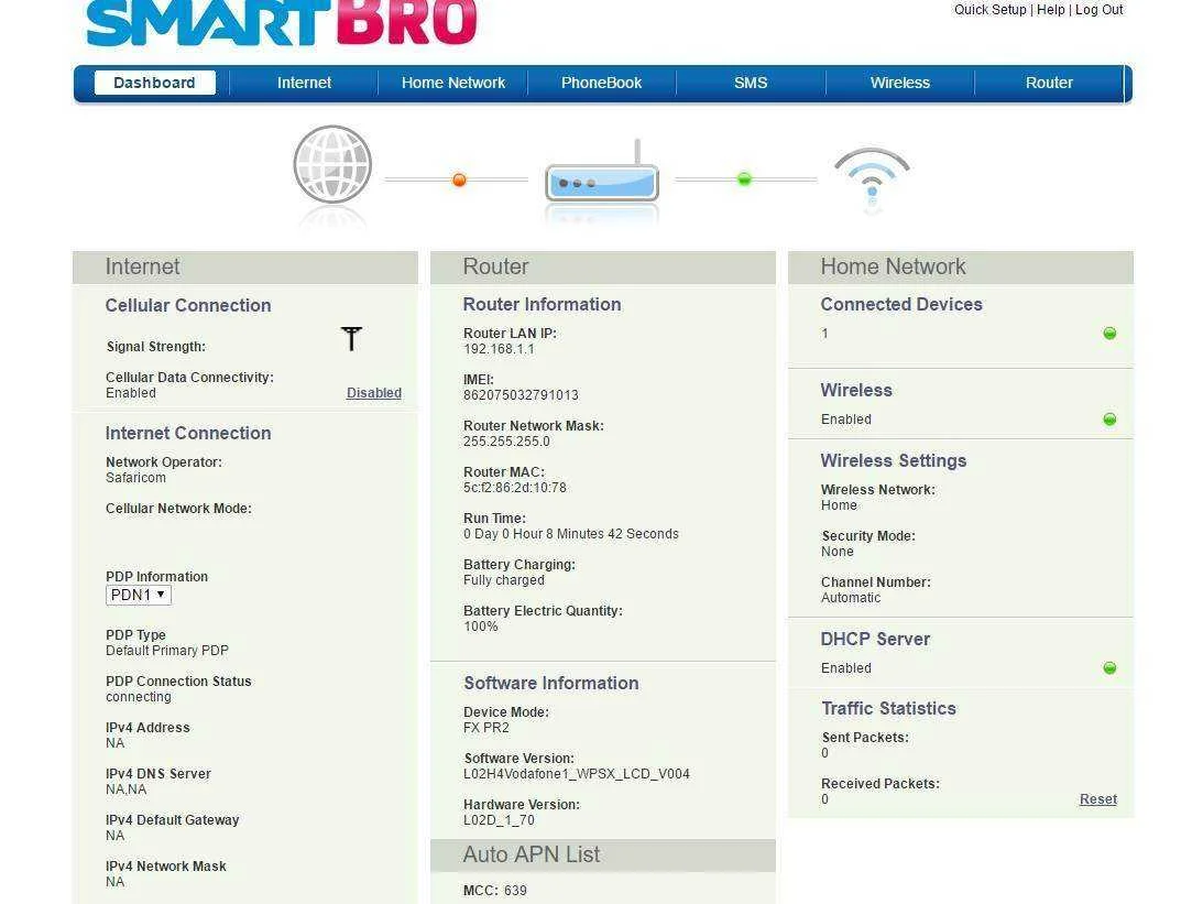

We're talking about the hardware below right?
Mine refuses to find a signal and is stuck at "Searching.." after burning the firmware you shared.
Thanks for working on it though.

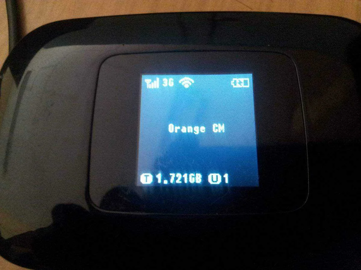

Post a screenshot of the SWDownloader. Yes it is that hardware. i have already flashed two of this.
Proof
Proof
