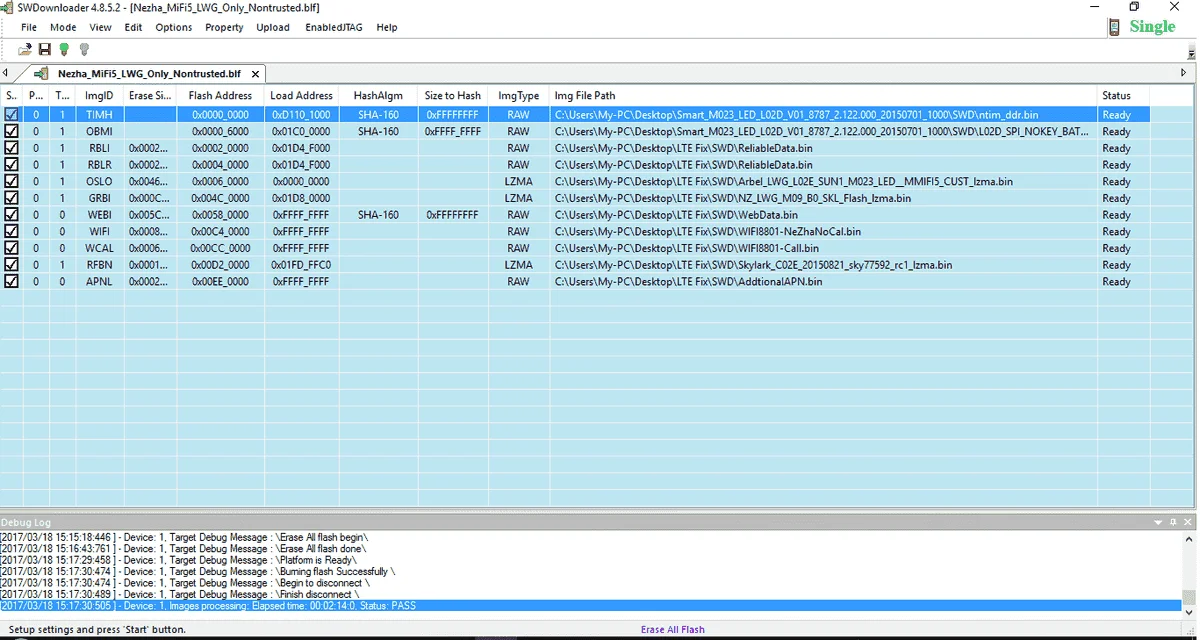

I cannot guarantee you that my description is 100% correct because this are all based on my experience flashing and cross matching different firmware for FX PR2 (M023 LED Type) and M022T (LCD type) which now have an available online firmware you can flash.

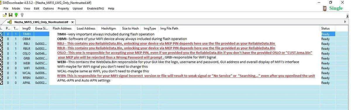

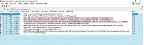

Letters in RED are the necessary files for unlocking your device successfully.boost even3.webp

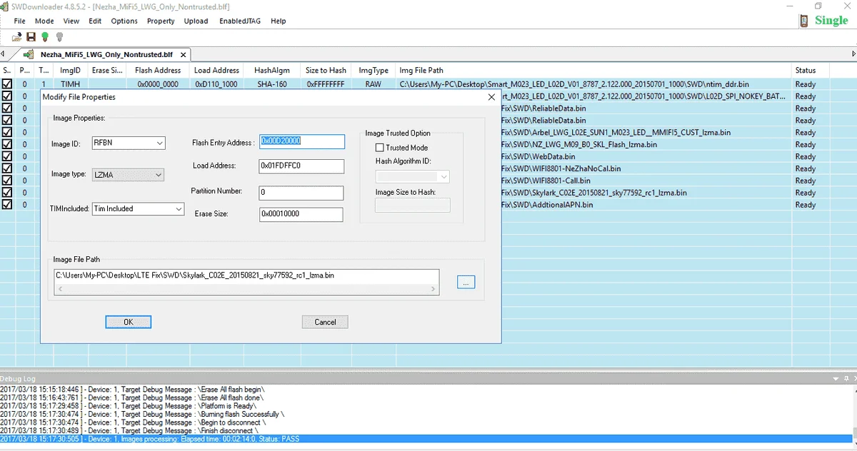

Double click Img File path you wish to change and browse it to your file of choice
then replace the RBLI, RBLR and OSLO (Izma.bin file inside rar file) with this

Thanks for the tutorial kamputs . But I'm having an error replacing the ReliableData.bin file with the one in the LCD link below. It says Error: ImageFileSize is larger than ImageEraseSize, Image: RFBN. Thanks for your time.
Never experienced that before. Just make sure you have LCD firmware, maybe what you downloaded is for LED mifi not so sure but I never experienced that before try closing swd program and start again
