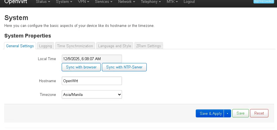

Sa web ui ba muna boss? Nag try ako dun after nun parang never pa lumabas ulit clock haha nasa globe lang. Di ko alam kung dahil ba walang sim pero parang di naman dun. Gano ba ka tagal bago lumabas yung clock? Try ko dun jan sa owrt
na try ko alisin sim and yung oras nya nabalik ng 24 format.

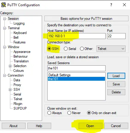

Via SSH (one reboot only)
  1. Change the router password here:
  2. Download and install PuTTY:
  3. Open PuTTY
    Host Name: 192.168.0.1
    Connection Type: SSH
    Then click “Open”.
  4. Login
    Username: root
    Password: your new password
  5. Run the command
    mipc_wan_cli --at_cmd 'AT+EGMR=1,7,"IMEI"'
    or
    qlcom_atcmd AT+EGMR=1,7 "New IMEI#"
  6. Reboot the router to apply the changes.

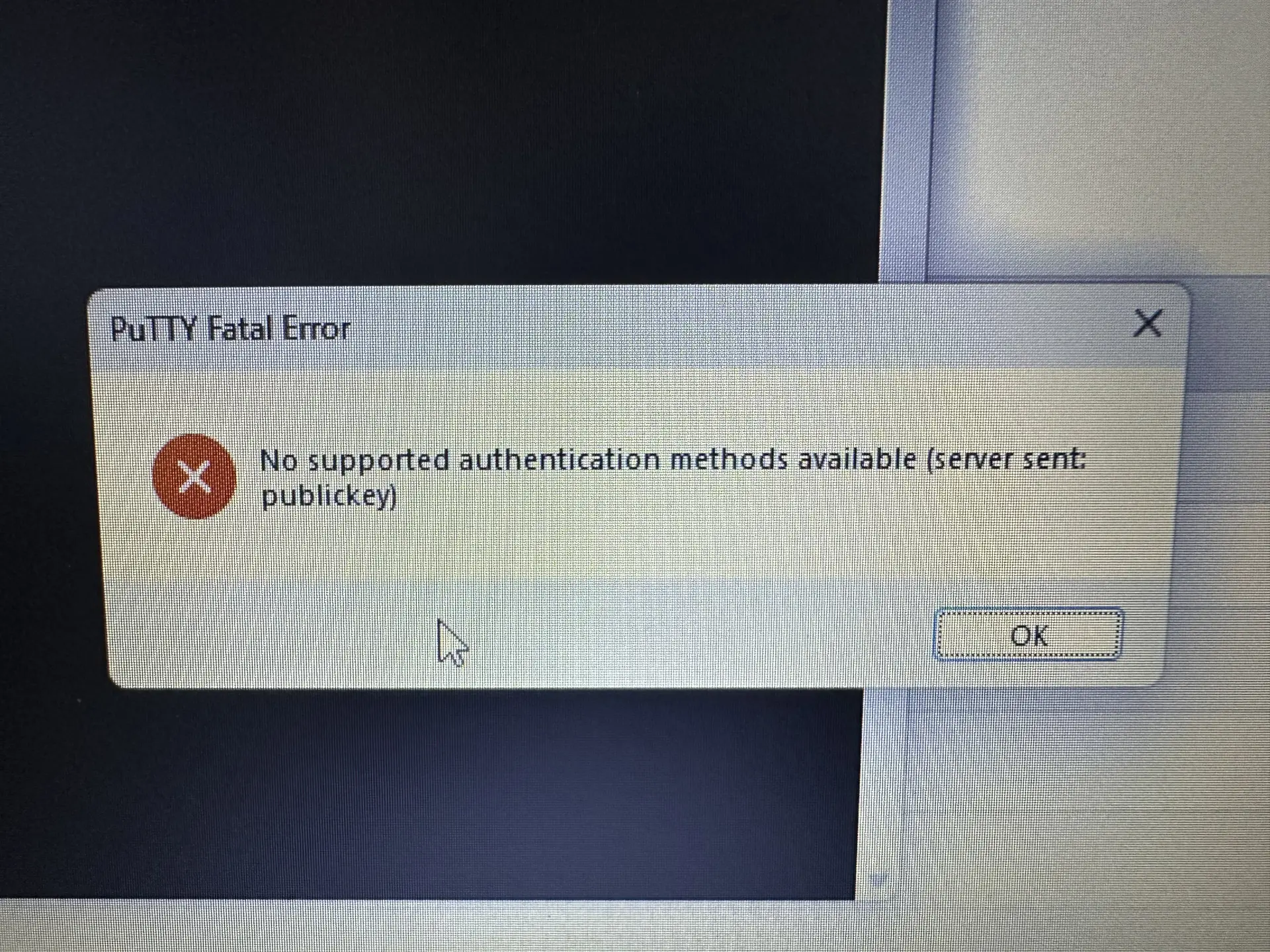

    Can't connect to SSH (bug)?
    Go to:
    Look for dropbear and click Stop, then Start.
mga paps ano gagawin kapag ganito error sa putty
