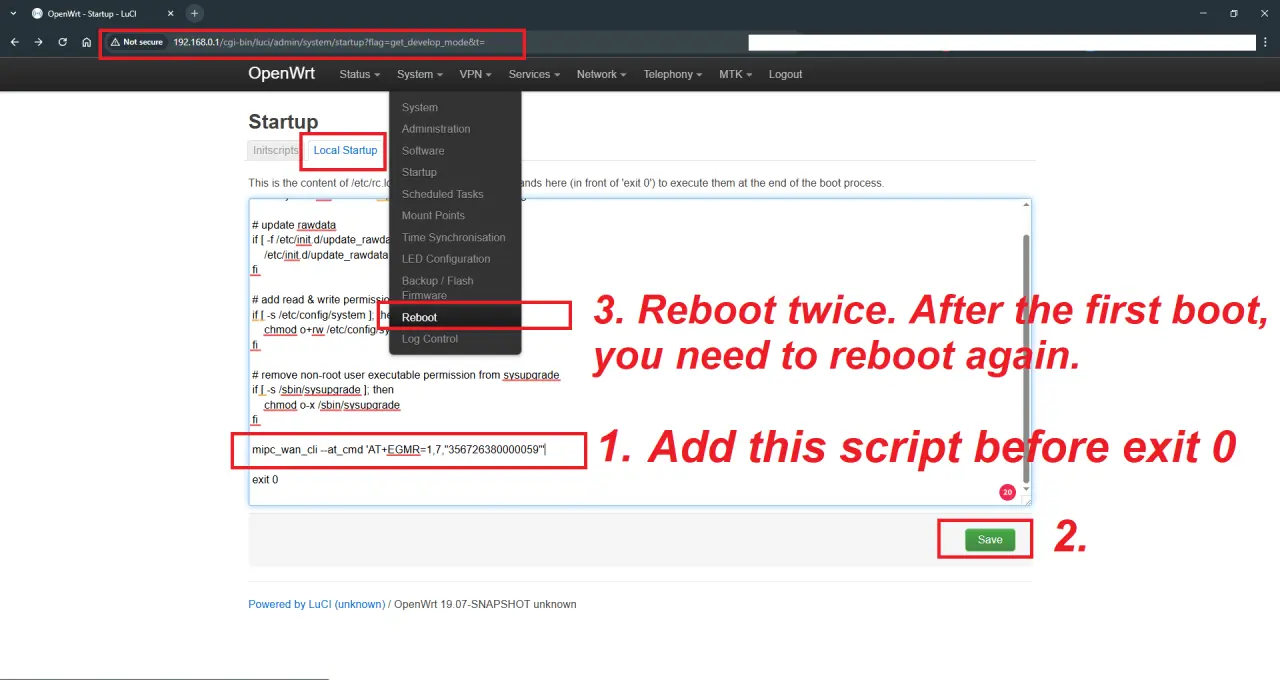

Read this first: Use this script at your own risk; by running it, you accept full responsibility for any consequences, and the author is not responsible for any damage, data loss, or malfunction that may occur to your device or system.
⚠️ IMPORTANT: Back up your own IMEI before proceeding.
⚙️VIA STARTUP CONFIG
  • Access the Startup Configuration: Navigate to the following address in your web browser:
  • Locate Local Startup: Click on the "local startup" option.
  • Add the Script: Insert the following command before the exit 0 line:
    • mipc_wan_cli --at_cmd 'AT+EGMR=1,7,"IMEI"'
  • Save Changes: Click the "save" button.
  • Reboot (Twice): Perform two reboots. A second reboot is required after the first boot sequence is complete.
EXAMPLE NEW IMEI: 356726380000059
mipc_wan_cli --at_cmd 'AT+EGMR=1,7,"356726380000059"'

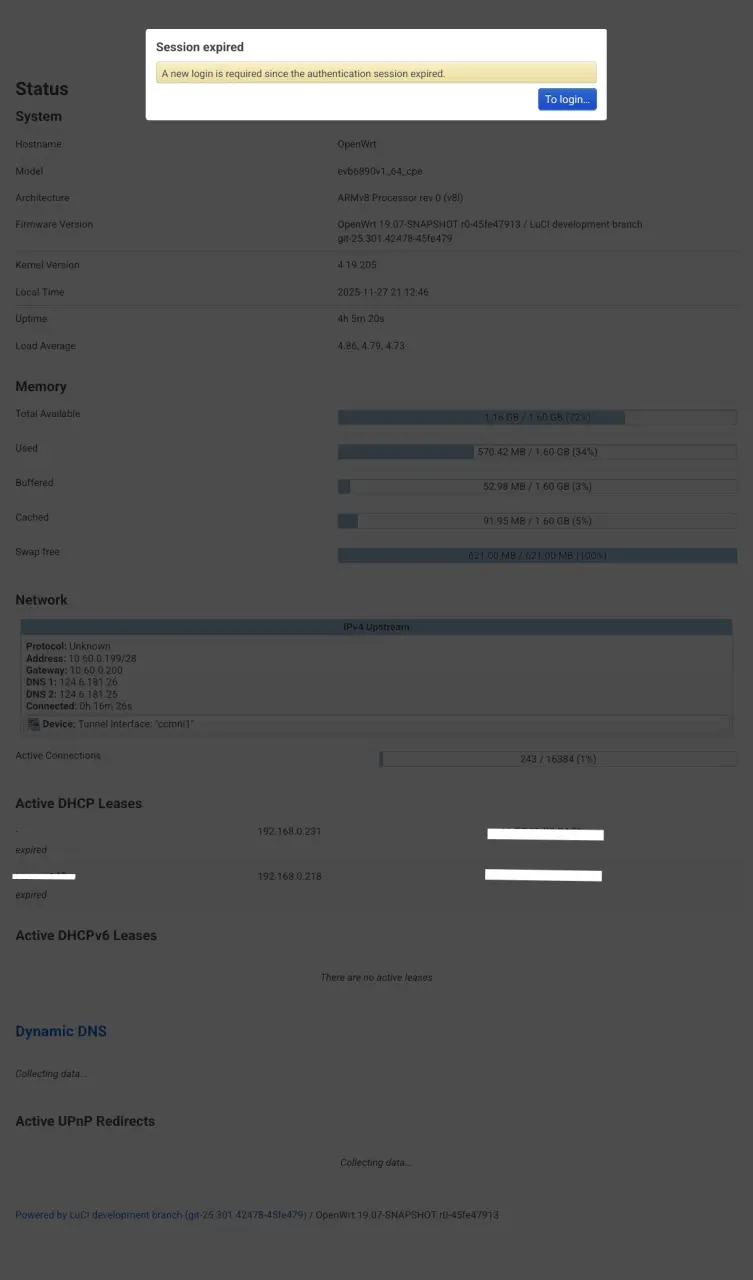

Thanks po sa info pero stuck ako sa session expired. Looping lang sya sa pop-up na yan after applying the latest script.
Expired lagi status sa Actice DHCP Lease kahit nag static na ako ng IP.
login muna sa 101 admin page bago pumunta dyan
Yes sir.
ito mga steps na ginawa ko:
1. Login sa router.
2. Then enter ko ang developer password.
3. Once unlocked, select ko ung OWRT link.
4. Mapupunta ako sa openwrt page then session expired. Pag i-click ko login, same error.
Possible kaya na maturn off yung session timeout kay luci to 0 sa script para di expired yung dhcp lease?
Yes sir.
1. Login sa router.
tampermonkey script need para ma bypass yan. kung di gumana ung script then sorry wala akong bagong version ng router pang test.
