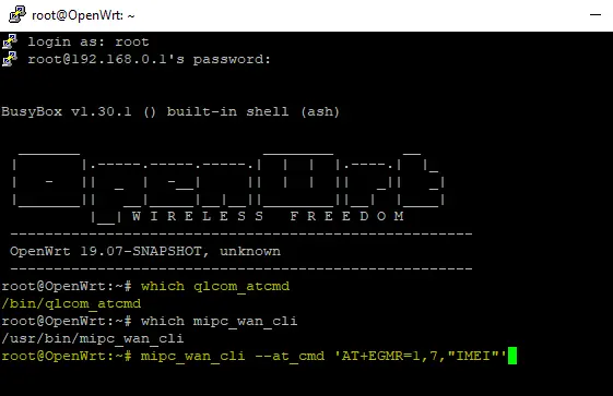

Yes po need mag wait, di ko nalagay, wait nalang mag karoon ng internet bago mag pangalawang reboot para sure na nag run na yung local startup script.
1st boot - run script
2nd boot - apply IMEI
Via SSH (one reboot only)
  1. Change the router password here:
  2. Download and install PuTTY:
  3. Open PuTTY
    Host Name: 192.168.0.1
    Connection Type: SSH
    Then click “Open”.
  4. Login
    Username: root
    Password: your new password
  5. Run the command
    mipc_wan_cli --at_cmd 'AT+EGMR=1,7,"IMEI"'
    or
    qlcom_atcmd AT+EGMR=1,7 "New IMEI#"
  6. Reboot the router to apply the changes.
    Can't connect to SSH (bug)?
    Go to:
    Look for dropbear and click Stop, then Start.

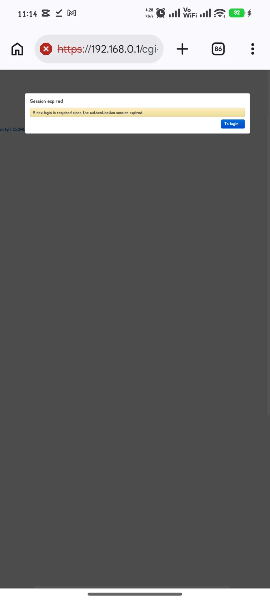

Na ganyan lang akin HAHAHAHA pabalik pabalik
Kita ko lahat ng options pero pag may papalitan
"Parameter sent error!"
Any fix kaya dito? 7.2.02G
Nasubukan ko na http:// lang pati incognito. Thanks!
