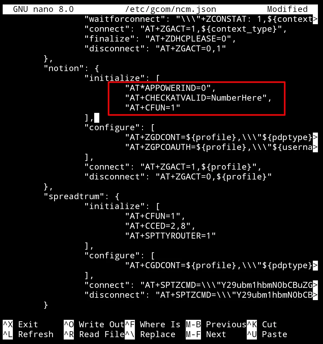

I couldn't catch CHECKATVALID - it was empty
And i can't see command inside your 23.05 firmware
Help me please to run my modem, sir
UPDATE: I got CHECKATVALID!! But could not see that command field inside Custom Commands
you can manually add CHECKATVALID inside /etc/gcom/ncm.json

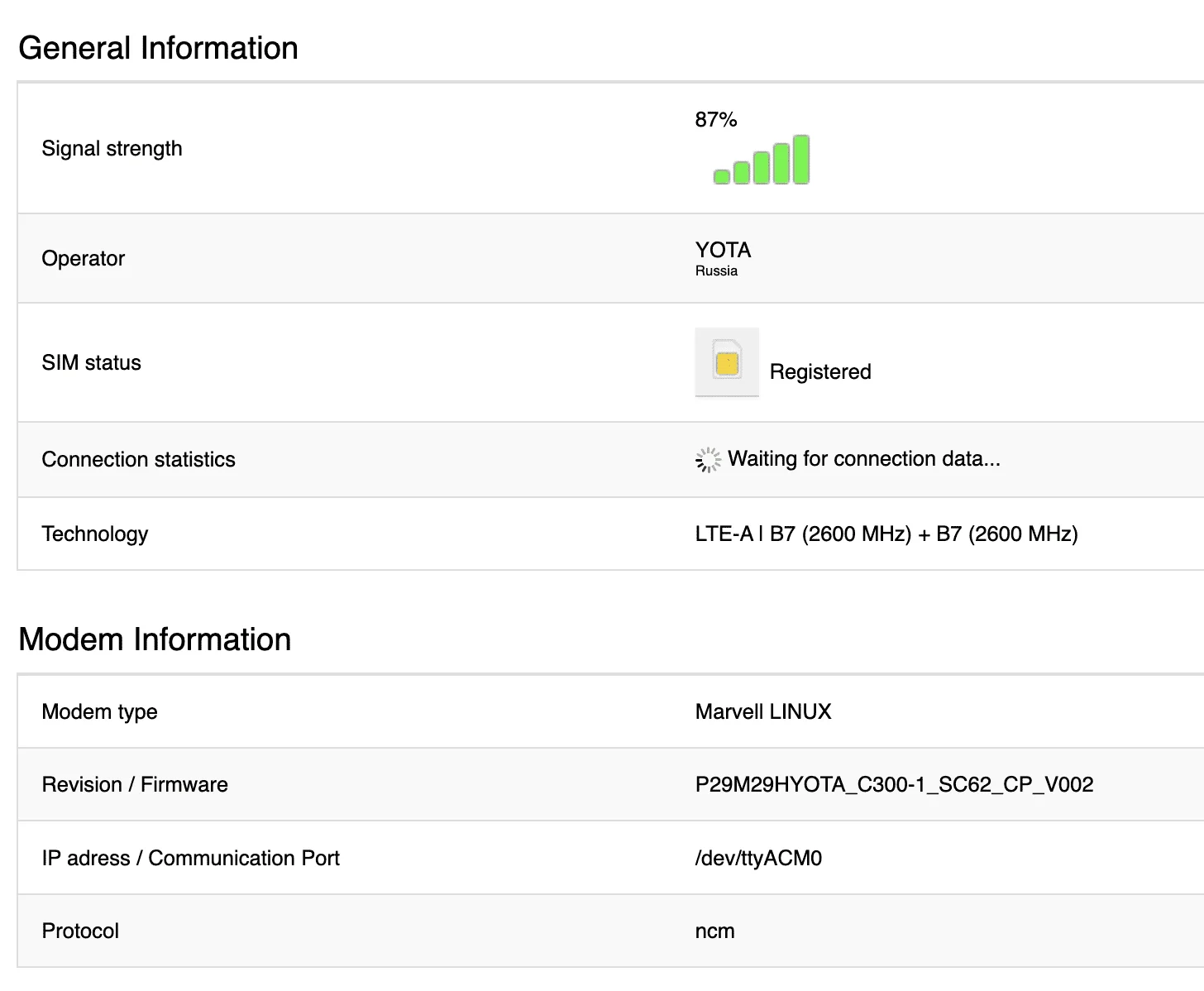

Problem that OpenWrt do not recognize the modem, till i manualy initialize it by AT commands... Only this way... I tried to make different records in JSON file ( Marvel, Asrmicro and edit notion ) - nothing helps, after initialiazed it returns this:
Just updated on yout last 22.03 sysupgrade - saw your changes! Thank you, master! Modem works!

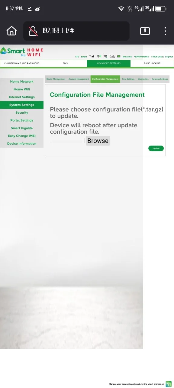

Hello po, sana mabuhay ulit ang convo dito. ask lang po sana ako kung paano po i flash yung modded cp firmware at ano po yung fbf downloader. gusto ko po sana matuto pano gawin, marami din naman ako natutunan kakabasa ng convo dito. nakapagflash ako ng r281 openwrt pero dun lang sa sirang module na r281 ko naflash. ginawa ko nalang AP yun sira kong r281 sa work ko, naka NAT kase network dito. need ng specific IP para makapag internet. Please po pa help naman dyan. Thank you in Advance!
BTW. thankyou nga pala sir LENAR at nagkaroon ng silbi itong sira kong r281 hahaha
yung mga file sa Modified_FBFDownloader_File ay pwede mong gamitin sa pag ayus ng nasirang module dahil sa pag flash.
