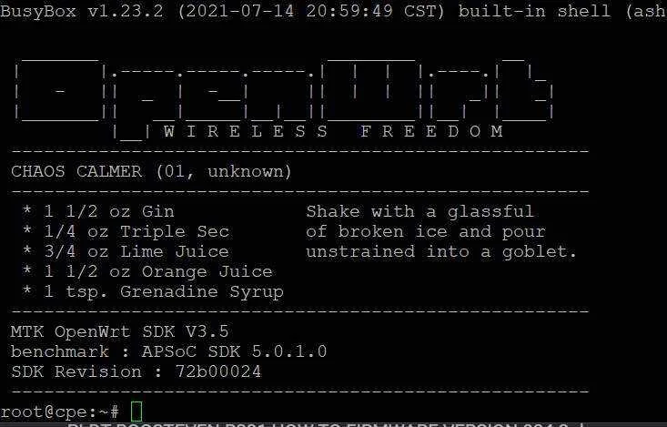

Mukhang ma-a update pa rin ang firmware nito. Parang na disable ko na dati yung sa services.init tapos pati tr069 and ota. Nag update pa din to 4.1 yung modem ko. Nakapagtataka talaga, ang duda ko baka ang nag co-control ng update ay yung nasa rom/etc/config/tr069. Ito ang nasa loob ng tr069 nung before nag update:
option tr069_enable '1'
option dimcomplete '0'
option boot_state '0'
option acs_mreboot '0'
option conn_name 'roy'
option conn_psw 'roy'
option acs_url 'You do not have permission to view the full content of this post. Log in or register now.'
option acs_username 'notion'
option acs_password 'notion'
option inform_enable '1'
option inform_interval '300'
option manufacturer 'Mavell'
option model 'L20_1826_p704'
option oui '123456'
Ito naman yung sa rom/etc/config/ota:
config ota-mode ota_mode
option type 2
option size 0
option url '/tmp/pxa1826.img'
Ang problema dahil nasa loob ng rom directory di siya ma edit.
Not sure kung tama ba ako pero baka makatulong.

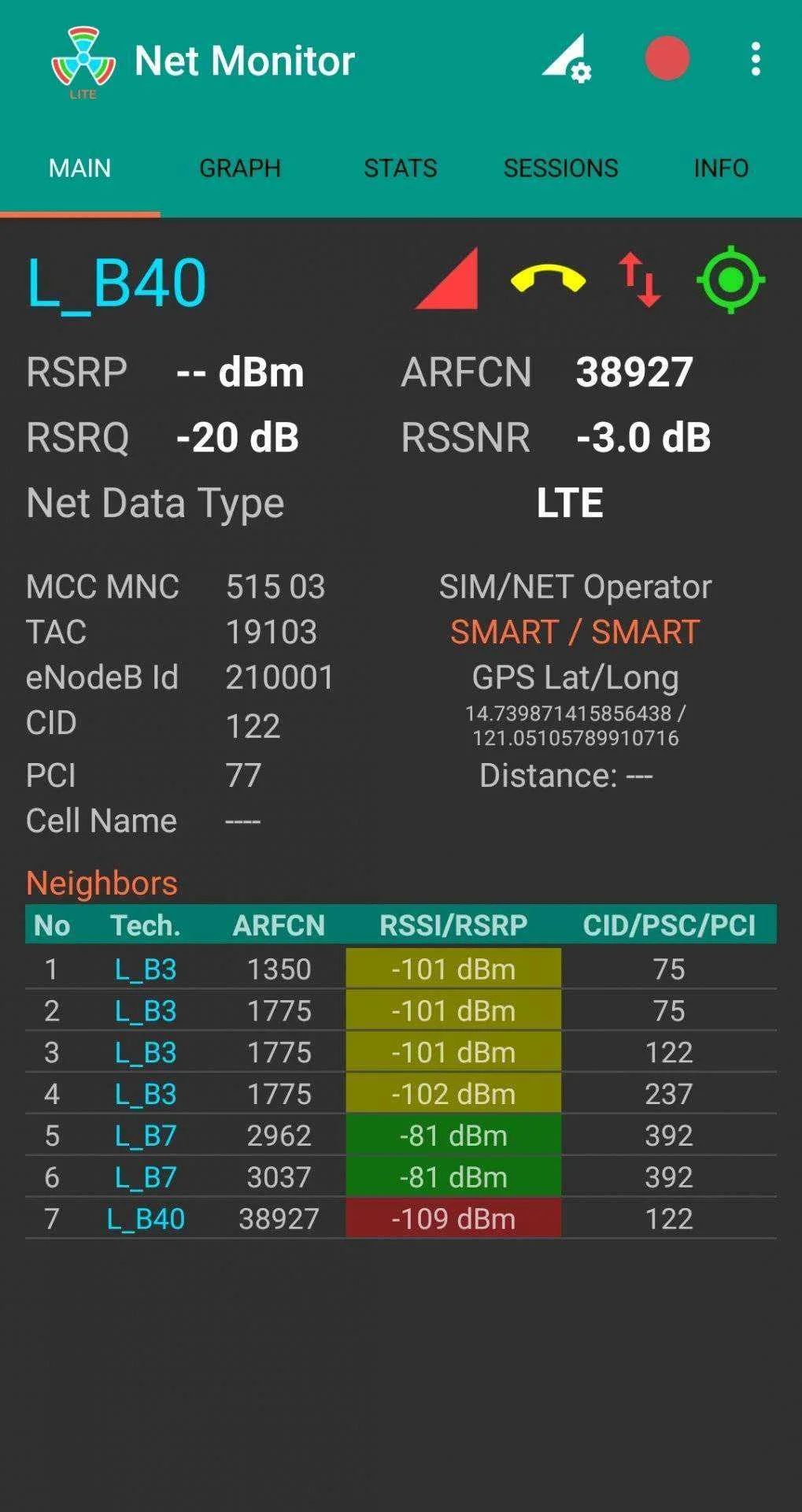

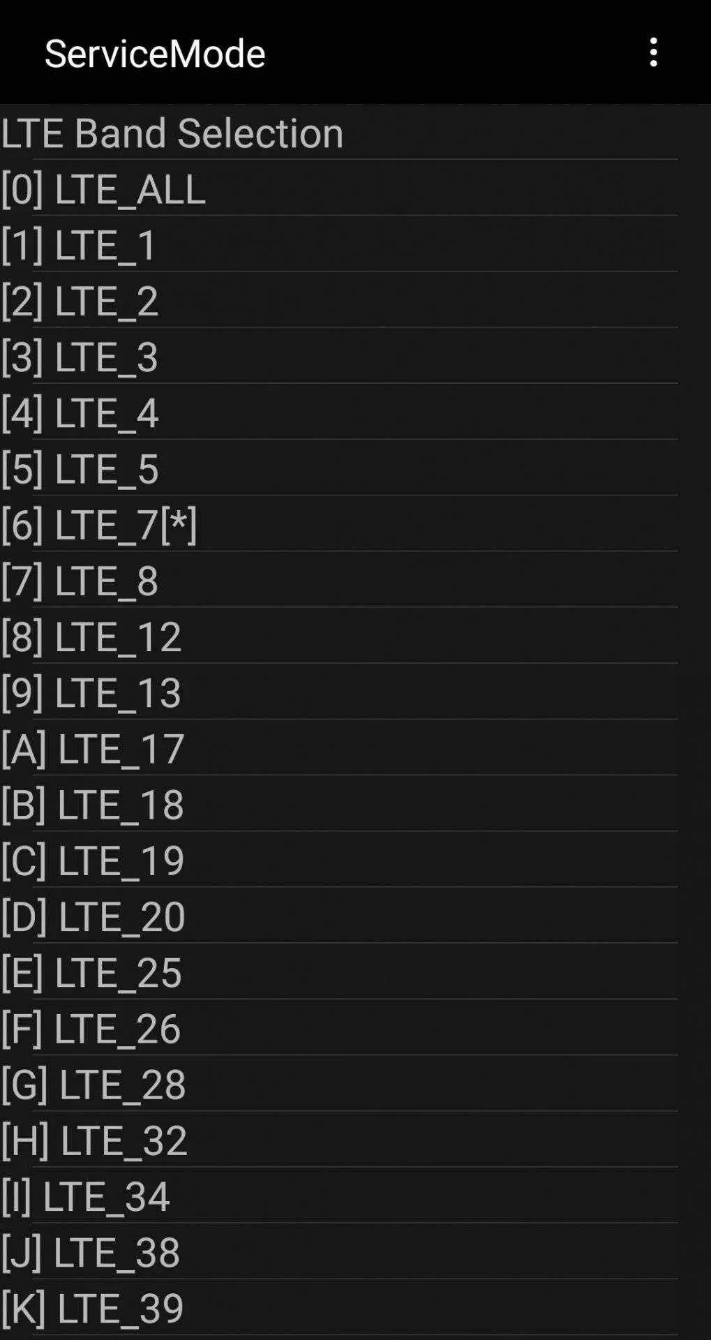

List of AT+ZNLOCKBAND that I have tried so far. I will try other Band combination soon.

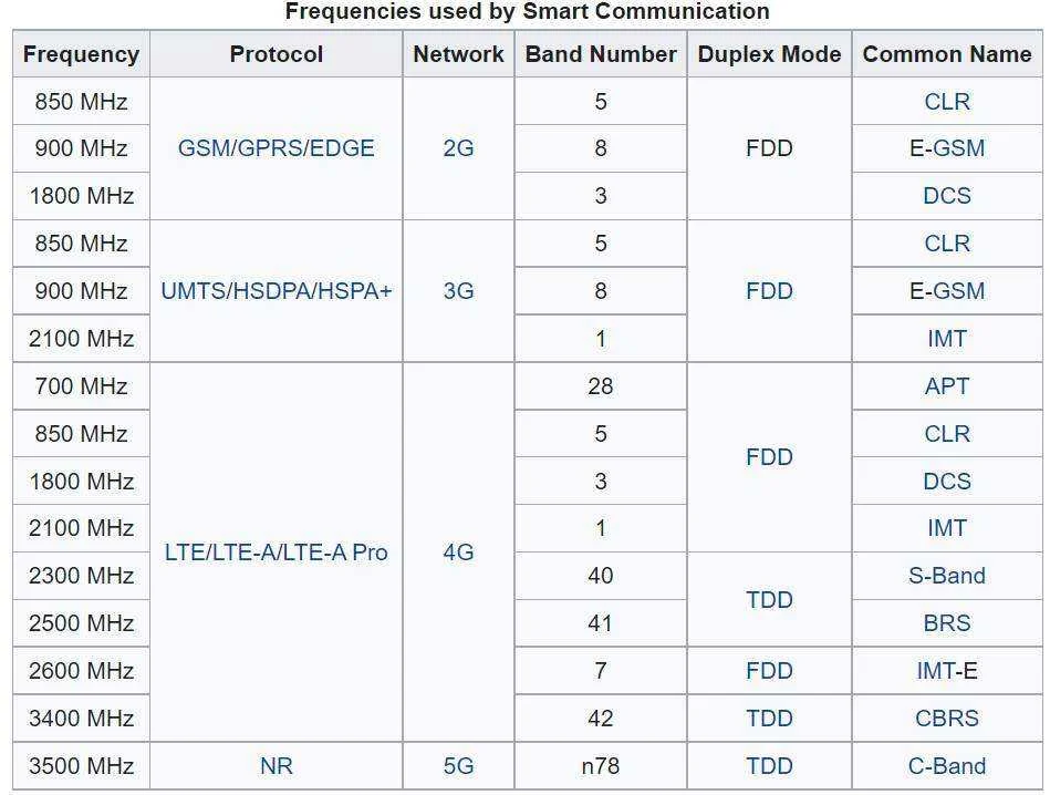

lods may band 41 at band 3 po ba?
