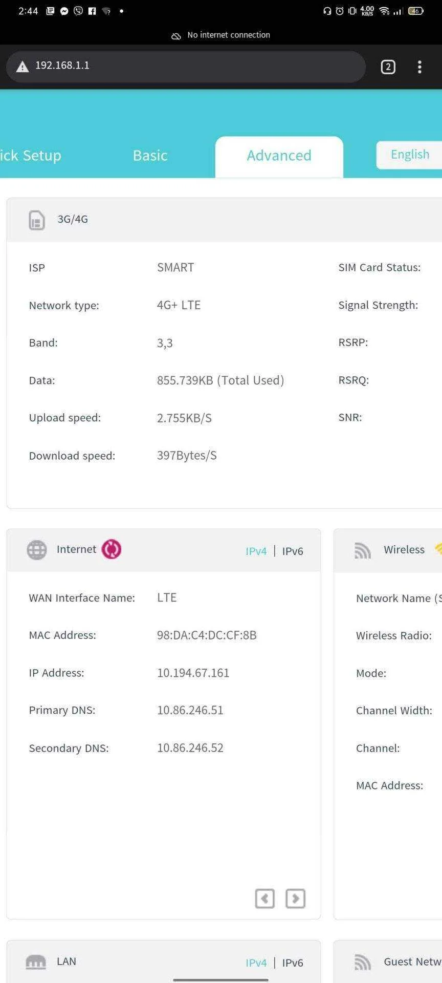

Yung r281 ata yung problema , naka 3,3 ako sa tplink ko ehh
may cell id locking ba yan paps? or kahit band selection? parang mas maganda sa mamba wala lang telephone port
Meron syang bandlocking , dalawa kasi version nya isang v1 isang v2, yung v1 need mo pa iflash yung beta firmware na galing din tplink , yung v2 naman automatic may band locking.
ganito interface ng tplinkScreenshot_2021-09-06-14-44-02-55_40deb401b9ffe8e1df2f1cc5ba480b12.webp
