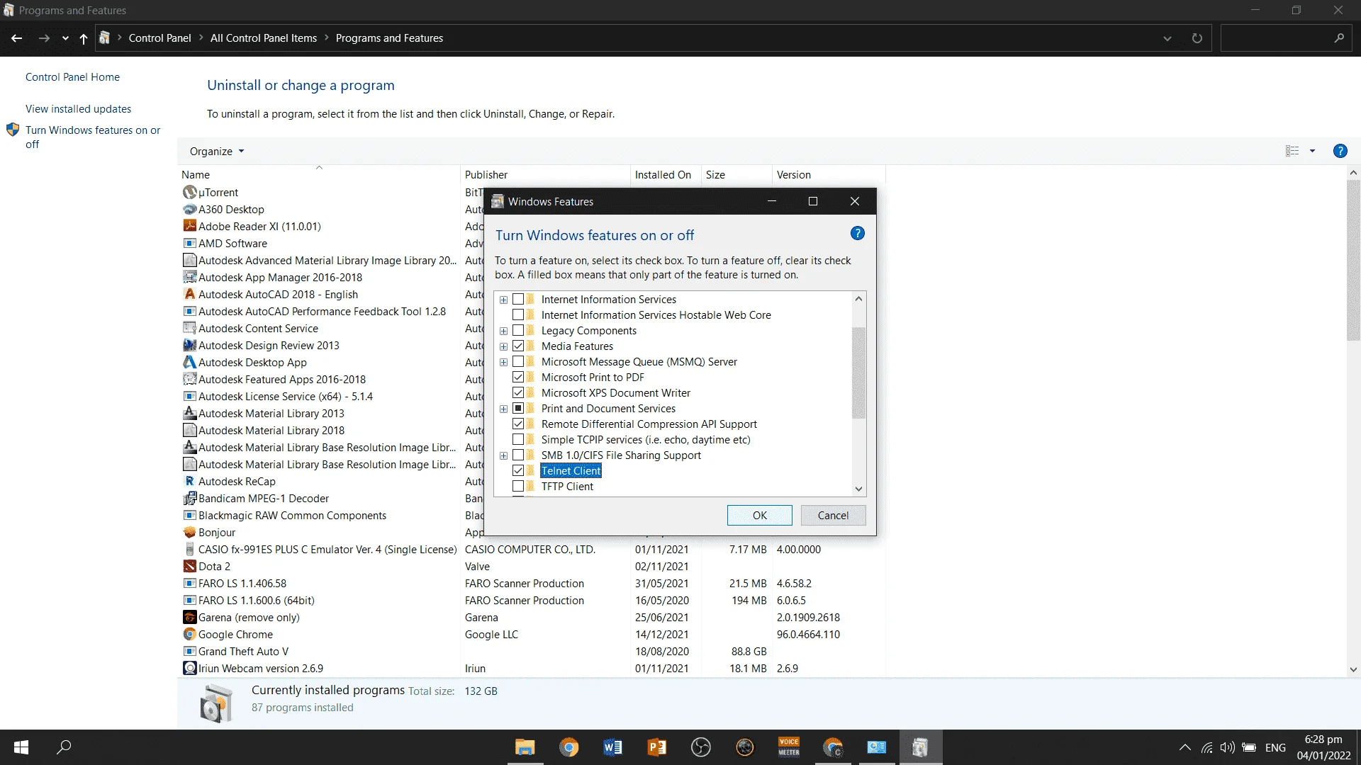

enabled na telnet client ko boss
ano po first command mga boss? "telnet 192.168.1.1" po ba?

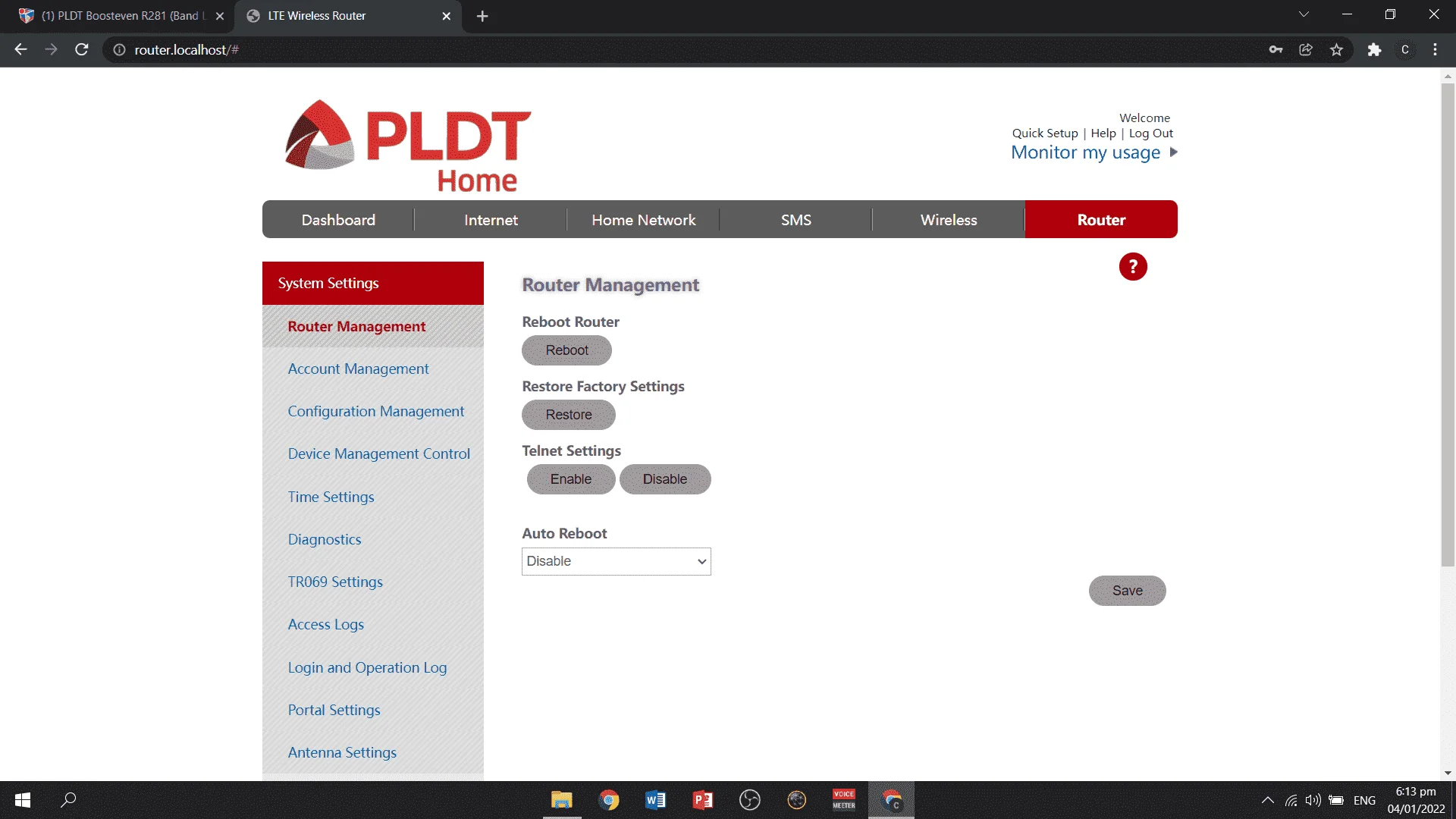

Sa pc mo gawin lods yung telnet enabled, para mabilis
Download nginx.zip sa page 1
Then extract using 7zip winzip rar
Run nginx.exe
Auto minimized yan
Run Mo yung nginx.exe tapos open browser, type mo router.localhost press enter or router.localhost:8080/index.html#
Login use your username and password
then search ung Enable telnet yumg nasa image
Run nginx.exe
Auto minimized yan

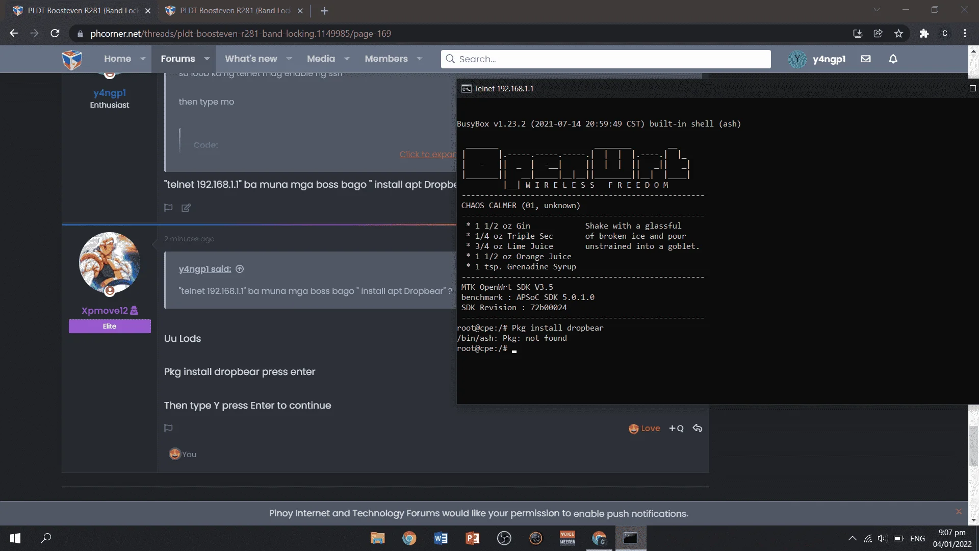

Xpmove12 pano po boss mag enabled ssh using cmd?
kahit sino po marunong dito enable ssh using cmd?
sa loob ka ng telnet mag enable ng ssh
then type mo
Code:
ubus call router set_dropbear_info '{"dropbear_mode":"1","dropbear_key_type":"99"}'
then change your password.
Code:
passwd
to make your password permanent:
Code:
fw_setenv dropbear_password your created pw
"telnet 192.168.1.1" ba muna mga boss bago " install apt Dropbear" ?
