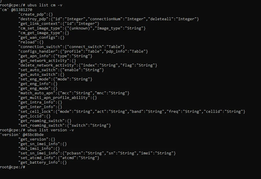

Sa pc mo gawin lods yung telnet enabled, para mabilis
Download nginx.zip sa page 1
Then extract using 7zip winzip rar
Run nginx.exe
Auto minimized yan
Run Mo yung nginx.exe tapos open browser, type mo router.localhost press enter or router.localhost:8080/index.html#
Login use your username and password
then search ung Enable telnet yumg nasa image
Ok na sir.yung openline process nalang using remote

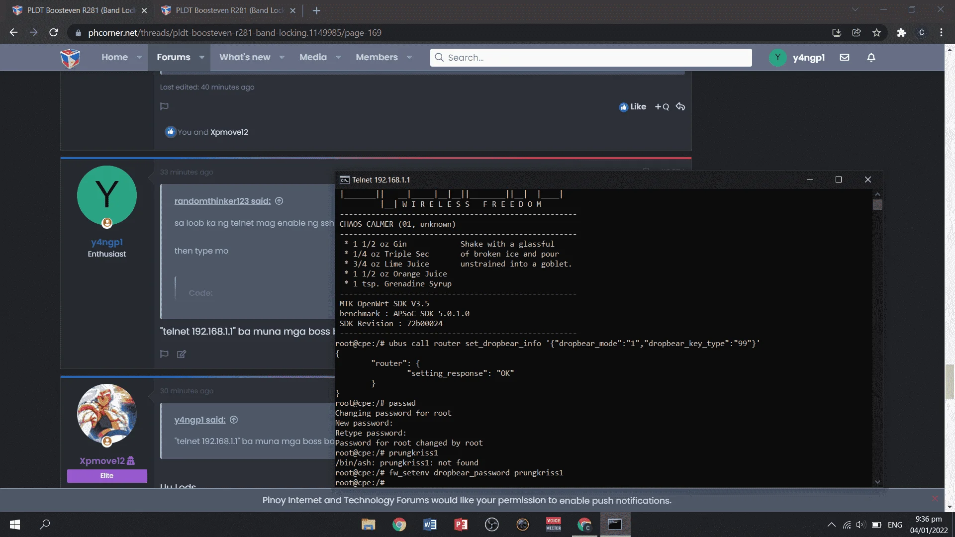

sa loob po kac ng telnet kayo nag iinstall. wag kayo jan sa loob ng telent mag install ng dropbear
Pano ba dapat? Nakakalito kc. San ba dapat mag install ng dropbear?
sa termux kac yang command na pkg install dropbear.
So enable ssh po muna using sa commands na provided dito
Maraming salamat po mas naintindihan ko explanation mo.
