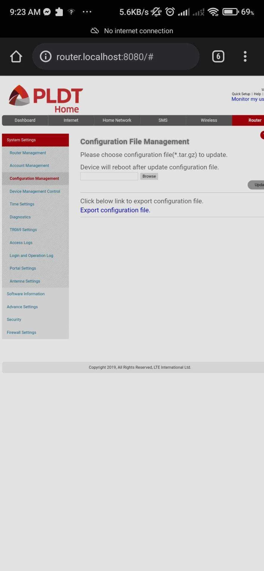

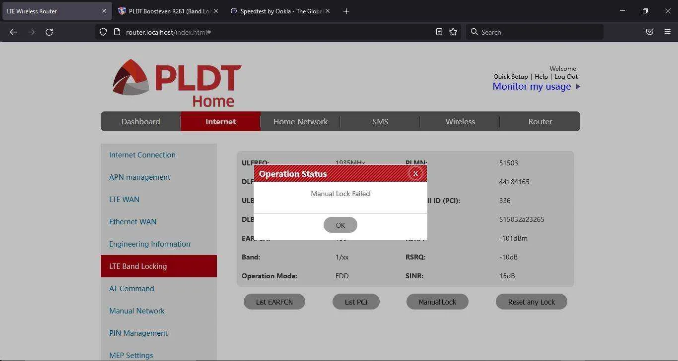

ung walang 8080 po lumabas n dashboard pero failed padin po ung locking at manual locking
na try q n po both router.localhost at ung may 8080. pumasok n po sa browser kaso po sa locking failed padin po.

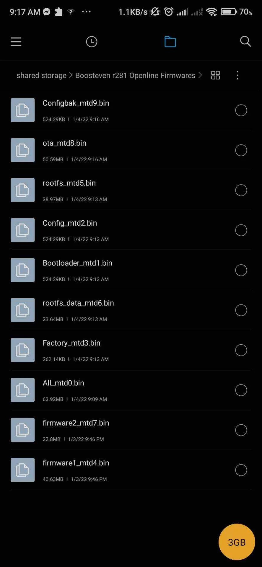

firmware 1 and 2 yung hinugot ko
lods, ano pong firmware ang pinaflash para ma openline yung r281? nakuha ko na kac yung 2 firmwares. openline na kac yung akin. willing din akong iupload dito para magamit din ng iba.. pero do it at your own risk, hehe.
Lodd, Hugot din mtd5 anjan ung rootfs kernel
Saka ung mtd1, anjan mep pin codes etc..., saka ung config, ano mtd na un
nahugot ko na lahat
pero pano natin to gagamitin? hahhah

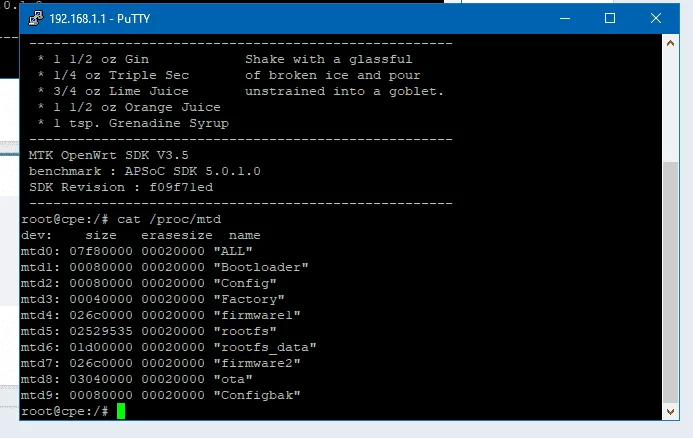

Eto lang yun Lods, ilagay mo sa tmp folder ung gusto mo I flash
Eto na yung sample commands, Bro sa putty or ssh or termux pwede gawin
Directory command show mtd
cat /proc/mtd mo muna.
copy mtd7 to tmp folder
cat /dev/mtd7 > /tmp/firmware.bin
Kapag natapos,
Command in flashing firmware 2 mtd7
mtd -r write /tmp/firmware.bin /dev/mtd4
Downgrade ang ginawa dito, Lods
