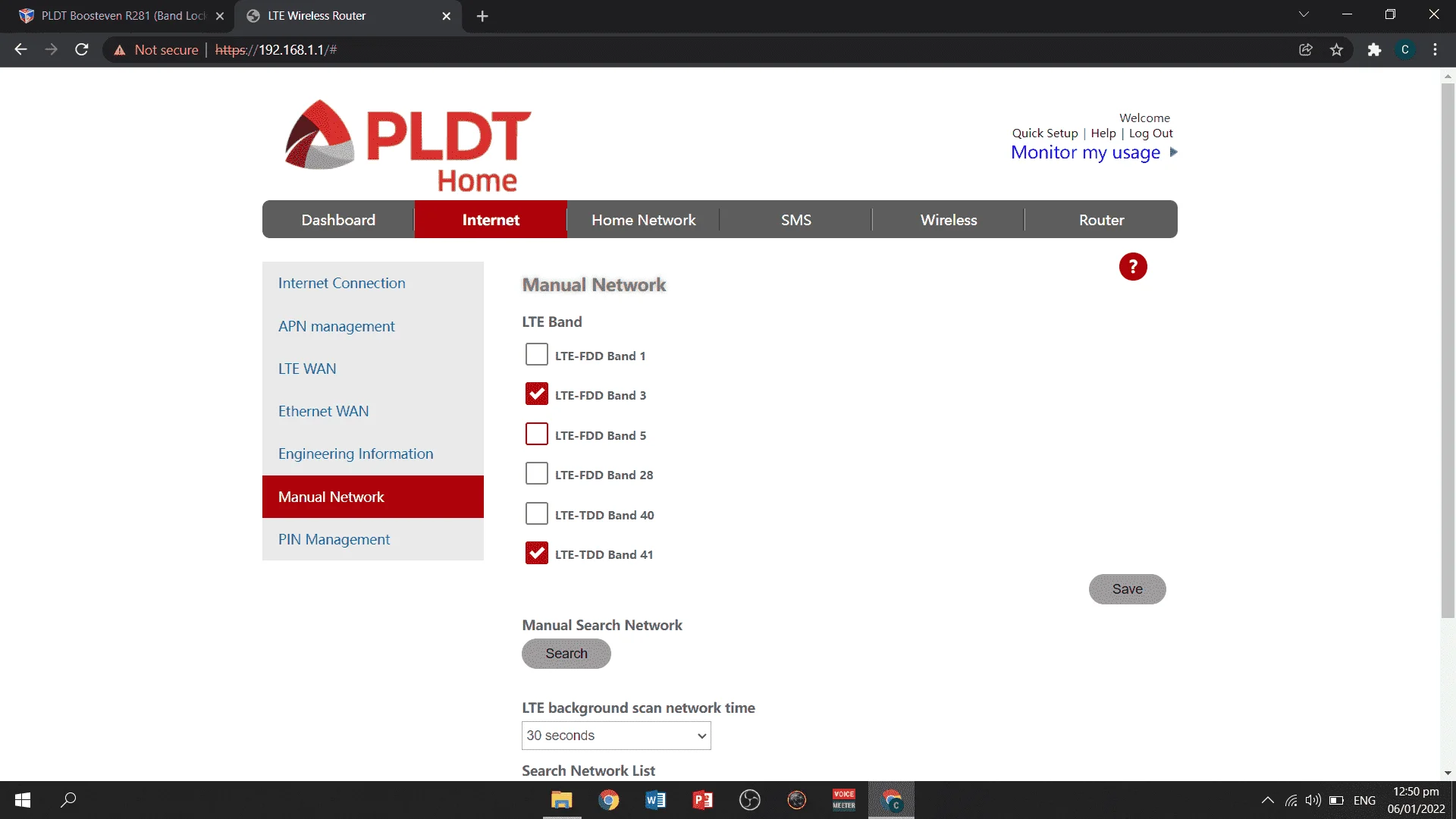

Eto lang muna.
Easy band locking via web interface.
Download You do not have permission to view the full content of this post. Log in or register now.
Then iupload sa router gamit AndFtp.
Watch video for steps.
Paalala lang:
Dapat enabled na ssh ng router mo at alam mo password nito.

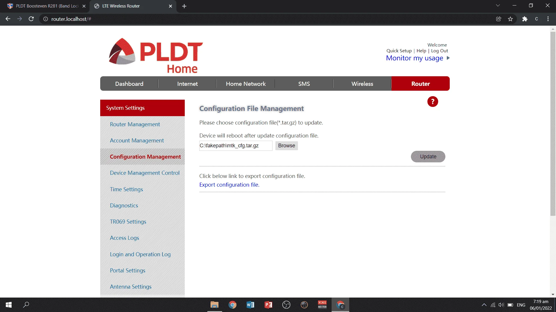

extract ba muna tong file na to boss?
Screenshot (399).pngtama ba mga boss?
Pano po sa windows ?
View attachment 1778165tama ba mga boss?
No need na ung temporary block updates, upload yan sa dashboard menu, hanapin upload configs
Yung easy bandlocking dapat enabled na telnet at ssh r281 mo follow video tutorials Lods zxshiels page 146, andun na din command na gagamitin
Dapat malagay mo sa tmp folder ung You do not have permission to view the full content of this post. Log in or register now. gamit ang andftp, winscp etc.. para mapasok mo sa r281

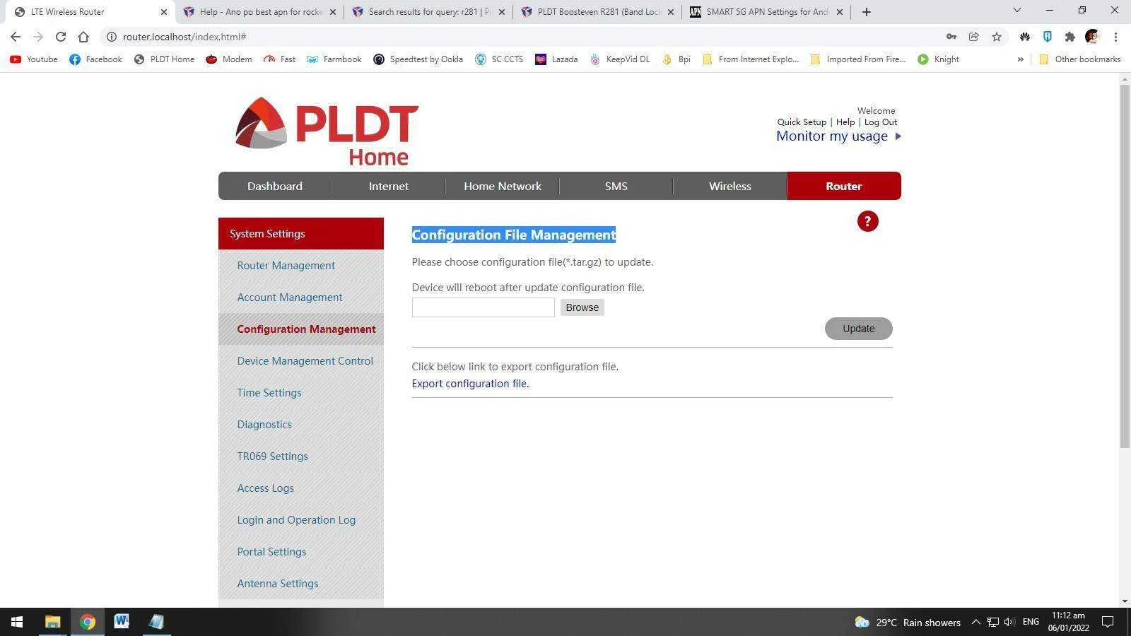

FREE naman ito pwede openline agad pag nagawa nyo ang step na ito at nabuksan Configuration File Management upload ito You do not have permission to view the full content of this post. Log in or register now.View attachment 1778357

Eto lang muna.
Paalala lang:
