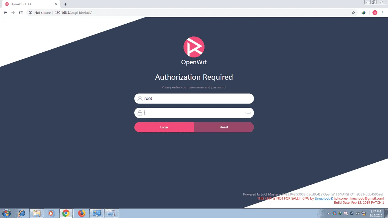

Cfw openwrt request_releases:(openvpn for 4mb routers)
medyo not newbie friendly flashing procedure jan. via tftp lang para maka-pag flash dyan. i wont suggest that tftp flashing if you lack basic knowledge on tftp flashing or linux terminal command.
yon lang, pero nakapag flash na ko using TFTP...nabrick ko kc itong TP Link ko, flash ko lang sya thru TFTP naibalik ko din. pero indi kna uulitin baka mapalpak weeew goodbye router...hehehe!

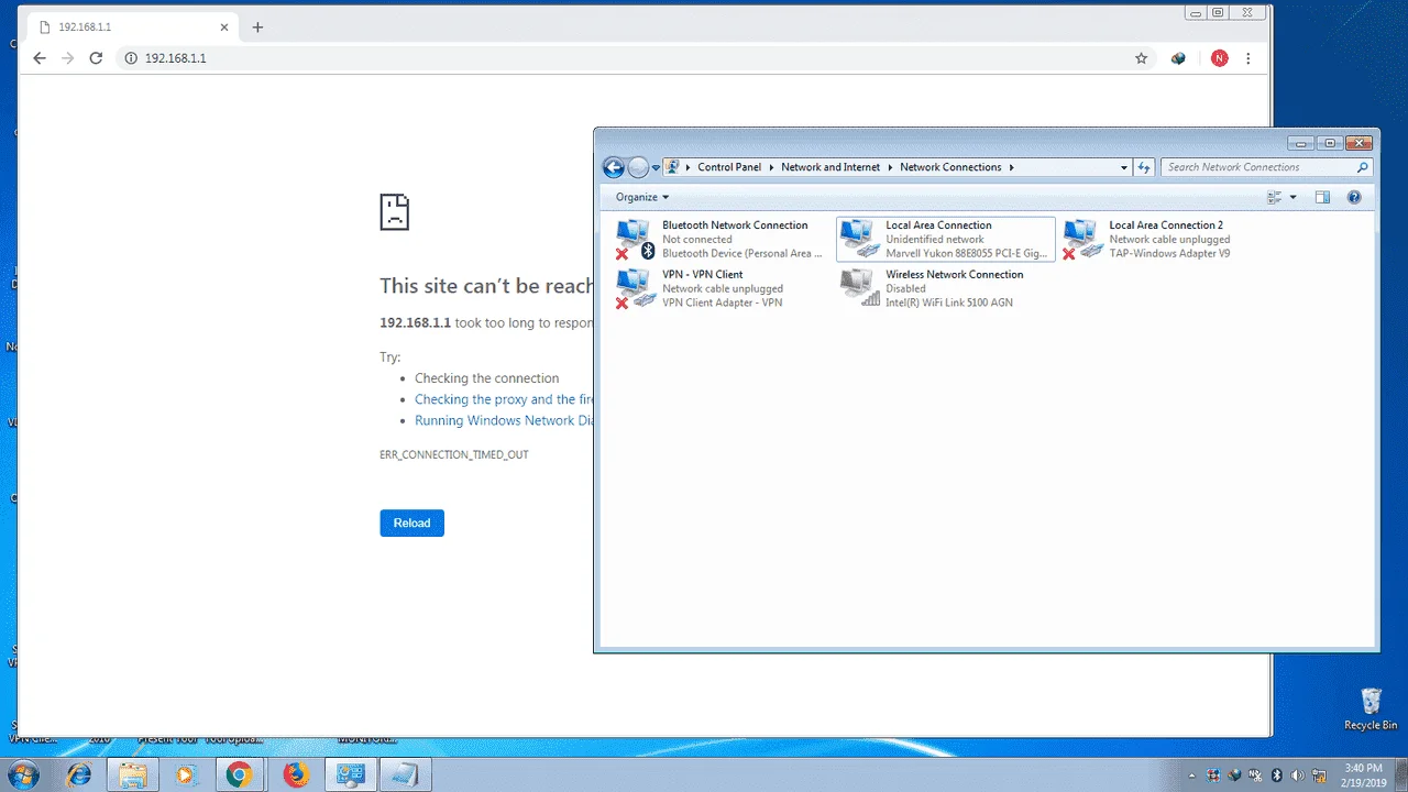

update:
undefined network sa ethernet si router paps. pero nakaka konnek naman sa wifi pero di maka pasok sa GUI dashboard 😢
kapag connected ka via wifi, na-aaccess mo ba You do not have permission to view the full content of this post. Log in or register now. ?
if restarting your router doesn't fix the problem try to do firstboot / restore factory default on putty terminal
putty terminal command
firstboot
reboot -f
