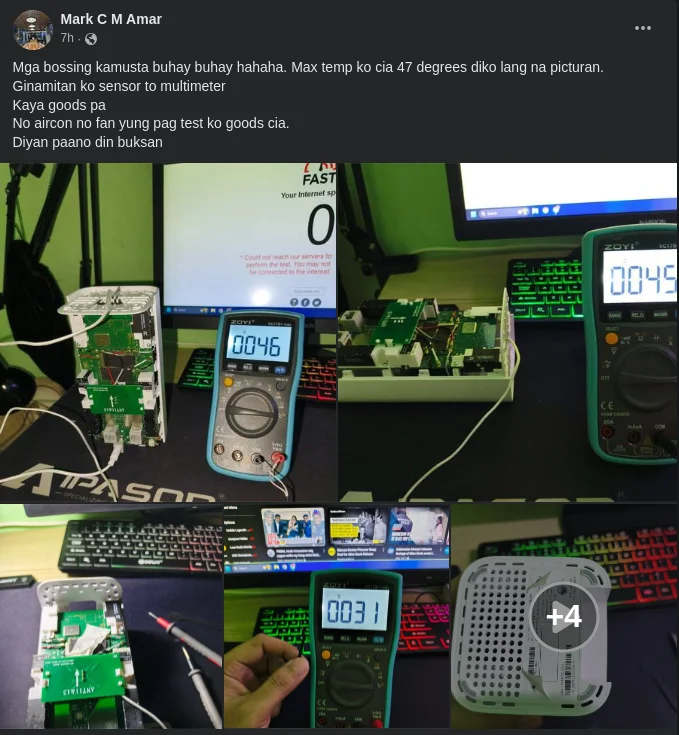

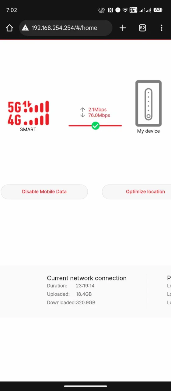

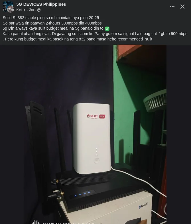

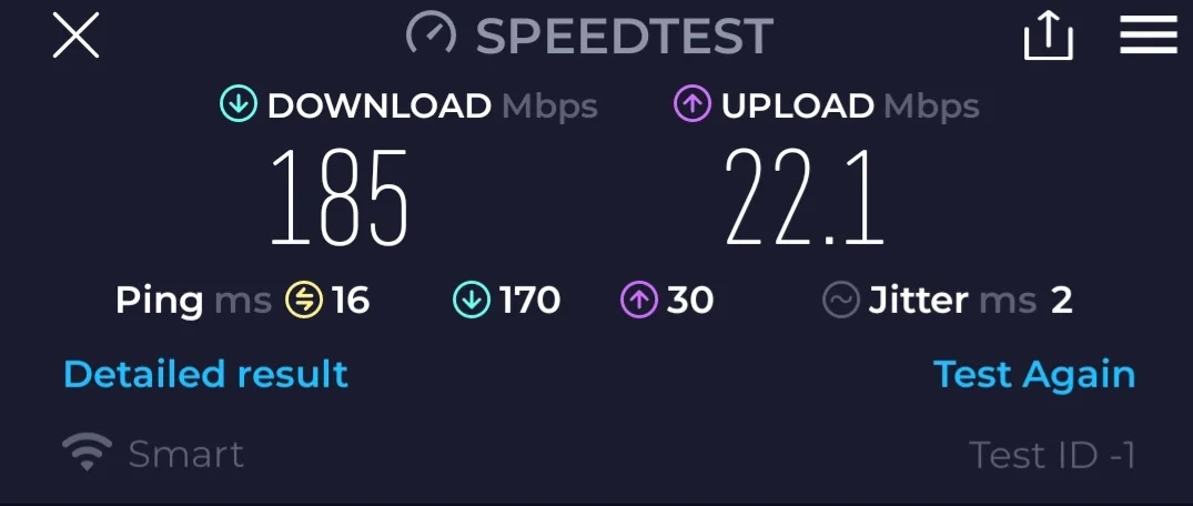

MjSalazar H153, Max 47C measured using temperature probe, 24hours walang patayan @ 300gb+ downloaded data
H155 review andun sa earlier post ko, pero alang temperature probing

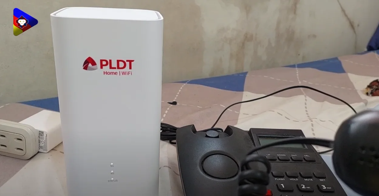

Also update as a bonus gumagana ang telephone port lol, review here:
You do not have permission to view the full content of this post. Log in or register now. <- manually type lang ayaw gumana ng link

kamusta naman speed, heating issues, same lang ba bilis nila sa 381 sana may makapag test sa dalawa

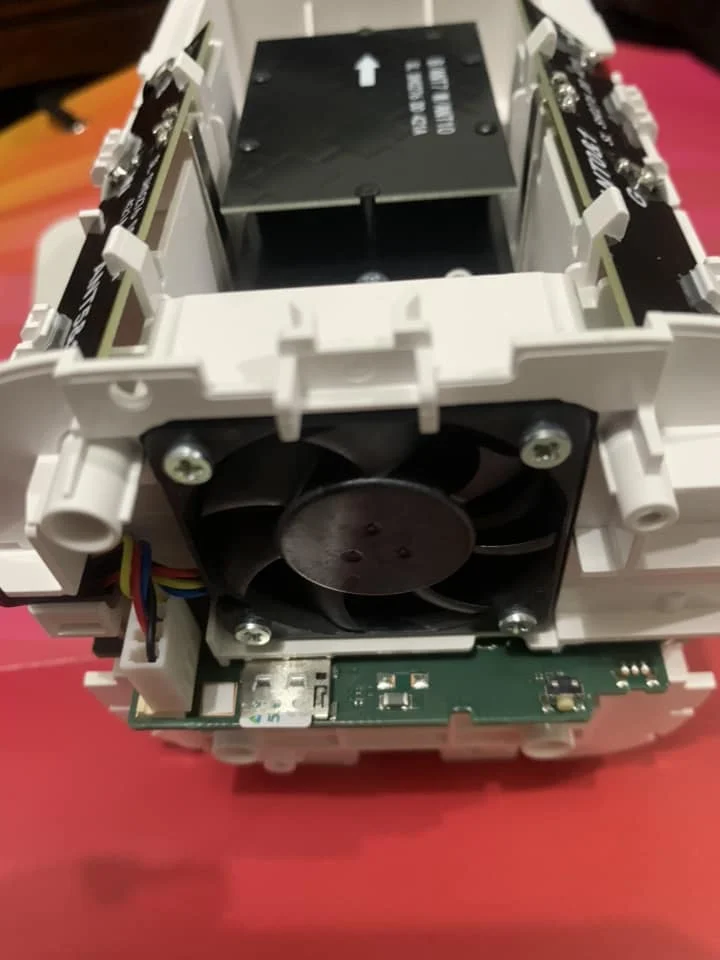

May built in fan naman yan kaya no worries sa heating issue
another H155 review confirmed walang patayan at di bumibitaw ping sa ML

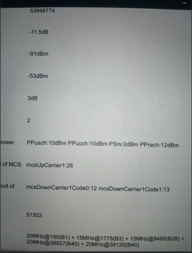

Additional tests 4G+ Mode Only: H155-382 4G 5CA confirmed
Solid 5CA at walang restriction sa CA ng
Tdd at fdd parang suncomm 02 din

^ yes po, andaming antenna compared sa H153, no wonder kaya ang 5CA nyan at grabeh humatak ng signal, kung mag external antenna mod ka, madami butas need for external antenna..
^ yes po, andaming antenna compared sa H153, no wonder kaya ang 5CA nyan, kung mag external antenna mod ka, madami butas need for external antenna..
mas maganda ang antenna ng h155 compare sa 381 kaya pala 11dbi sya. High end category modem sya like h122-373
