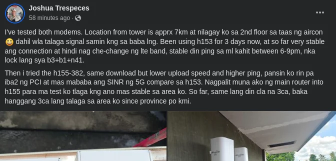

also to add na rin most tests done on FB are done over WiFi and I would guess their devices are WiFi 5 devices too, I have plenty of experience with WiFi 5, realistic upper limit tlga nya is upto around 400mbps lang... for sure if Gigabit LAN cable gamit mo or WiFi 6, aabot yan 600-800mbps promise if malakas signal sa area nyo... 3CA LTE + 5G NR is not a joke ambilis na nga ng 3CA, dgdagan mo pa 5G NR..
Much better itest din sa lan cable may nakita ako umabot ng 1.0 Gbps - 1.2 Gbps ang speestest niya using h153-381.

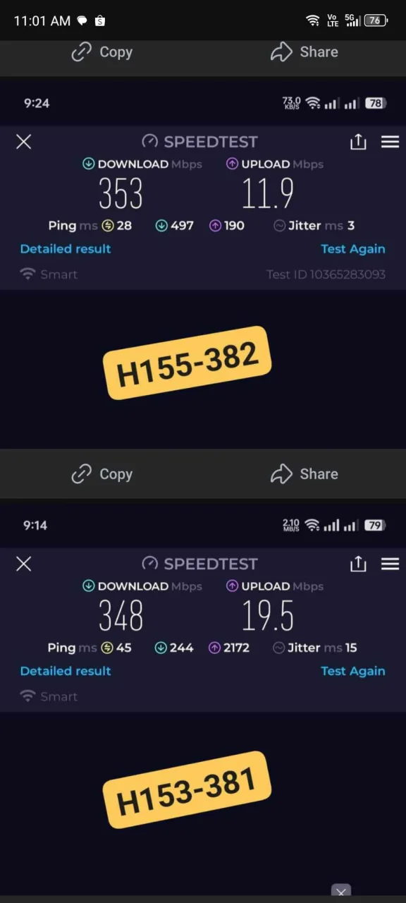

Share ko lang review ni Mr. Ramos (nag momodify din cya ng antenna)
YT Channel nya, both same area nya tinest: You do not have permission to view the full content of this post. Log in or register now. w.you tube .com/@MrJesusRamos

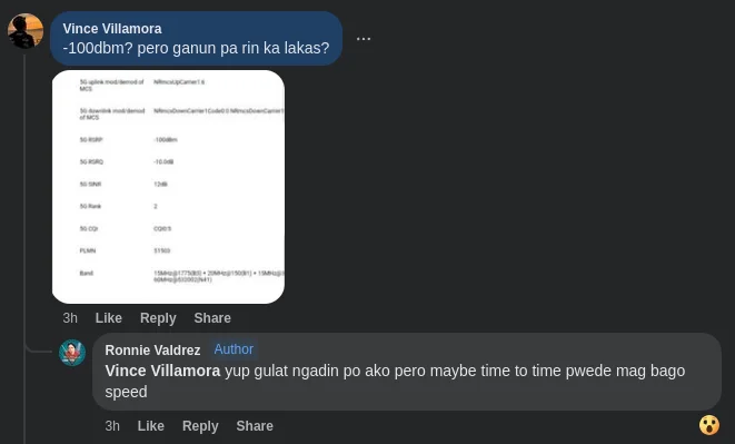

This is at weak signal area, -100dbm RSRP nya!
H153
H155
both raw speed AND latency nanalo si H155, kahit jitter talbog ang H153... even checking with the internals ni H153 vs H155, halatang mas angat tlga si H155, ewan ko but para sa akin cased closed na to, H155 is the clear winner here. But still, open to more tests and more scenarios... ito din comment nya kay H155

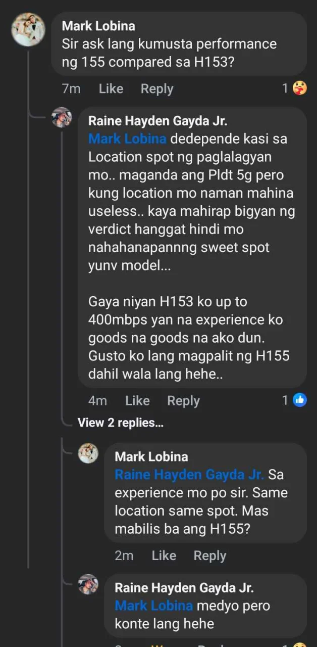

Para sa akin mas high end category modem si h155-382 kalevel nya si h122-373. Yun nga lang nakalocked sa Smart
Maganda yung H155 dahil 5g+ may plus na isa compare kay H153 at more CA pa capable kesa sa H153. Pero panalo rin ang H153, minsan nasa lugar lang din. Kahit gaano pa kalakas on paper kung yung lugar wala din mabigay na magandang speed wala rin, hindi ma maximize.

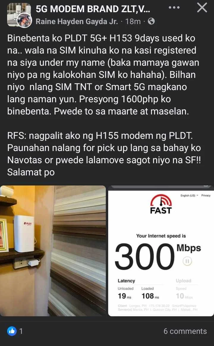

Madami na nag bebenta ng H153 nila ah, tapos pinalit or prefer na H155 :think3D:, tas pag tinanong baket, lowkey lang sagot, understandable naman na di mo sisiraan ang binebenta mo para din may bumili... ano kaya issue or how big is the difference

hindi ko ma gets ang review nya, but it seems to me H155 is still superior, if you can see sa latency and bufferbloat tests (loaded and unloaded latency) mas angat ang H155?? sure H153 has +8mbps in upload, i think it's just a margin of error or some traffic shaping/signal congestion at smart network, jitter is also much lower on H155 being just 3ms consistent sa review ni Mr Ramos, base latency is also lower at 25ms
Edit: oh i see, refer ata nya ung 200 vs 400 sa loaded latency.. but the latency during upload 2000 vs 190, i'd still opt for H155

Tbh, ganyang ka laking jitter 25ms ramdam na ramdam yan sa RTS games na latency sensitive
Pati na rin sa video calls, jitter kasi is parang nag spike ang ping during testing, it will show the same situation sa gaming na bigla biglaang mag spi spike ang ping

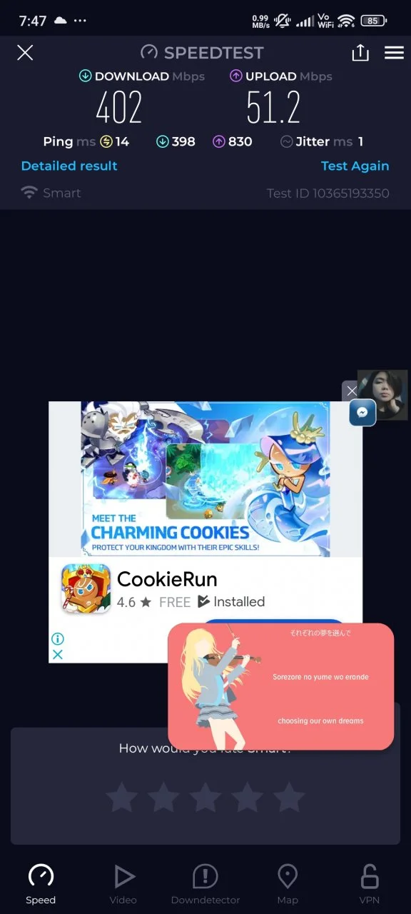

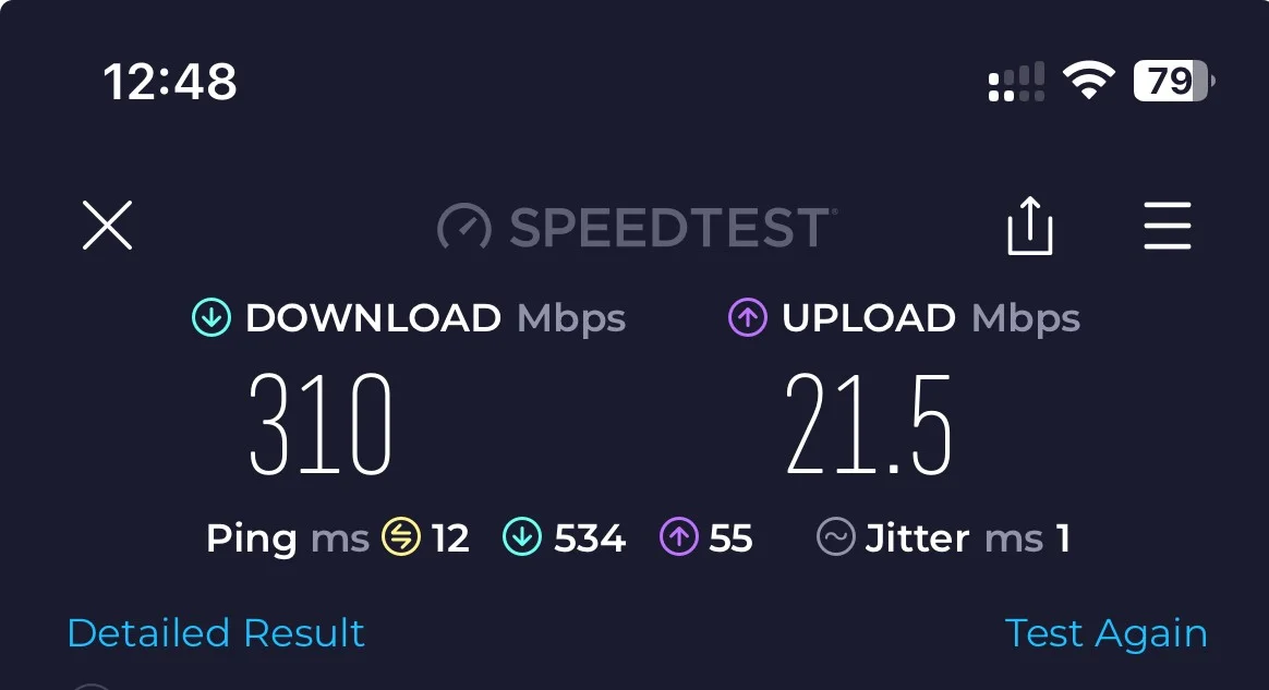

^ di ko napansin yung jitter. Sa speed lang ako nakatingin. Depende pa rin ata sa lugar yan. Dumating na din ba yung sa iyo? Musta results? jitter ng H153 ko nasa 1ms.IMG_0484.webp
