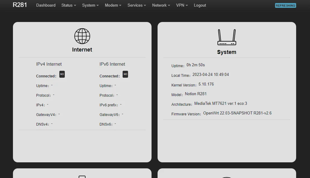

yung kernel ba? Sa video mo kasi yung sa factory. Thanks in advance. Try ko sa R291 ko. Nakamodified nadin ang bootloader neto. Pwede na via tftp flashing.
OK na naload ko na yung kernel paps.. Ano password ng dashboard?

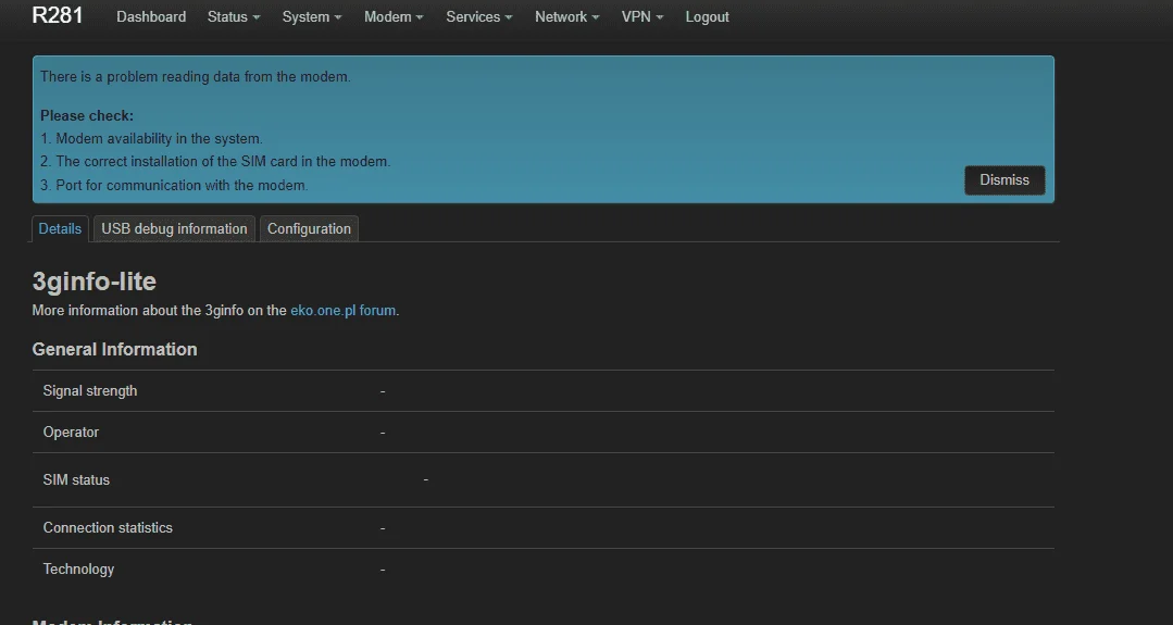

Yun mga nawawalan ng signal matapos mag flash nitong build, hulaan ko LTE firmware version ninyo V002. 😁
r291 paps
yan nilagay ko sa rc.local nubg stock firmware pa
cat /dev/log_radio|grep "\[RIL1\|\[rild\|AT cmd">/tmp/rild >> /etc/rc.local
then nirestart ko via power off at on
then yan naman nirun ko
cat /tmp/rild|head -n 150
tpos kinuha ko yung AT+CHECKATVALID=*
AT+CHECKATVALID=6443585894878062
then nung nagopenwrt na saka ko pinalitan sa /etc/gcom/ncm.json
