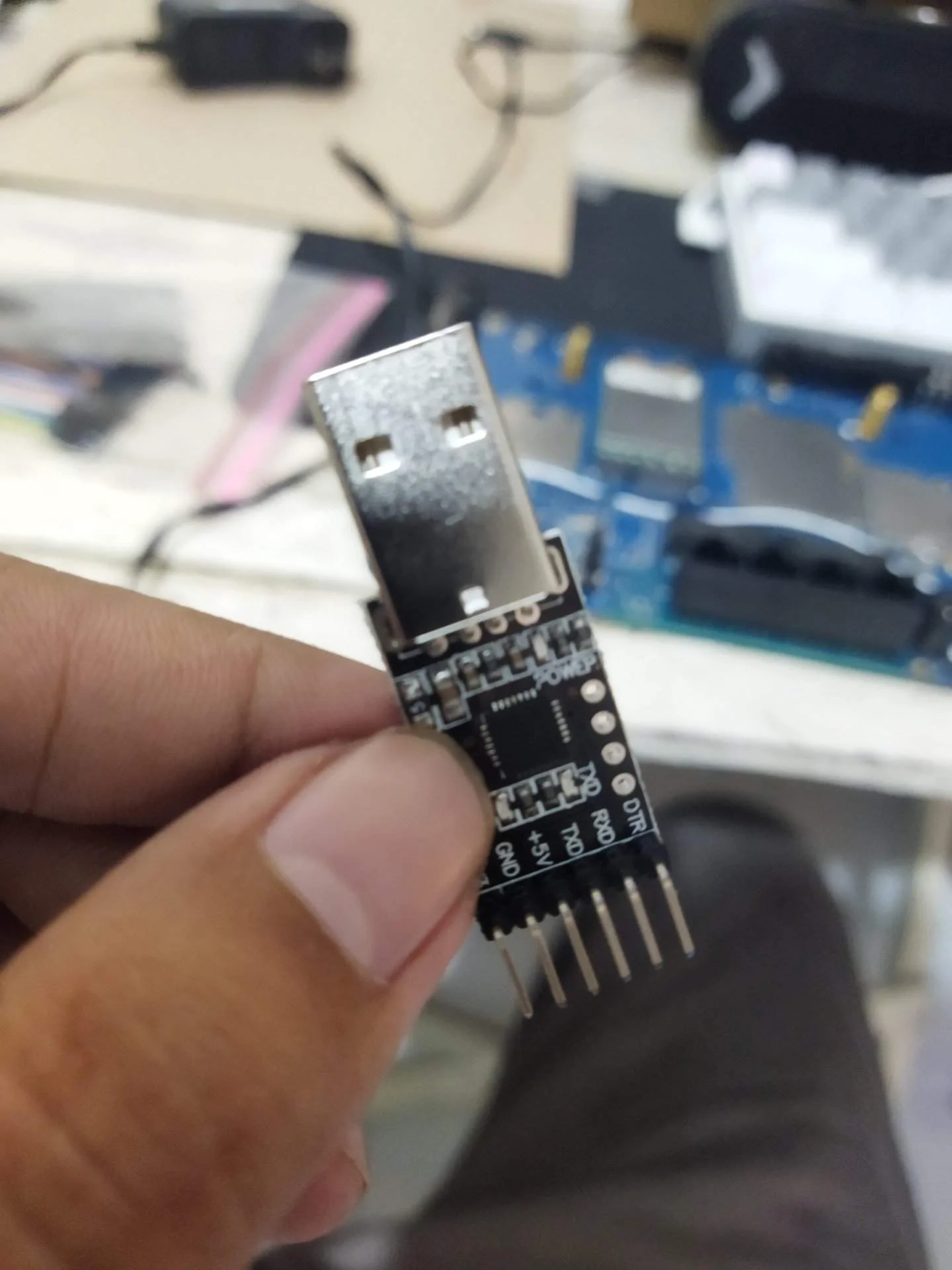

Pwede po b gamitin yung 4 wires ng data cable.yung parang sa pag flash sa 936?
Hindi ata kasi 3 lng need mo na sa UART.
Rx (receive)
Tx (transmit)
GND (ground)
kapag 4 kasi merong kasama na Vcc (Voltage-in) hindi need yun tsaka baka ma brick.
Tsaka yung USB-TTL parang may maliit na circuit board yun para basahin ng PC. Yung 936 kasi may USB port na kaya no need mag converter
Rx (receive)
Tx (transmit)
GND (ground)
A thanks po sa info.pag ginawa nyo na po yung flashing.sana po kahit i video nyo po for tutorial.thanks po and Godbless

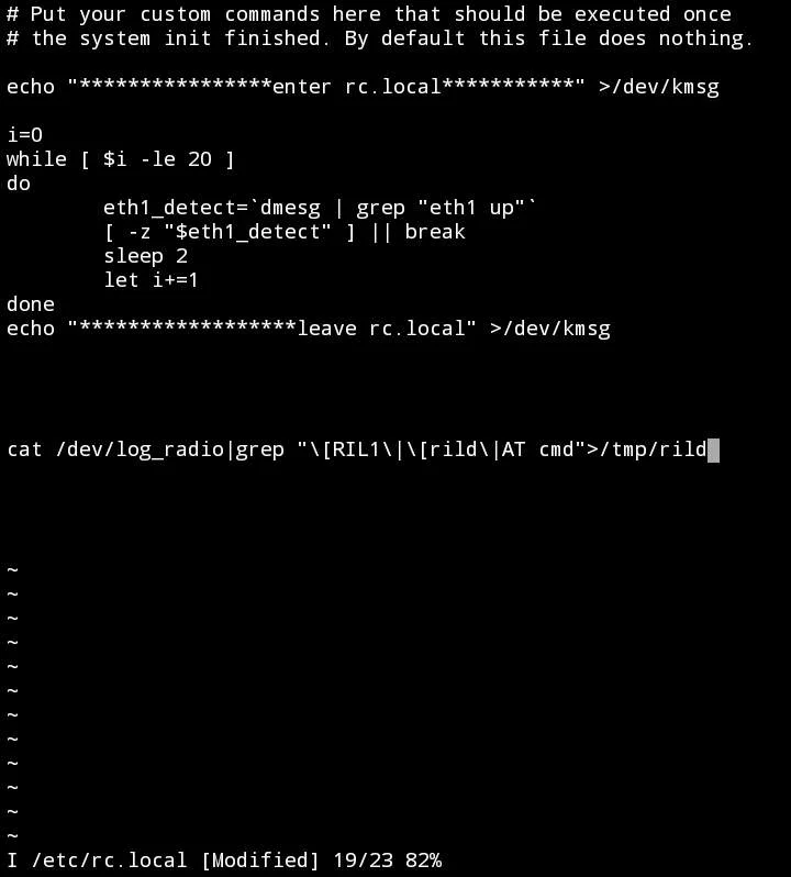

login ka sa ssh
tapos mag lagay ka ng ganitong command sa /etc/rc.local
Code:
cat /dev/log_radio|grep "\[RIL1\|\[rild\|AT cmd">/tmp/rild
after niyan power off then power on
eh unplug dapat hindi reboot ha
login ka ulit sa ssh

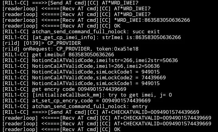

eh run mo naman itong command
Code:
cat /tmp/rild|head -n 150
hanapin mo yung AT+CHECKATVALID=*
at kunin mo yan.
flash ka ulit nung openwrt na firmware

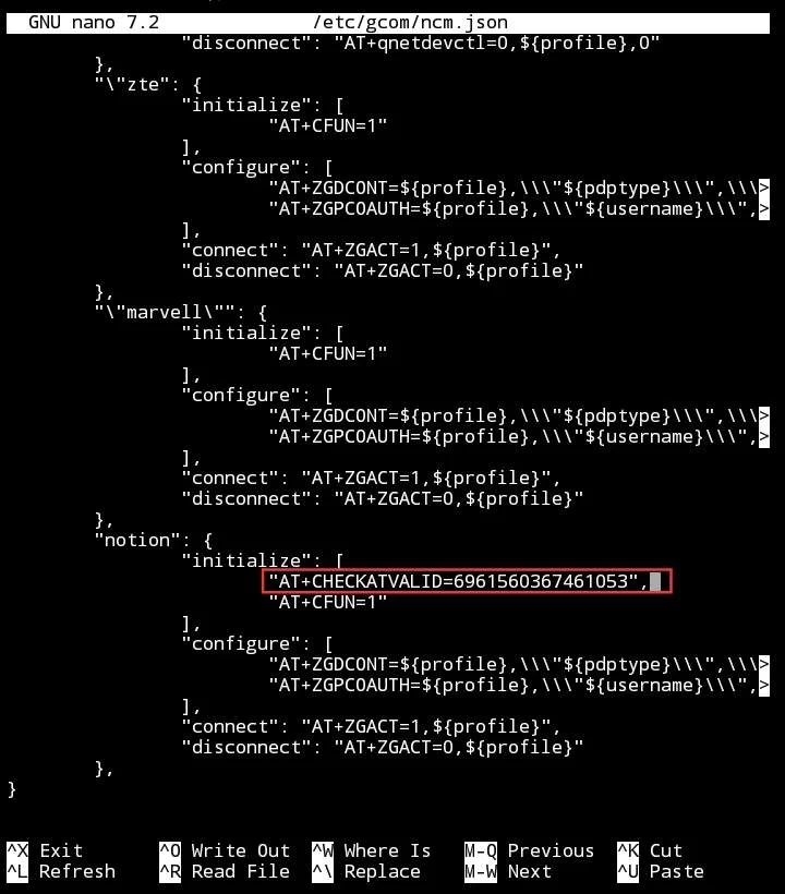

at edit mo naman yung /etc/gcom/ncm.json
hanaping mo yung part na notion
replace mo yung number nung sa CHECKATVALID=*
lagay mo yung nakuha mo kanina
after nyan reboot mo yung wifi
