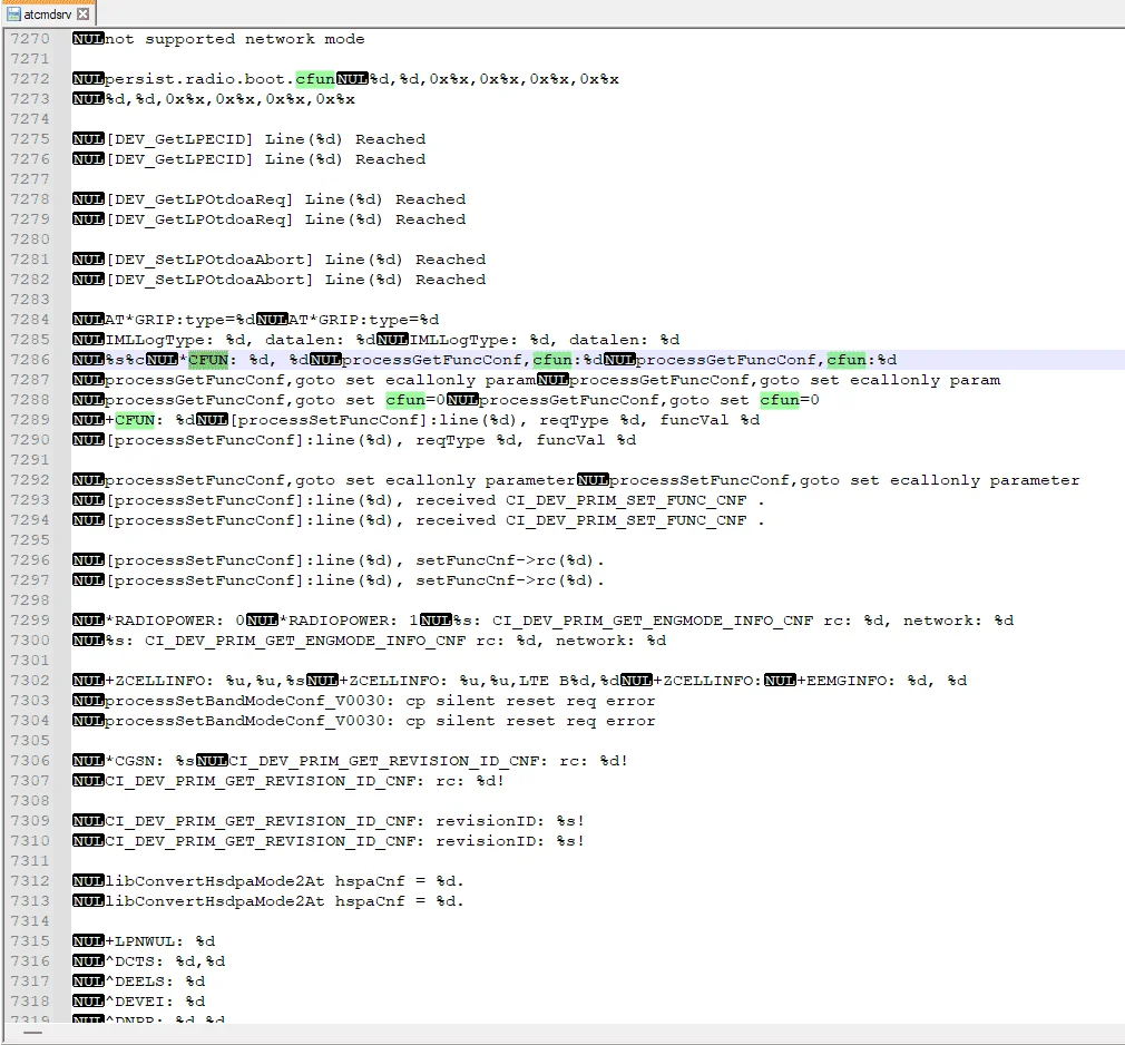

I don't know if this might be helpful but here is a atcmdsrv file I extracted from a bin file (Baseband 2.0) shared here by someone. When opened with notepad++ or Ghex in linux I was able to view some AT commands that might be the AT commands the modem accepts. I'm not entirely sure.
atcmdsrv file: You do not have permission to view the full content of this post. Log in or register now.
I got the idea from You do not have permission to view the full content of this post. Log in or register now.
Yes ganyan kumuha ng mga hints sa tamang commands para sa modem. Hindi lahat dyan ay gagana at hindi rin lahat ng commands ay makikita dyan, pero isa yan sa mga panimulang pamamaraan ng pagtuklas.
