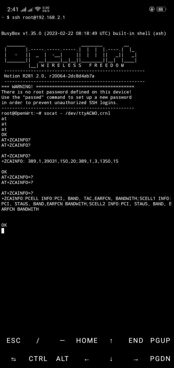

1MPACT2 how is the ZCAINFO value returned in your baseband version? Does it show the band, pci, earfcn for the secondary frequency when doing CA? Under baseband V002, I only get the correct primary band values. For the secondary band, the values seemed random, useless like this for example:
Code:
+ZCAINFO: 414,28,19106,9485,15;1,63,4,0,0
Thus, I couldn't accurately display signal information for the secondary band under 3ginfo when the baseband is operating in CA. Only the primary band could be displayed. So I'm wondering if this is one of the benefits of later baseband versions, fixes for signal information like this one.

mukang pareho nanam yung output

Thanks. It looks like yours give accurate values for the secondary band, while mine is gibberish. Another observation is that V002 Baseband has the usbid 1286:4e28, while yours is 1d6b:0002. This is another difference between the two versions.

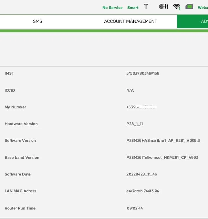

no service yung sakin nung na flash ako
mukang hindi pwedi sa smartbro 5.3/3.1
