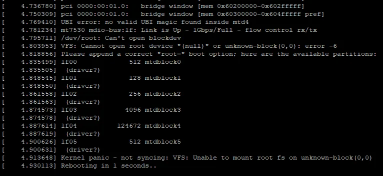

Ano po kaya ang problem nito? after flashing sysupgrade bin.
Please read the instructions carefully, particularly point number 1 on the first post, which is the issue you are experiencing if you didn't read this point.

I checked the layout of my modem before flashing the openWRT earlier, and I have reflashed again the modem with the stock firmware. Also, double checked the flash layout of my modem (PLDT variant). I assumed it is ready to migrate to OpenWRT.
May na-miss po ba akong config/instruction?
EDIT: I was able to flash OpenWRT after reflashing back to PLDT stock firmware, then flashed it again with OpenWRT.
Thank you so much, bjarnco32.
