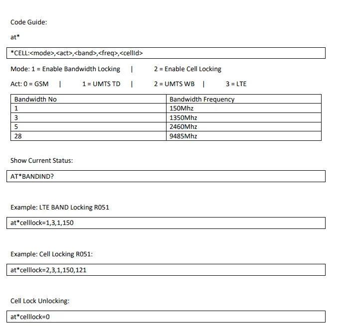

kabit mo yong R051 sa pc or laptop, install mo muna yong driver, at install ka putty, ito You do not have permission to view the full content of this post. Log in or register now. ng driver tapos gamit ka data cable then connect mo na, open mo na yong putty tapos yong mga codes sa kada band.
Band 1
at*celllock=1,3,1,150
Band 3
at*celllock=1,3,3,1775
Band 5
at*celllock=1,3,5,2460
Band 28
at*celllock=1,3,28,9485

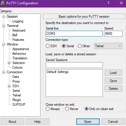

Pag mag change band ako boss from the original 28 to any band ay mawawala imei ko tas di ma enable internet connection.
Panong ibang version? Smartbrohome Wifi ba sayo? same lang naman yan
Nag sa-succeed po yung change band po kaso ngalang yung imei mawawala tas di ma enable yung internet po.
Use ko po ay Putty tas data cable lang sa pc with enabled telnet sa windows features.

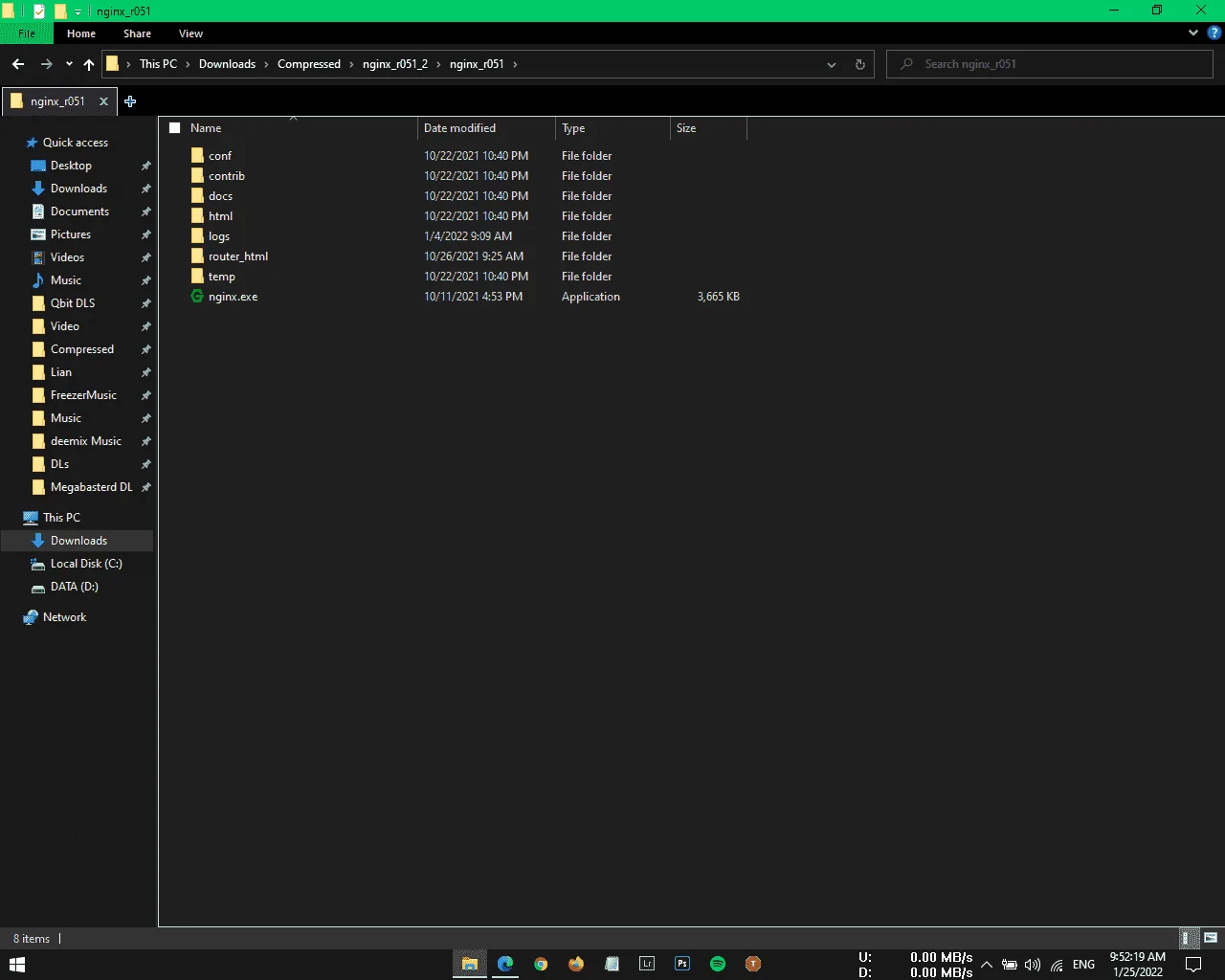

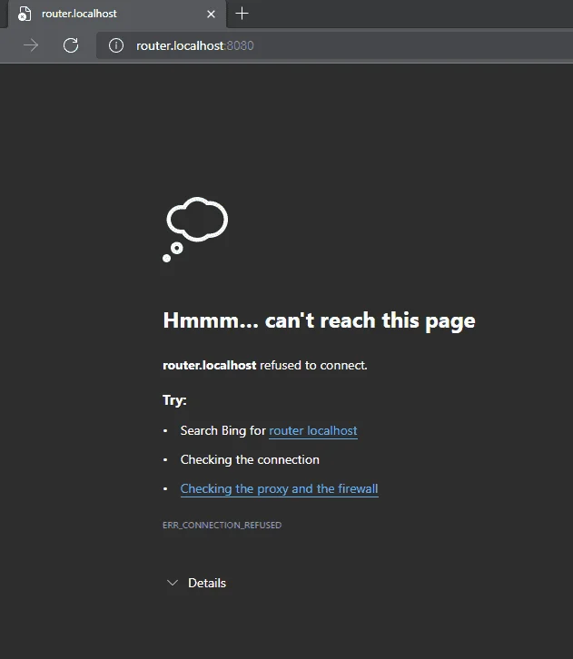

Yung sa nginx din po na part di ko alam paano ma access yung router.localhost:8080. Enabled nadin po yung Telnet service ng windows 10 ko po tas installed nadin latest Nginx.
run mo muna yong nginx bago mo buksan yang localhost
View attachment bandicam 2022-01-25 09-52-18-157.mp4
Yun parin po :(
wait yong kay H4wk3yetv gawin mo pwede din mas madali
yang nginx.exe run mo muna bago mo buksan localhost
Nanuod din po ako sa video niya titled: "
Smartbro R051 Software Version V011 Base band Version V005 Speed Test & Band Locking Video Tutorial"​
Yun nga e di maka proceed kasi di maka connect. Connection refused using PC at CP. Yung way lang para ma change band ay Putty + Data cable, mag sa-succeed pero mawawalan IMEI, IMSI, ICCID tas di po ma enable internet.
