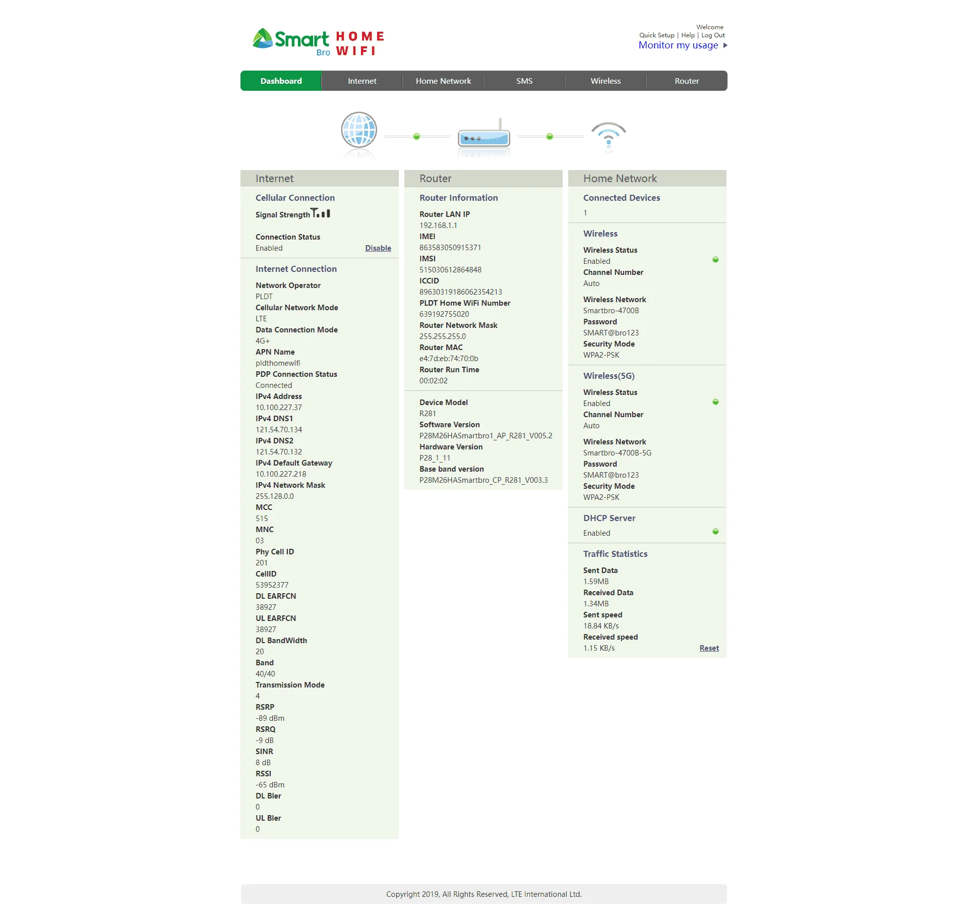

PLDT Boosteven R281 (Band Locking)
Master baka pwede pa request permanent nito sa Firmware v42/22 or V52/v3, For free para sa marami
R281 Optus V1 Gui Dashboard Tgz files
R281 v2 Optus Dashboard From Alex1212
Firmware v52/v3 Credit from Lods Amee_Rus
R281 Optus V2 Gui dashboard
SMARTBRO R281 Optus V2 5.2 and 5.3 WEBUI moded smooth theme
open Putty SSH at Winscp
Upload file to winscp, tmp folder
then punta sa Open SSH
copy and paste this code
sysupgrade -r /tmp/www_moded.tgz
ito yung file....download & extract zip file no pass

View attachment 2033167 View attachment 2033170 View attachment 2033970

Easy band locking via web interface.
Download You do not have permission to view the full content of this post. Log in or register now.
Then iupload sa router gamit AndFtp.
Watch video for steps.
View attachment 1767810Paalala lang:
Dapat enabled na ssh ng router mo at alam mo password nito.
