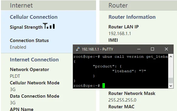

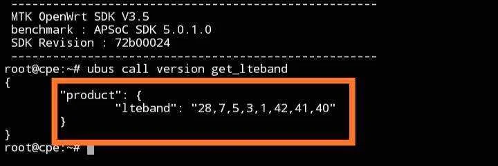

PLDT Boosteven R281 (Band Locking)
labas ko na downgrading ng smartbro 5.3/3.1
bukas dapat OTA bago kayu mag downgrade
AP: P28PLDT_AP_R281_V004.2

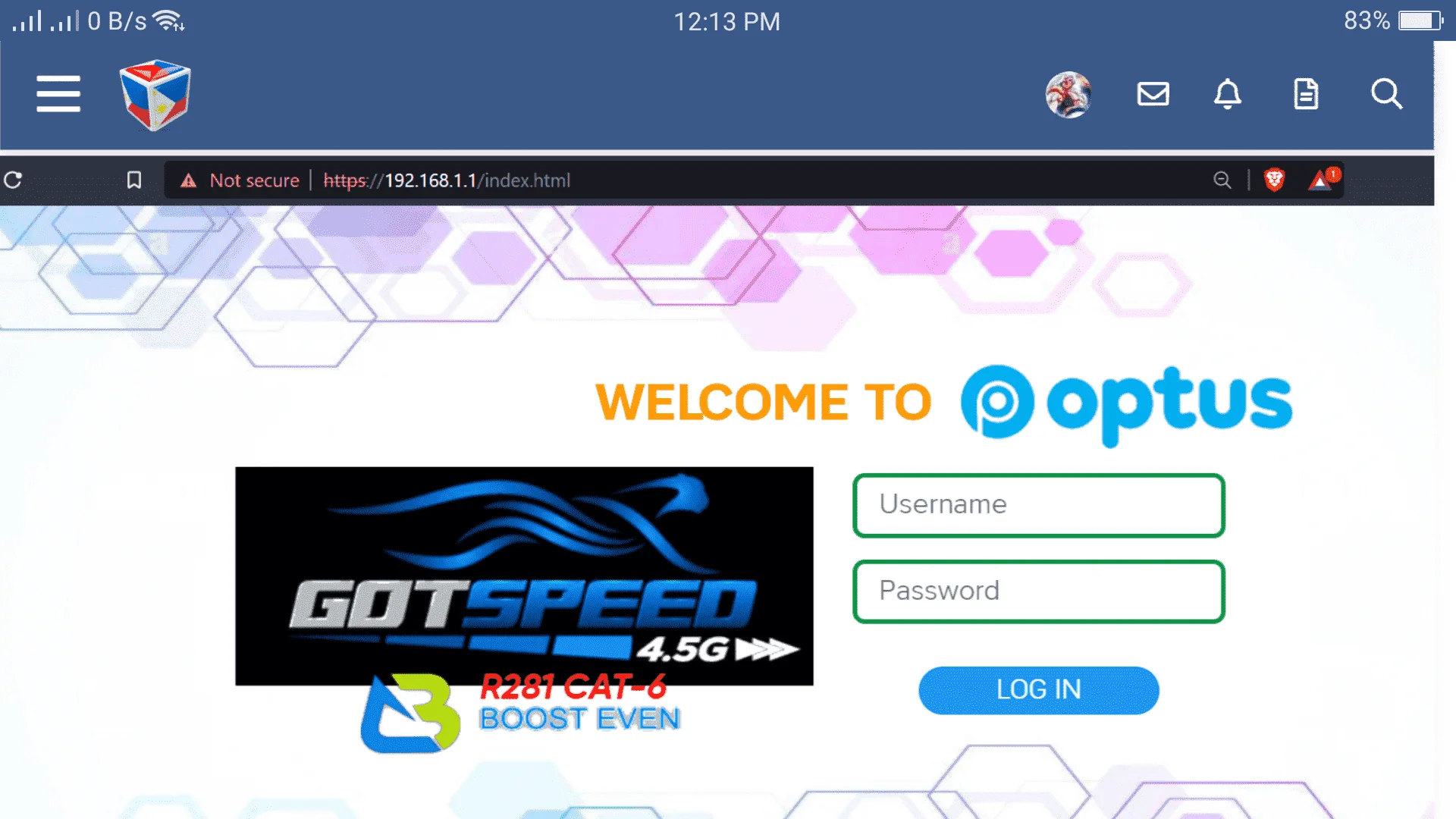

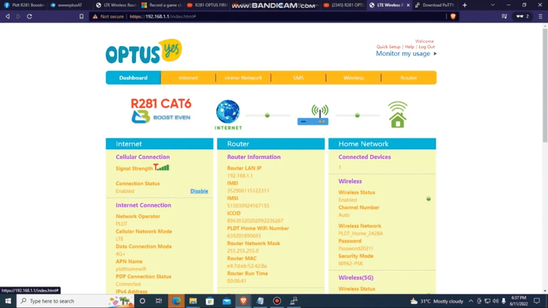

R281 Optus V1 Gui Dashboard Tgz files
R281 v2 Optus Dashboard From Alex1212
Firmware v52/v3 Credit from Lods Amee_Rus
R281 Optus V2 Gui dashboard
SMARTBRO R281 Optus V2 5.2 and 5.3 WEBUI moded smooth theme
open Putty SSH at Winscp
Upload file to winscp, tmp folder
then punta sa Open SSH
copy and paste this code
sysupgrade -r /tmp/www_moded.tgz
ito yung file....download & extract zip file no pass
Dropmb Free File Hosting | www_moded.7z
"""mawawala kapag nagreset..."""
username:smartbro
password:Smartbro@1234
or ang inyung user and pass...
Credit from Alex1212 ka phc
Credit sa nagkalat sa Yt
God Bless sa Sharing
