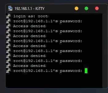

Salamt sir. Di kaya unique ang password kada modem?
access denied ang pass sa akin. or may way para malaman ang default?
Try mo kung gagana, wala lang kasi akong modem na ganyan kaya hindi ko matry.
<?xml version="1.0" encoding="US-ASCII"?>
<RGW>
<param>
<method>call</method>
<session>000</session>
<obj_path>router</obj_path>
<obj_method>set_dropbear_info</obj_method>
</param>
<router>
<dropbear_mode>1</dropbear_mode>
<dropbear_key_type>99</dropbear_key_type>
<dropbear_password>root</dropbear_password>
</router>
</RGW>
Ang magiging password nya sa ssh ay
Code:
root
