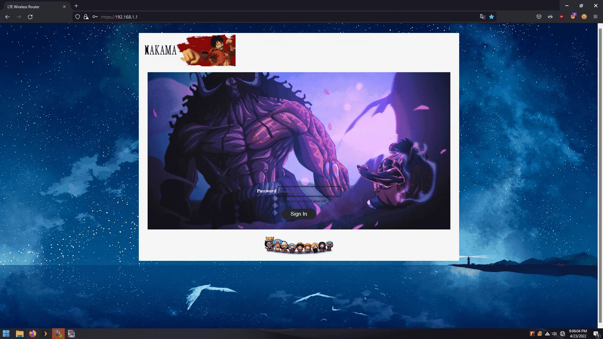

PLDT Boosteven R281 (Band Locking)
One Piece inspired theme. pwede all version except sa stock na smartbro 5.2 design.
Need Putty at Winscp
Open telnet
Steps:
Open Telnet or SSH ng modem
Upload file to winscp, tmp folder
Open putty and choose either telnet or ssh
copy and paste this: sysupgrade -r /tmp/www.tar.gz
mawawala kapag nagreset

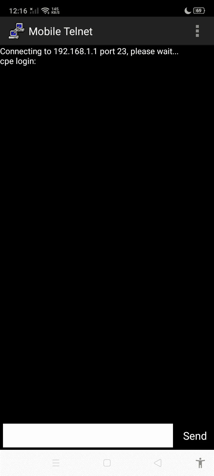

Open telnet
Steps:
copy and paste this: sysupgrade -l /tmp/www.tar.gz

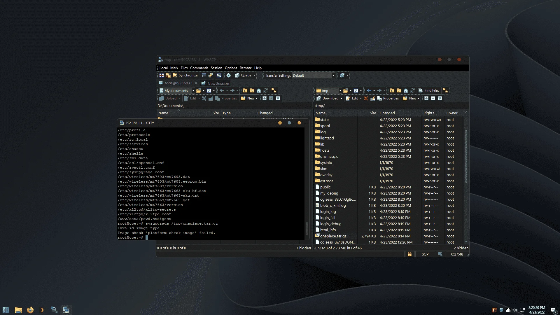

Maraming salamat po maam/sir. Panu kaya pag ganitong error? platform check image failed
and possible kaya ma build from source dahil OpenWRT based?
4.2 lang yan? pwede rin yata yan sa smartbro 5.2. kaso di gagana pci at freq. locking ..... band locking gagana yan kung base 4.2 yan...
make sure tama yung file name
sysupgrade -r /tmp/www.tar.gz eto rin po pala yung command not -l

Baka meron kayo band locking file para sa smartbro r281 5.2, 3.0.. salamat mga master
enable mo telnet at ssh muna, tapos check mo first page ang post ni ts, or flash 4.2 firmware with bandlock.
Kaya nga po, unusual nga yung nangyari di naman na galaw yung login config pero ayaw ng sinet kong pass pati default.
