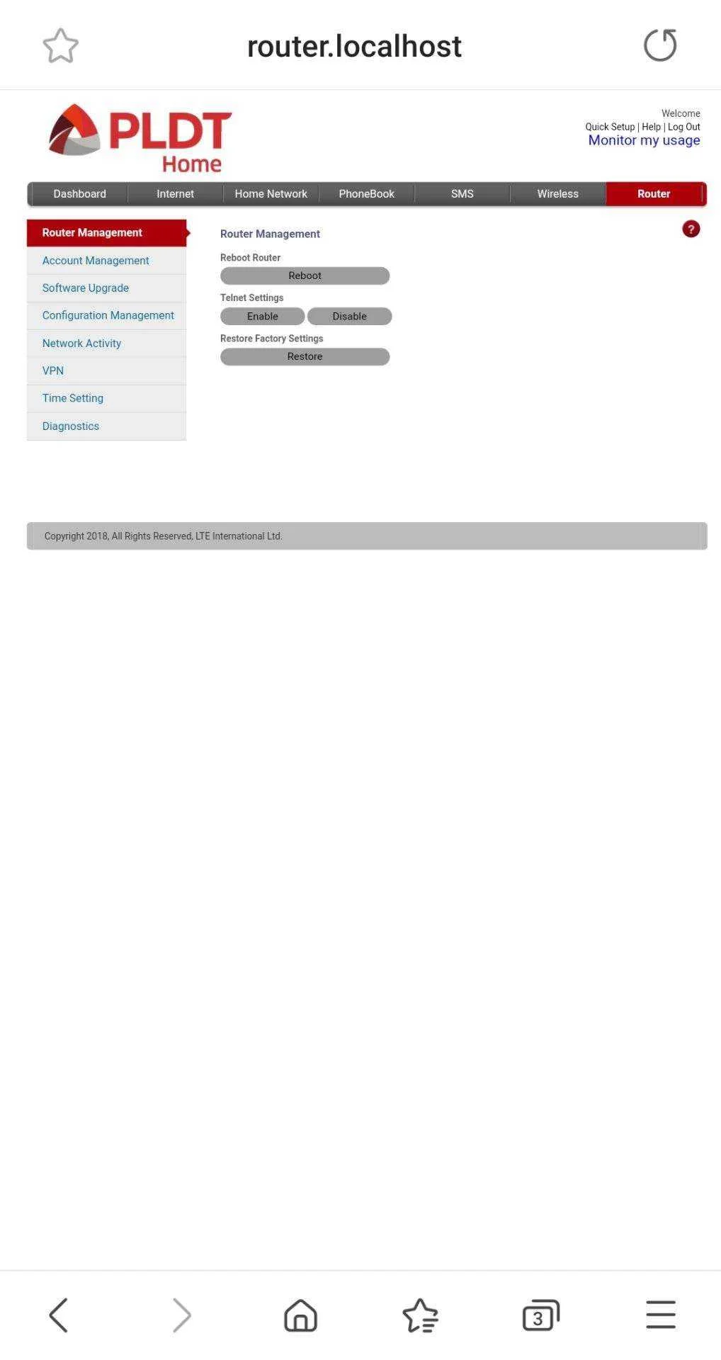

PLDT Boosteven R281 (Band Locking)
Enabled Ssh Lods
Sa Termux
Type install apt Dropbear then press enter
Pagkatapos ma-install dropbear
Eto yung commands pang enable SSH
run mo ito para mag open yung dropbear
/etc/init.d/dropbear enable
dropbear -p 192.168.1.1:22
Next Command
ubus call router set_dropbear_info '{"dropbear_mode":"1","dropbear_key_type":"0"}'
Run this command
ubus call router set_dropbear_info '{"dropbear_mode":"1","dropbear_key_type":"99"}'
Optional dto wag napalitan para sa unlocking
Changed PW run
passwd
Make your PW permanent run
fw_setenv dropbear_password your created pw
Ex: fw_setenv dropbear_password root
