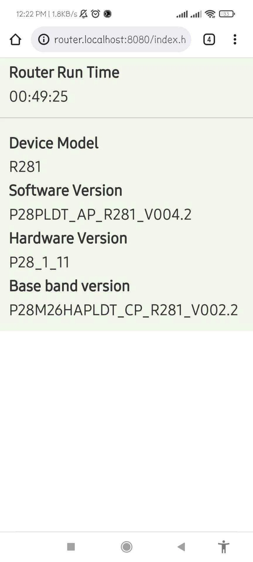

Ibigay mo mep pin try ko sa modem ko o kaya sabihin mo saang directory mo nakita lods para di na ako mahirapang maghanap. Anong pkg ginamit mo para maging standard text kung naka binary file ung file. Salamat
Install ka termux boss tsaka need mo open telnet ng r281.
meron na lods pati
Install teamviewer from playstore
Saka yung install termux from apkcombo
Sapat naka enabled na telnet at ssh mo punta ka sa page 1 nitong thread used nginx shortcut enabled Telnet
Then use Termux enabled ssh,
Pero need mo install dropbear s termux muna
copy lods na install kuna done enable telnet
meron na lods pati
Enabled Ssh Lods
Sa Termux
Type install apt Dropbear then press enter
Pagkatapos ma-install dropbear
Eto yung commands pang enable SSH
run mo ito para mag open yung dropbear
/etc/init.d/dropbear enable
dropbear -p 192.168.1.1:22
Next Command
ubus call router set_dropbear_info '{"dropbear_mode":"1","dropbear_key_type":"0"}'
Run this command
ubus call router set_dropbear_info '{"dropbear_mode":"1","dropbear_key_type":"99"}'
Optional dto wag napalitan para sa unlocking
Changed PW run
passwd
Make your PW permanent run
fw_setenv dropbear_password your created pw
Ex: fw_setenv dropbear_password root
