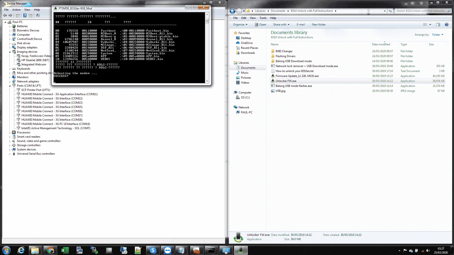

Hi There. Need a little help.
I've solder to the usb point and shorted the test point.
Ive run Balong USB Mode Flasher and it ran ok.
I now have sereral Huawie Mobile Connect entries in Device Manger.
I now run Unlocker FW and it starts. but there are a lot of ????? on the screen and but items 0 to 10 look ok, then more ?? for 11. I leave it running as it says it finished.
But i dont think it's working as none of the lights on the pcb come on.
Screen shot attached.
Any Thoughts. I have repeated the process serval times.
Regards Paul
