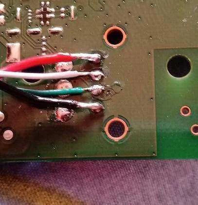

So, I've tride again.

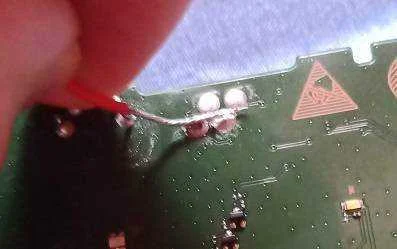

This shows my solder usb cable
And this my jumper

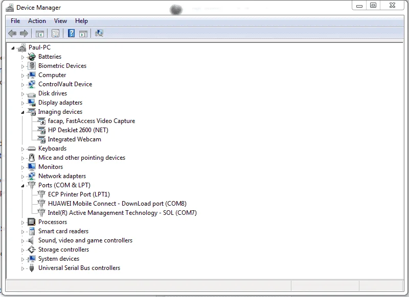

Windows then show this in device manager.

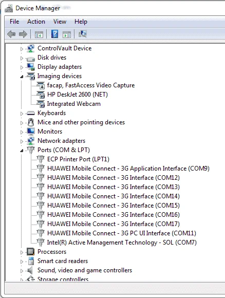

I run the Balong USB mode flasher.exe
When this is finished. I get this in device manager

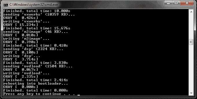

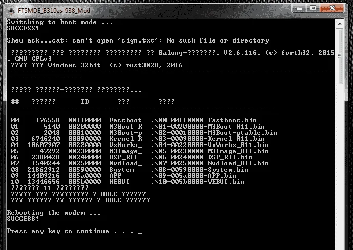

So i then run Unlocker FW.exe and get this.
I belive at this point it should be printing more things on the screen as it writes to the router, it says it's finished ,but then nothing changes in windows deivce manager, and through the whole process no lights show on the router.

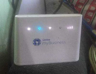

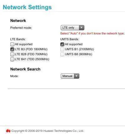

Magandang Hapon po mga idol and master....
Patulong din po , meron akong b310as-938 na Globe myBusiness router with admin access and open line na rin.
Problem ko ung network selection nya lang
Is pang Globe LTE.
Pag inserted na ang SUN or Smart Sim
pareho prin ang network
Anu po kailangan para lumabas po ung ibang network para sa smart LTE
Salamat po mya idol
