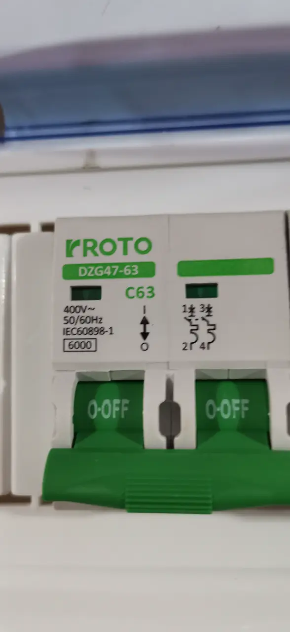

❓ Help Hello Sa mga Electrician Dyan. Ask lang about MCB
reacah
Eternal Poster
Ung ganito bang mcb ay Reversible. may napanood ako sa yt na kapag may marking na 1-2 at 3-4 ay non reversible, pero sa fb may nagpost, electrcian ang nagpost ng ganyan na mcb not same brand but same specs, ung line side nya from meter base, ung wire nasa ilalim which is usual at common na nasa ibabaw. sana may makatulong
base sa Symbol, irreversible yan.
base sa search:
Yes, the switching mechanism on a DZ47-63 C32 circuit breaker is reversible. You can manually turn it ON and OFF.
However, its tripping action is irreversible (automatic). Once it trips due to an overload or short circuit, you cannot simply hold it in the ON position; you must first move the lever fully to the OFF position to reset the internal mechanism before switching it back ON.
sorry di ako electrician, basic subjects lang sa electrical nakuha ko..hehe
Hindi yan Reversible yung 1 at 3 yan yung supply side nya dyan papasok yung MECO supply yung galing sa metro ng kuryente mo tapos yung 2 at 4 yan yung load side niya papunta na sa distribution panel mo sa bahay
Wag mo baliktarin kasi kapag me nag short circuit hindi yan mag trip delikado baka masunog bahay mo
ung nga din ung sinasabi sa yt pero sa fb na nagpost na electrician baliktad ang gawa nya
