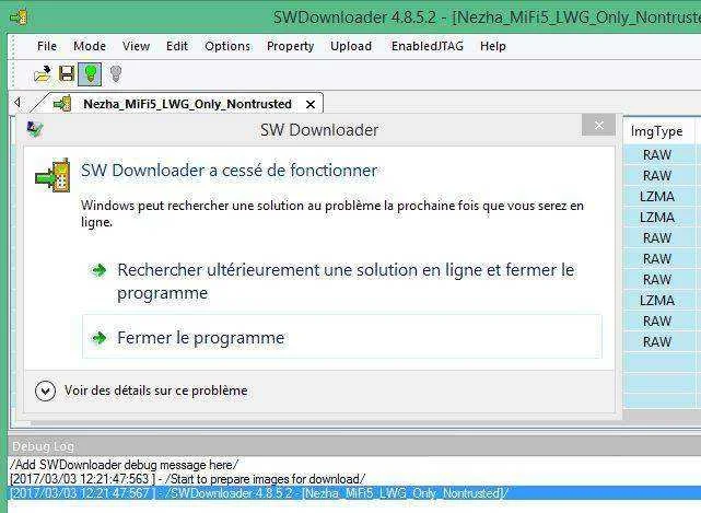

Ok na pala ang technique pala dapat wag i-click yung upper button dapat diretso agad sa pag input ng IMEI at mas ok kung sa windows 7 gawin, nung ginagawa ko kasi sa windows 10 lagi not responding eh buti sinubukan ko sa ibang laptop na naka windows 7 ayun flawless ang pagpalit ko ng IMEI using mifi tools

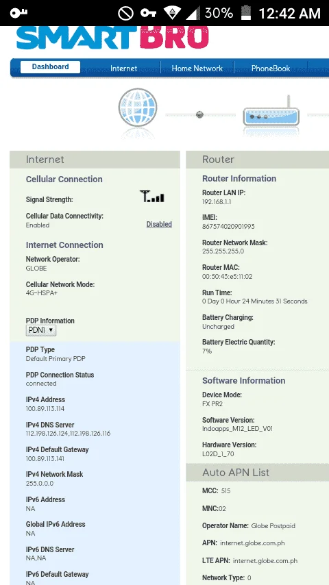

Hello Mga Friends.. Finally after thourough researches and trial and errors dahil nawalan ng 4g signal ang pocket wifi ko at nawalan pa ng LCD display and it took much of my time kasi kelangan maghanap ng compatible firmware pero guess what almost 90% of the same chipset and board id would not make my LCD lit and the stock firmware did not help as well. I got a stock firmware back up but it somehow lost its 4G capability for some reasons. So because halos magasgas na ang atay at balunbalunan ng pocket wifi natin sa isang kilong firmware na labas masok sa kanya. Before po iflash itong ibibigay kong firmware load any firmwre and uncheck erase all flash and instead check erase flash only. Therefore iwiwipe nya completely ang mga software na nakain nya hehe and it won't burn the loaded bin files its just a pre requisite para makapag erase tayo ng firmware without having to flash pa. So once done so walang OS ang pocket wifi saka naan natin iload ang firmware na iuupload ko dito. username and password po nito is admin/admin. Debranded din po ito, Walang bakas ng SMARTBRO na nakalagay. I will attach Print screens too. Good Luck!

Ano mga compatible models dito? Pde kaya sa M022T?
Have only tried it on mine. Pero I think it could work as mine is of different variant but it actually worked compared to the same exact model of board. Trial and error lang talaga kaya if I may suggest dont mess up na lang with your stock Smartbro firmware hehehe nakakapagsisi talaga.
