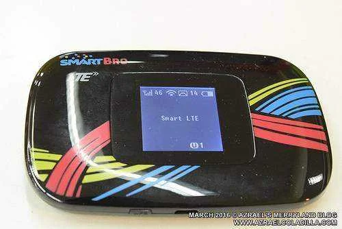

Difference of FX PR2 to FX PR2L
pr2l-black-with-free-smart-bro-prepaid-sim-0262-2336874-a57ecd5d1a09b7334b8c41ea19b94b80-prod...webp
FX PR2 (W/ LED)
FX PR2L (W/ LCD)

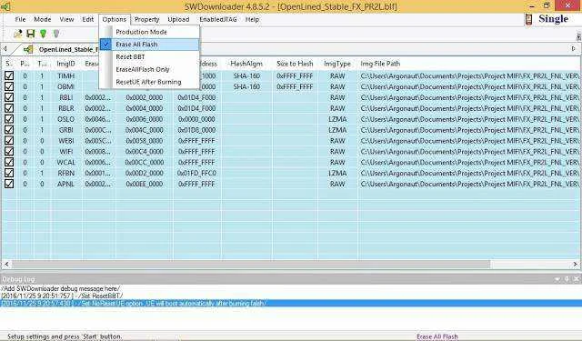

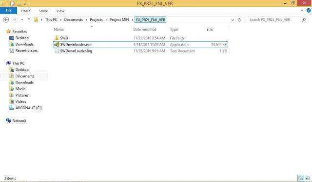

  4. Run the SWDownloader.exe from the extracted firmware folder.

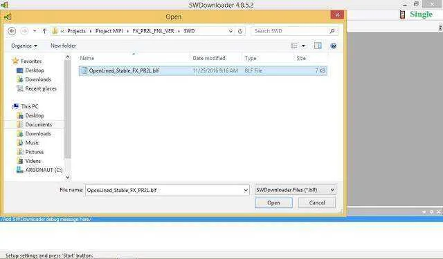

  5. Select the .blf file from the SWD folder in the extracted firmware folder.
  6. Make sure the erase all flash is ticked.

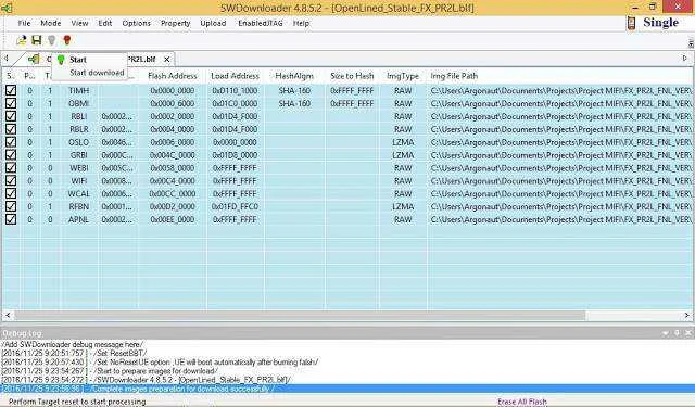

  7. Click the green bulb icon and connect your device using USB Cable with the battery removed.
  8. Wait until the flashing is done and disconnect it from the USB cable.

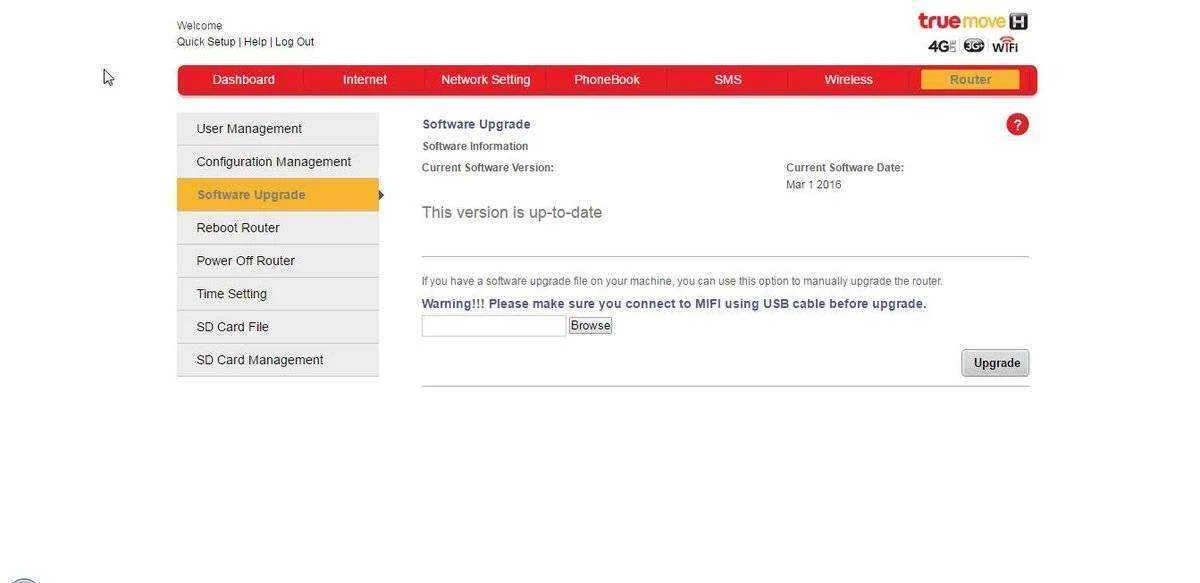

boss Argotron may way ba para sa error na SendPreamble failed in GetDeviceBootType? baka pwedeng solution kaya yung ganitong paraan kung mag software uprade? kaso di ko ma gets ung
"Warning!!! Please make sure you connect to MIFI using USB cable before upgrade." baka may idea ka boss yan ba ung gagamitin ung MIFITOOL? kung yan nga un pano ba tamang paggamit nyan baka pwedeng solusyon ito sa mga nag ka error na SendPreamble failed in GetDeviceBootType
pa check nalang boss ng image
