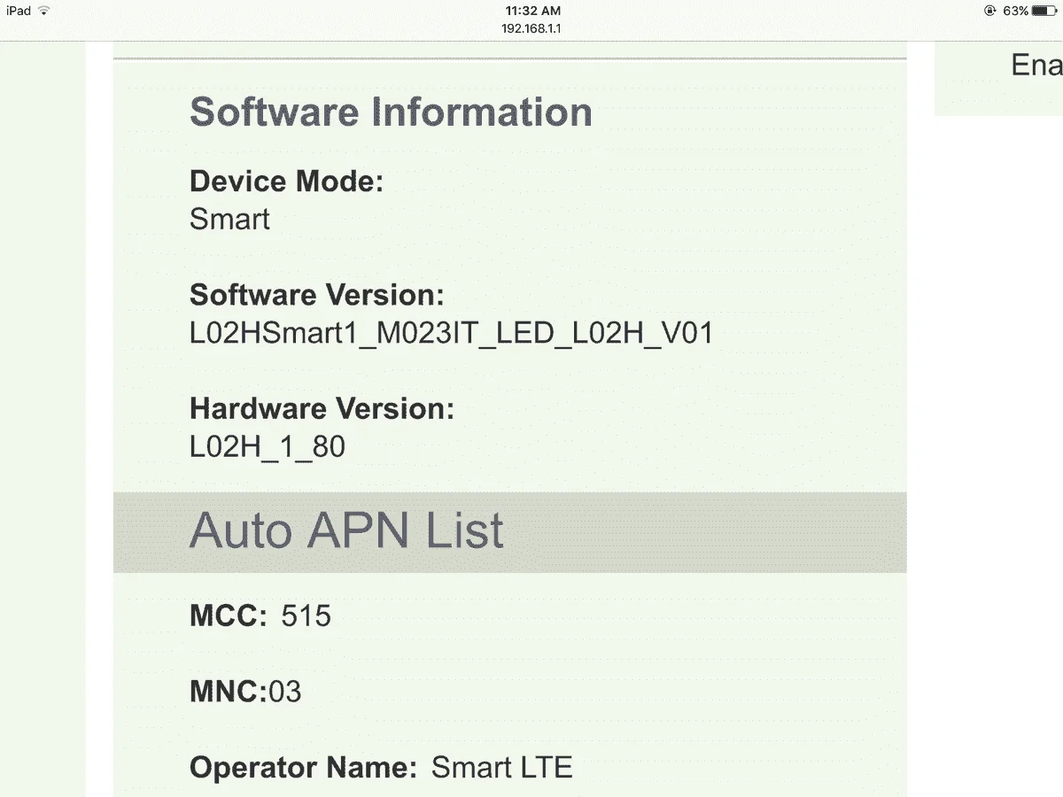

Flashed with firmware from page 1 but unable to connect to Smart LTE only 4G-HSPA+.
Manual search shows 3G and LTE for Globe but only 3G for Smart.
Flashed with firmware SmartBro_EVOLUZN_FXPR2_LTE_POCKET_WIFI_OPENLINE_FIRMWARE_12.22.16
Same problem.
Board version on circuit board: L02E_1_81.
Software information now displayed on interface on attached file:fzpr2 current sw ver.webp

Maybe it depends on your location, can it detect LTE or signal before flashing the firmware?

Was able to detect and connect to Smart LTE in current location before firmware update.
Can detect/connect to Smart LTE in current location using another LTE router and same/different SIM.
This seems to be related to poor signal strength. Moved modem outside and high and was able to get LTE connection. Getting much slower speed out of router with updated firmware though, with both 3G and LTE connection.
