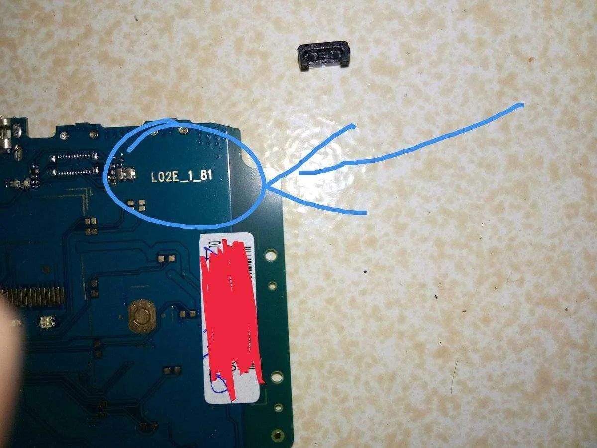

update ni try ko iopen yng pocket wifi eto hardware version

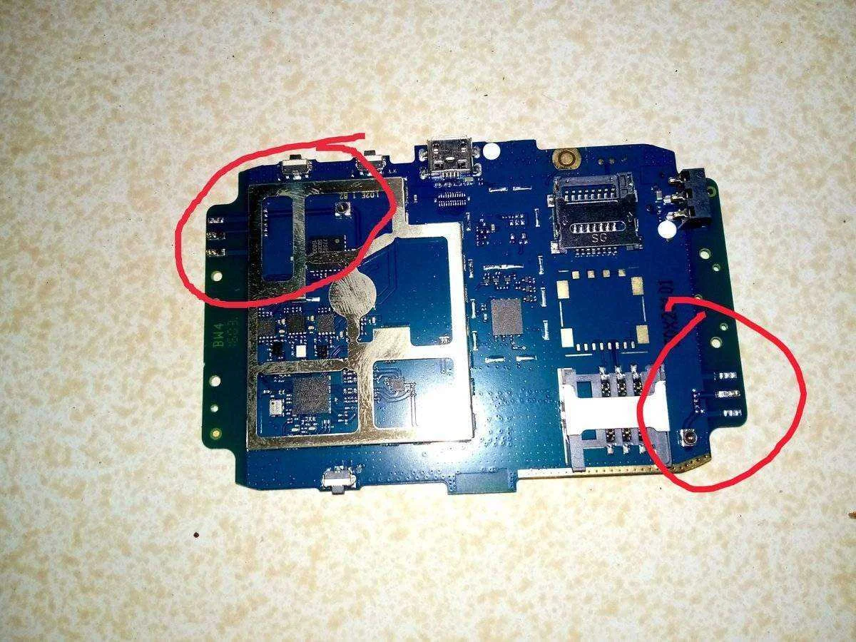

boss baka may idea ka san kaya banda dyan pwede ihinang para kabitan ng antenna?
di ko sure idol pero sa tingin ko either sa dalawa na yan ,,,,isa dyaan is wifi ,,isa naman sa cellular data pero di ko alam saan dyaan yng cellular antenna at wifi basta yang dalawa ang palagay ko idol

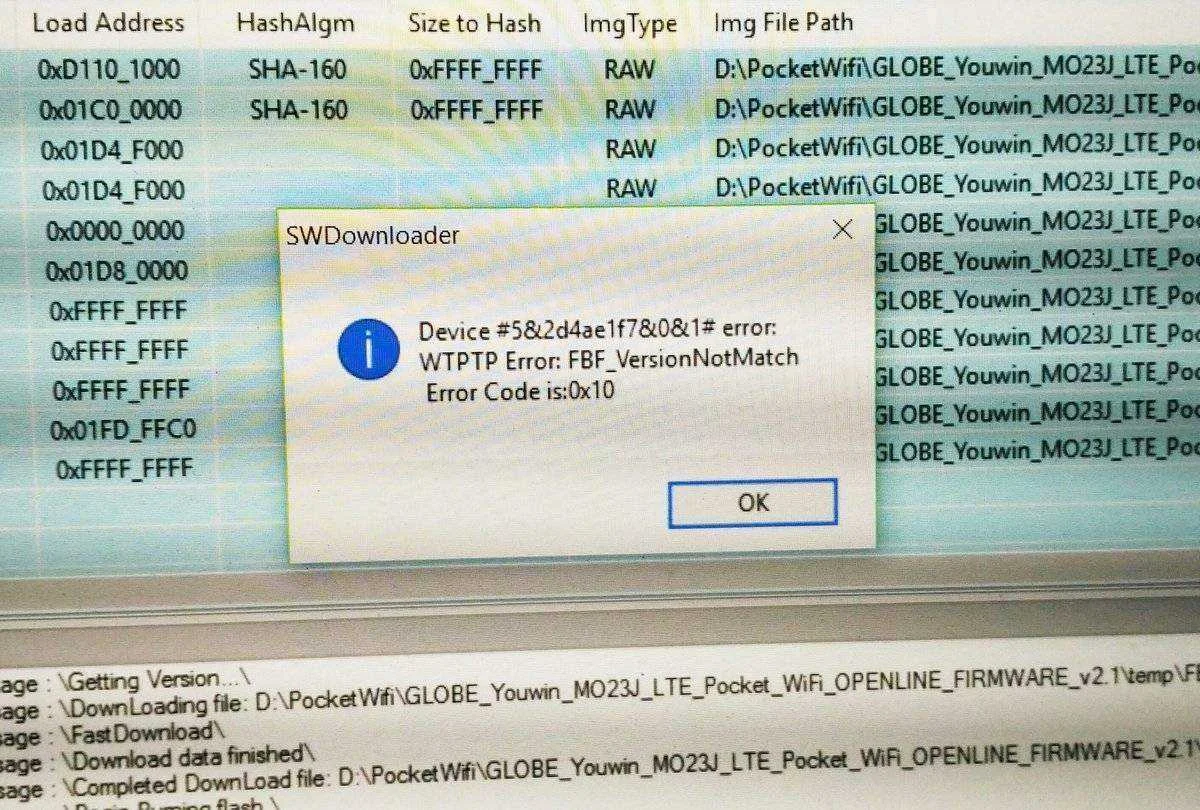

Meron ako PR2L and youwin. May error po pag flash ko. Tried on several other PCs same parin. WTPTP ERROR. FBF_VersionNotMatch.

Yup, already installed that na. Still the same error. Lahat ng FW error sakin except for one, yung uganda fw walang error pag flash ko. Kaso locked yun sa telco dun.

L02C, hmmm the firmwares that linked here are only for L02D and L02E only. L02C's firmware is also available, but you know I don't want to take the trouble in porting it and work individually for each board ver. as you can see there are barely liking this post in contrast to the number of downloads, made me feel a little discouraged. So I'm sorry I won't be able to help you, its not like I get ρáíd or get credit or simple thanks for keeping in check with lots of guys doing this tutorial. So I'll stop doing this kind of thing. Let's just hope that someone will have the time or the will to continue helping this guys problems. I'm really sorry, try asking totoymola11 for help..
