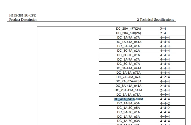

pwede naman 2CA sa 5G kahit NSA, it can be seen from the spec sheet, kailangan lng tlga ka kayanin or iadvertise ng cell site na supported ang ganyang combo, for example ito H155 kaya 4G B41 + 5G N41 + 5G N78
yes nakita ko din yan pero i don't know sa smart kung supported ng tower yan basta pinaka safe na 2CA sa SA talaga.

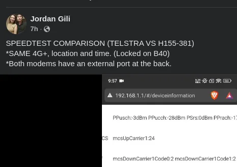

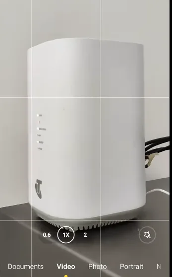

Telstra Arcadyan AW1000 vs Zowee H155-382 on 4G 2CA B40+B40 same band latched, one is 11k, the other is 1.5k, saan pa ba kayo?
Malakas 382 dyan kasi may external antenna naka 4x4 ang arcadyan wala syang nilagay na external antenna. Nasa upper part ng modem ang antenna port ng arcadyan kay very clear na naka buit in antenna lang.
nopes, as per original poster, kayo na mag husga, also why would someone do such a very unfair comparison after all the efforts to mod and test both devices?? doesn't make sense unless hoarder cya, which i don't think so since afford na afford nya telstra modem
also screenshot meron antenna naka kabit
Di nya pinakita likod ng arcadyan na may nakalagay na external antenna unlike s 382. Alam ko internals ng arcadyan mas solid yan at mabigat.
Na bend ang 2 antenna nya papunta sa 382 nasa taas ang external antenna port nag telstra unless na mod nya yan dapat pinakita nya. May telstra din ako kaya alam ko saan antenna port niya unless naglagay sya sa ilalim nyan. Dapat pinakita nya
