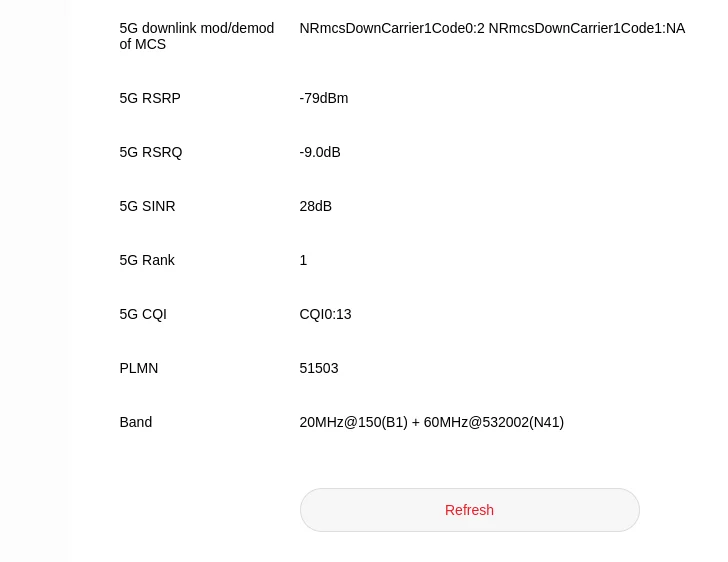

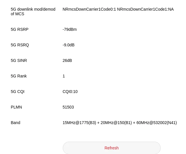

pero so far itong H155 ko, walang patayan 2 days na, di bumibitiw ang 5G signal, also from 3CA, biglang nag 2CA nlng signal ko, mukhang peak hours this hour in my area, normally this is B1 + B3 + N41, goods pa rin naman 300mbps speed test, ung 5G N41 lang ata bumubuhat sa speeds neto..
^yung 381 ko naman (B3+B28+N41), nagiging B1+B3+N41 pag nilock ko lang yung B1 lang.
di ko pa nakita na isang band lang yung kasamang 4G ng N41.
the same Band combo?
waiting nlng sa 381 ko para ma compare ko, ipopost ko with video and device info.. mukhang matagal pa deliver kc sa Smart Website ako ng order, ung mas mahina gawin kong WiFi 6 repeater/access point
i tested again seems like, parang dynamic ang CA netong H155, if more speed is needed (like during speed tests or heavy downloads) bumabalik cya sa 3CA, pag idle lang, 2CA ulit, i think it's a power saving feature of this modem.. if more speed is needed it will try to latch unto more bands, consistent sa H153 review ni Jerome Laliag

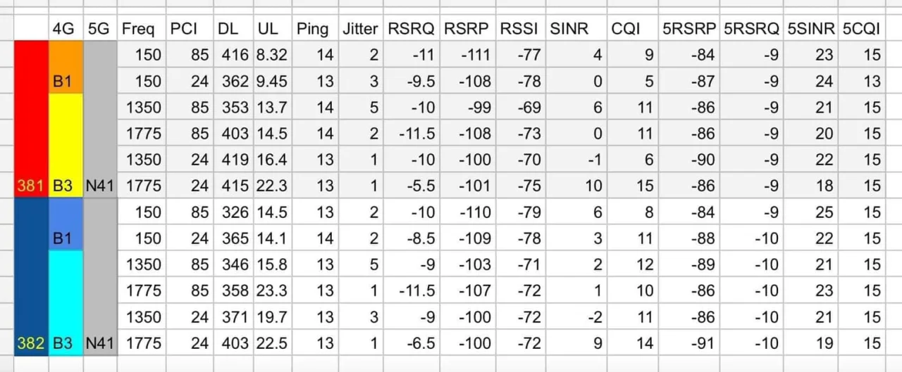

ayownn may comparison na lumabas ulit, same location, same placement ng modem... with speedtest pa

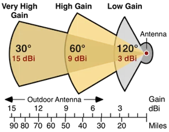

also i think mas mababa tlga ang reading sa raw signal ni H155 for some scenarios, higher dbi antennas = more directional hatak, lower dbi = wider coverage... (you can look it up or ask Copilot/ᑕᕼᗩTGᑭT on the pros and cons of higher dbi antennas)
Higher dBi = if malayo ka sa tower
Lower dBi = if marami napaplibutan ka ng tower
to me slight lng tlga and difference except the 5CA + 3CA thing in 4G+ only locations.. at to test na rin ito stability if sino ang hindi need ng restart at di bumibitaw sa signal after heavy usage

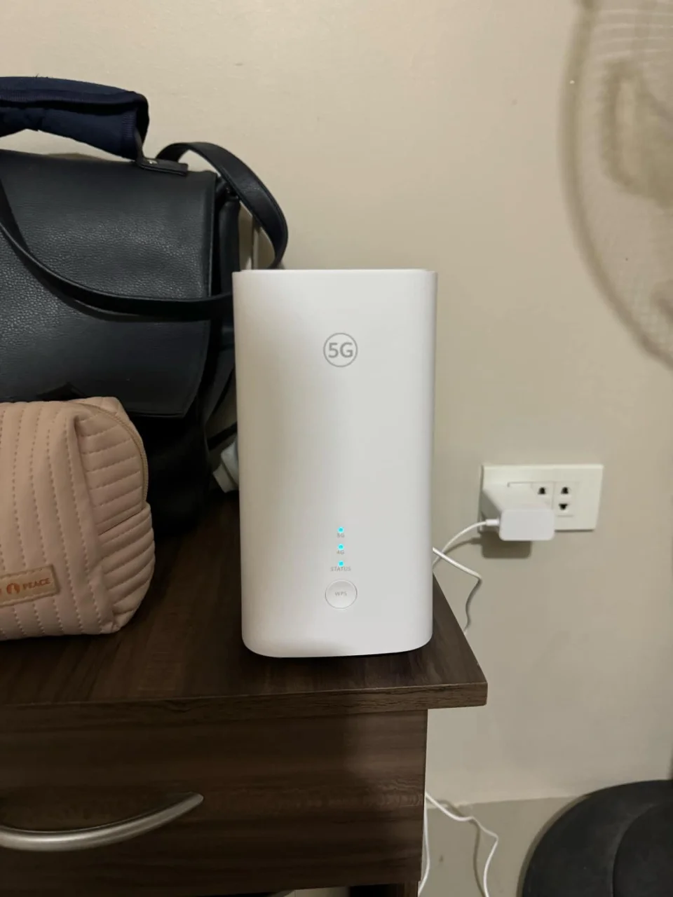

Btw, here my review guys, medyo late lang nagjoin here sa forum.
Thanks sa review and effort nyo po, pero after reading ung connection drop issue sa iOS, i resell ko ung H153 ko asap na sealed para di mag de value... na trauma na kc ako sa VN007 auto reboot, Suncomm cable unplugged issue, ZTE F50 overheating at ibat iba pang high end modems na may connection issue...
Let's say mas angat nga ung isa sa speed, but I will forgo the opportunity to defend H155-382 and leave it up to other more senior reviewers to decide based on the previous speed test samples submitted (shimenet lng lol :ROFLMAO:) for the sake of stability, useless ang speed sa akin kung na drodrop naman ang connection..

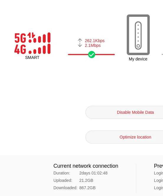

I'm contented and satisfied with 2 days uptime, 800+gb data usage wantusawa walang patayan, "no disable/enable mobile data refresh pra lang umokay ang net" sa H155-382. Further enquires, shimenet lng isasagot ko haha...

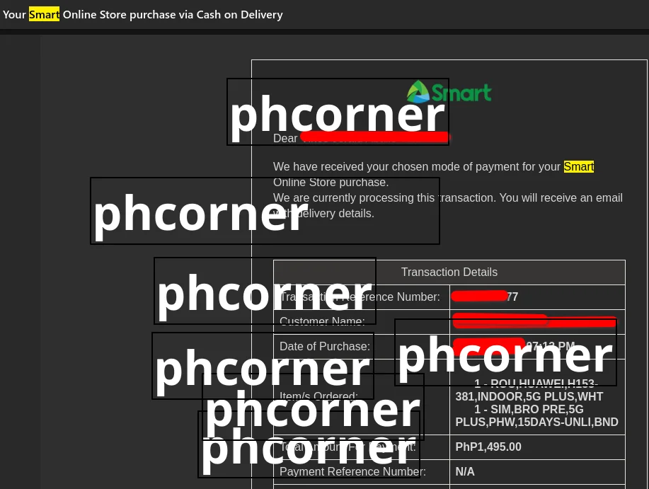

also baka sabihin ng iba gawa2 lng, proof na nag order tlga ako ng H153-381 direct from smart website

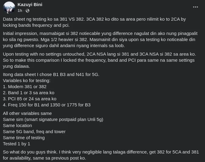

Exactly bossing, same tots, actually kaya napagawa ako ng account dito sa ph corner kase apaka tagal maapprove ng post ko sa kabila, actually dapat separate post yung testsheet pero hindi kase mabilis magapprove or may pinagtatakpan ata? 🤣 (shimenet like my review) emz. So ang ginawa ko inedit konalang yung previous post, pati nga yung first post ko nayun antagal din bago maapprove dami na tuloy naglabasan na fake news about 382 kesyo ganito kesyo ganon. E hindi naman valid yung comparison since, different tower, different band, different frequency yung test lol. Meron panga don yung mga ***** na nagpost ng 1gbps speed pero pag tinanong mo device info wala na maisagot e. Modem natural pipiliin higher CA and higher signal values kaya nga nauso band freq and pci lock e, para sa mga cases na ganito, tas sabihin ng mga butthurt kesyo 500 mbps lang 382 ko 900 mbps 381, baka naman kase congested yung isang band? D nagiisip e
Same sentiments tayo na aanhin mo yung extra 50 mbps and extra 5% better signal, on paper lang naman yan e real world d na pansin yan. Kaya gusto ko 382 mukhang quality built, mabigat, madami internals, hindi tinipid, walang issue kahit magdamag or nakapagdl na ng almost 1 terabyte, 5CA for future proofing dba?

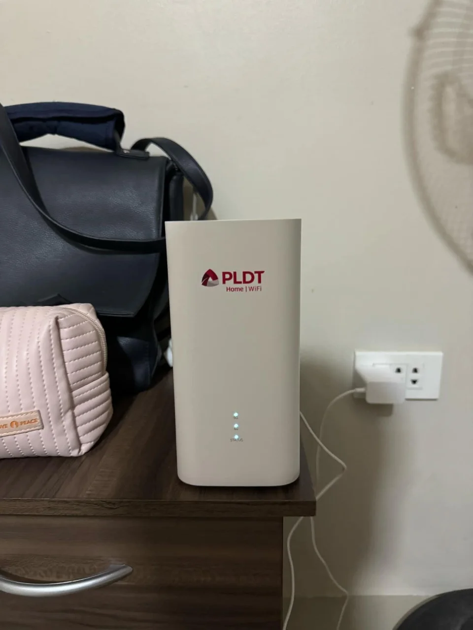

good morning H153 users, may i ask if ganito din ang Dashboard nyo? Merong USSD, IMS & Voip settings? Wala kc sa akin sa H155..
Or meron na naka pa superadmin nito?
here's H155 pldthome user for comparison
Onga sir no, wala akong gabyang settings sa 381 ko. Pano mo naaccess yan paps
ahh okay, akala ko exclusive sa H153... nakita ko lang sa GC ng mga master na nag uunlock ng modem... niluluto pa cguro nila ung superadmin/unlock neto kaya di pa pinalabas...
