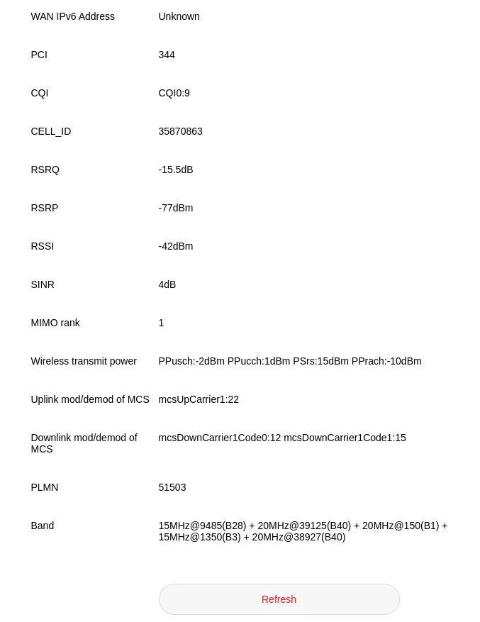

Yeah about that 5CA, pde sa area ko if I lock it to B28, but 5G won't work anymore, ... i'll just try one time kasi ubos ung Extra 4G sa promo ko lol, feel ko pde pa ito more CA with B28, it's just that mahina tlga B28 from where this modem is situated.. and when setting the mode to 4G Only Auto no band lock, the modem tends to avoid having CA combinations na may B28, mahina 4G+ tlga dito kahit 5CA (due to prevalence of mamba piso wifi probably)
This 5CA combo can only be done if na force lock to B28

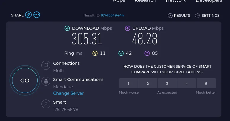

4G 5CA Speedtest (B28 + B40 + B1 + B3 + B40)
5G 3CA (B1 + B3 + n41) can reach upto 400mbps during non-peak hours

lock b28 sa setting = B28 + B40 + B1 + B3 + B40 nakalatch
more testing pa to come... mahina tlga lang B28 sa area ko kaya ayaw mag auto sa 28, kailangan pa ilock..

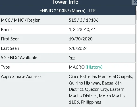

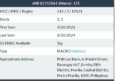

lumilipat dun sa mahinang tower boss kaya sana gusto ko ma lock cya dun sa tower na may 5GENDC
bakit samin may 5g signal pero wala sa cellmapper...hindi updated?
4g lang ata sir yung sa cellmapper wala rin lumlabas sakin pag 5G nung na click ko lang yan napansin ko may nakalagay samantalang sa nakaconnect ako towerwala
eto dalawa tower nasamin malapit boss

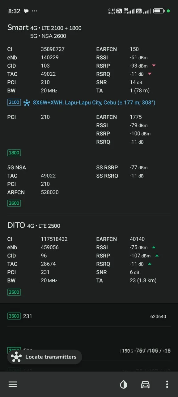

Oonga boss question naman sa mga master paano malaman pci at frequency ng 5g bands, yung settings ko 4g lang naka pci freq at band lock e pero sa 5g band lock lang kase clueless ako san kukunin yung values pag 5g
