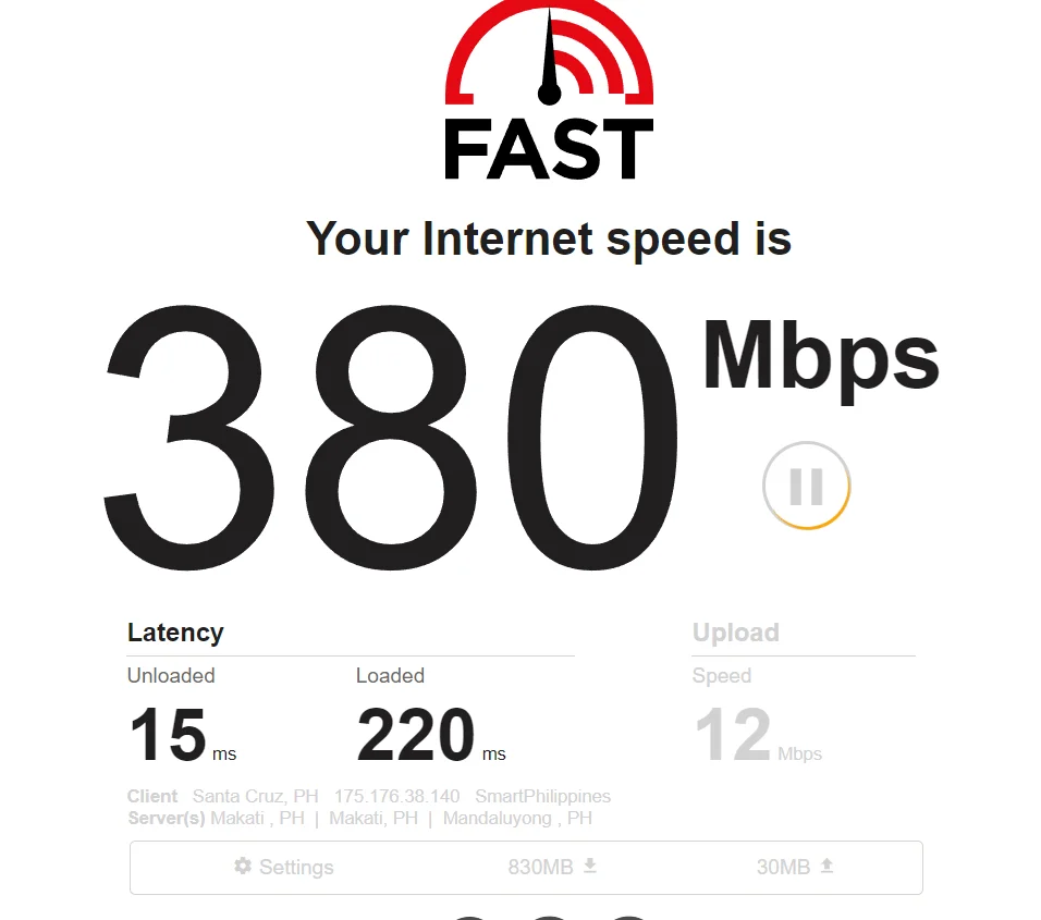

nakabili ako nyan online may free 15days unli internet po, tapos pag naubos unli fam po ang iloload 1299 po ang price mas sulit eto parang libre lang yung modem kesa bumili ng 5g modem alone. 200mbps to 400+ ang speedtest sa fast.coom

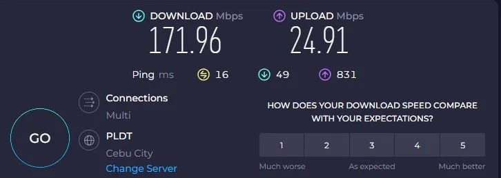

Take Note: newifi d2 router ako connected sa wifi yan kaya mababa speed.di ako connected direct sa modem

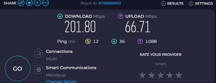

Confirm supported 5CA LTE but yung b28 sa 5G ayaw gumana pag nag set ako b1+b28+n41 ang lalabas is B1+B3+N41, bug ata to sa 382.

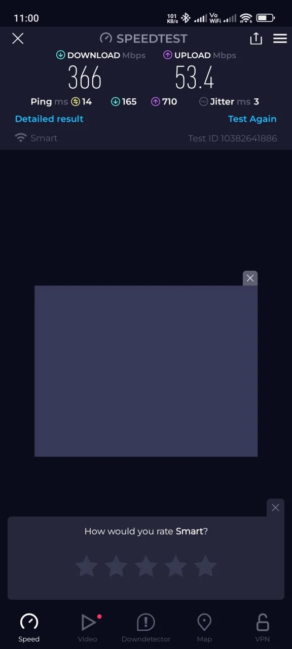

your 5G signal stats are actually VERY good, i would estimate less than a KM ka sa pina ka malapit na cellsite, you should try using LAN cable, or a WiFi 6 device, i think this will go upto 400-500mbps, it won't matter na cguro if you cant do B28.. your bottleneck is no longer your internet, but your WiFi devices

nag try ako cp din direct wifi ng modem umabot 300Mbps. near Mactan Newtown address ko
