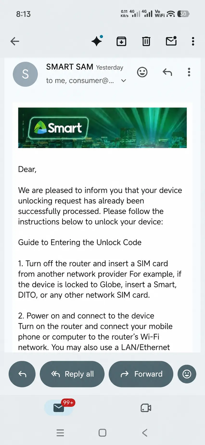

Hi ka-PHC! Good morning sainyo, share ko lang sainyo to kung paano ko na unlock Modem ko through Email.
1. Need Receipt Paper or kahit yung sa Shopee.
2. Need Details ng Modem.
3. Email ni Smart: sam@smart.com.ph
CC nyo kay NTC consumer consumer@ntc.gov.ph
Attach nyo nalang yung Receipt nyo, then serial number ng modem kasama pic ng modem.
Good day!
I would like to request the unlocking code for my PLDT Home WiFi H153-381. I purchased the device from a Shopee reseller because the official PLDT Shopee Mall was out of stock during peak demand. I only have the receipt or e-invoice provided by Shopee.
Device Details:
Model: H153-381
IMEI:
MAC Address:
Serial Number:
ICCID:
I hope for your kind assistance with this request. Thank you for your time and consideration.

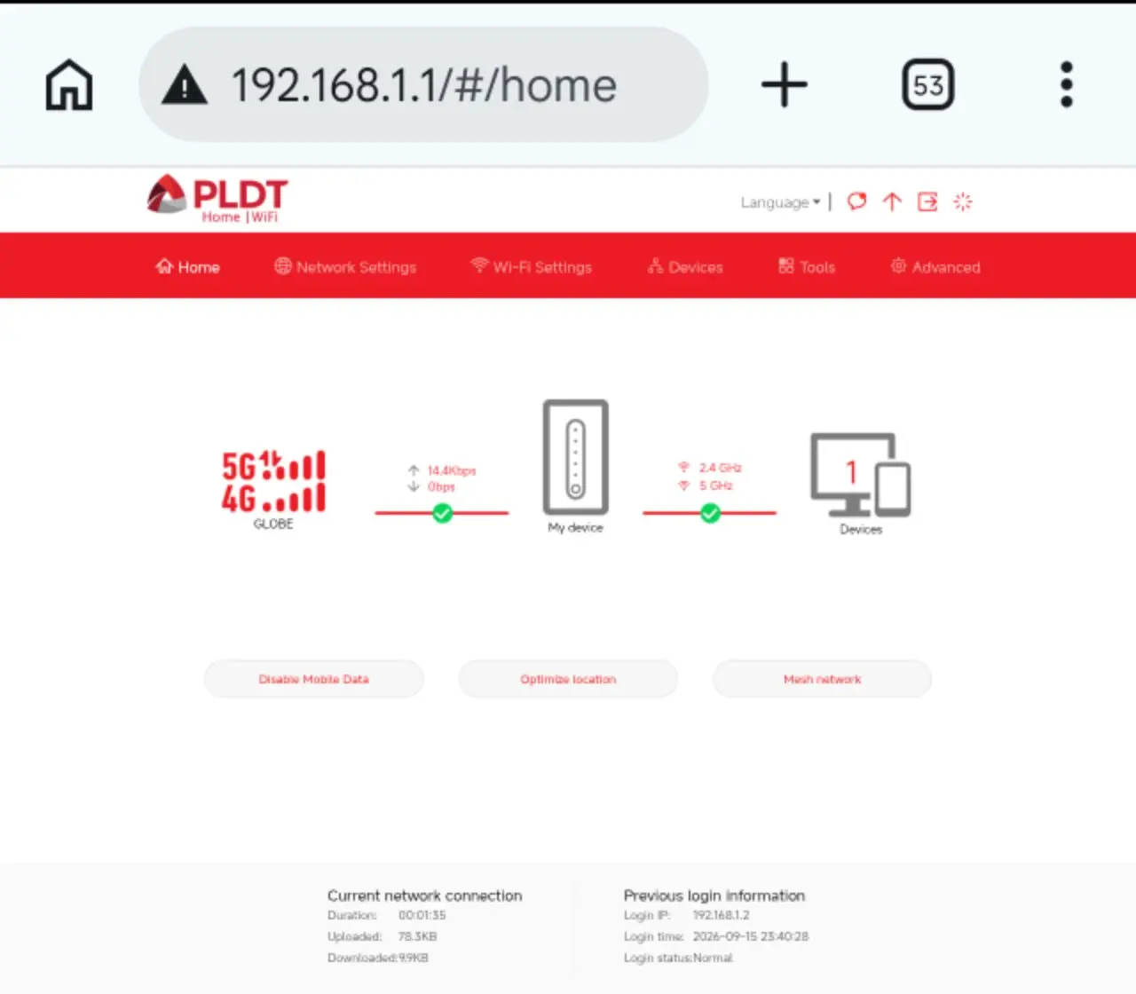

Bago nag reply sakin ng ganyan nag bigay na unlock code then sa pinaka baba may 2 option click no or yes if na resolve raw ba, then pag click ko yes ayan yung lumabas

Walang automated sakin boss nung una, mag nag reply agad si Ms. Leah eto marami akong nakikitang good feedback sakanya.
Then after 4days dun ako naka receive ng bot, tas nag follow up lang ako ulit tas mga 2-5 days may code na
