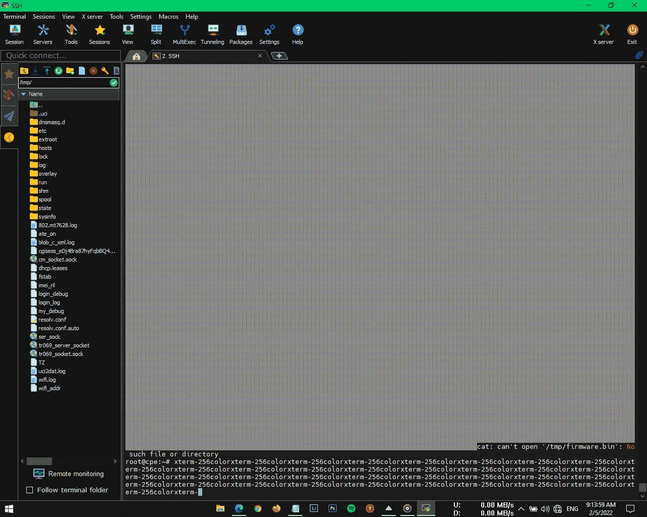

Boss, Wala kasi mtd0 sa file na binigay mo... Anyways, check ko muna ..
Pano ba kunin hahaha
Eto lang ung command Lods
Pang backup mtd0 to tmp
cat /proc/mtd muna then press enter
backup mtd0 to tmp folder
cat /dev/mtd0 /tmp/firmware.bin
Kung sa pc mo gawin winscp pandukot mtd0

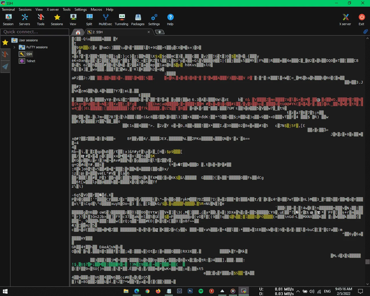

MobaXterm nalang ginamit ko mas madali, itong command na to
cat /dev/mtd0 /tmp/firmware.bin nag lalabasan yong mga iba't ibang char. tapos nag failed to open hahaha
Ah baka d kasya Lods, hahha GG PALA haha
Download mo na lang magiging compressed in .gz file lahat yan sa mobaxterm
