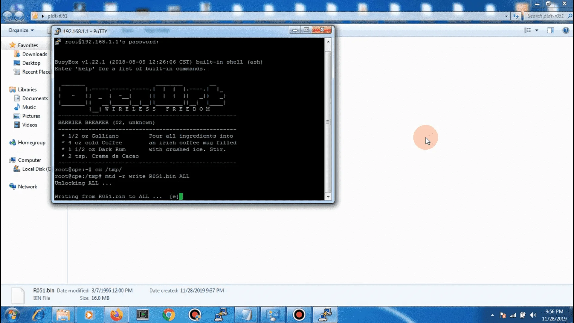

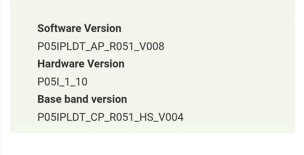

Permanent unlock yan Lods, unli reset unlock v008 baseband 4 sa r051 perfect block din updates
Pano pag upgrade naman? V8 to V10.1? ganitong command din? mtdwrite -r /tmp/r051_V008.bin /dev/mtd7 pero anong bin dun sa binigay mong file?
Mga boss nu po paraan para madowngrade ung v10 to v008? Salamat in advance

Uu Lods, pero dapat full backup mo muna firmware mo
Ung mtd0, dapat malagay mo sa tmp folder, matapos mabackup mo sa phone storage or pc, storage. Para pwede mo full restore ung v008 baseband 4
Export ko lang ba mga laman ng tmp?
Pang backup mtd0, mtd4
cat /proc/mtd muna then press enter
backup mtd0 to tmp folder
cat /dev/mtd0 /tmp/firmware.bin
Then gagamit winscp kung sa pc andftp kung sa android smartphone, para mabackup sa storage at makuha ung nasa tmp folder
Parang ganito un
Sample ssh command backup firmware2-mtd7 to tmp folder then flash to firmware1-mtd4
cat /proc/mtd mo muna.
Firmware 2 mtd7 firmware v42 downgrade to v41
cat /dev/mtd7 > /tmp/firmware.bin
Kapag natapos,
mtd -r write /tmp/firmware.bin /dev/mtd4
Parang ganito un
Kapag natapos,
