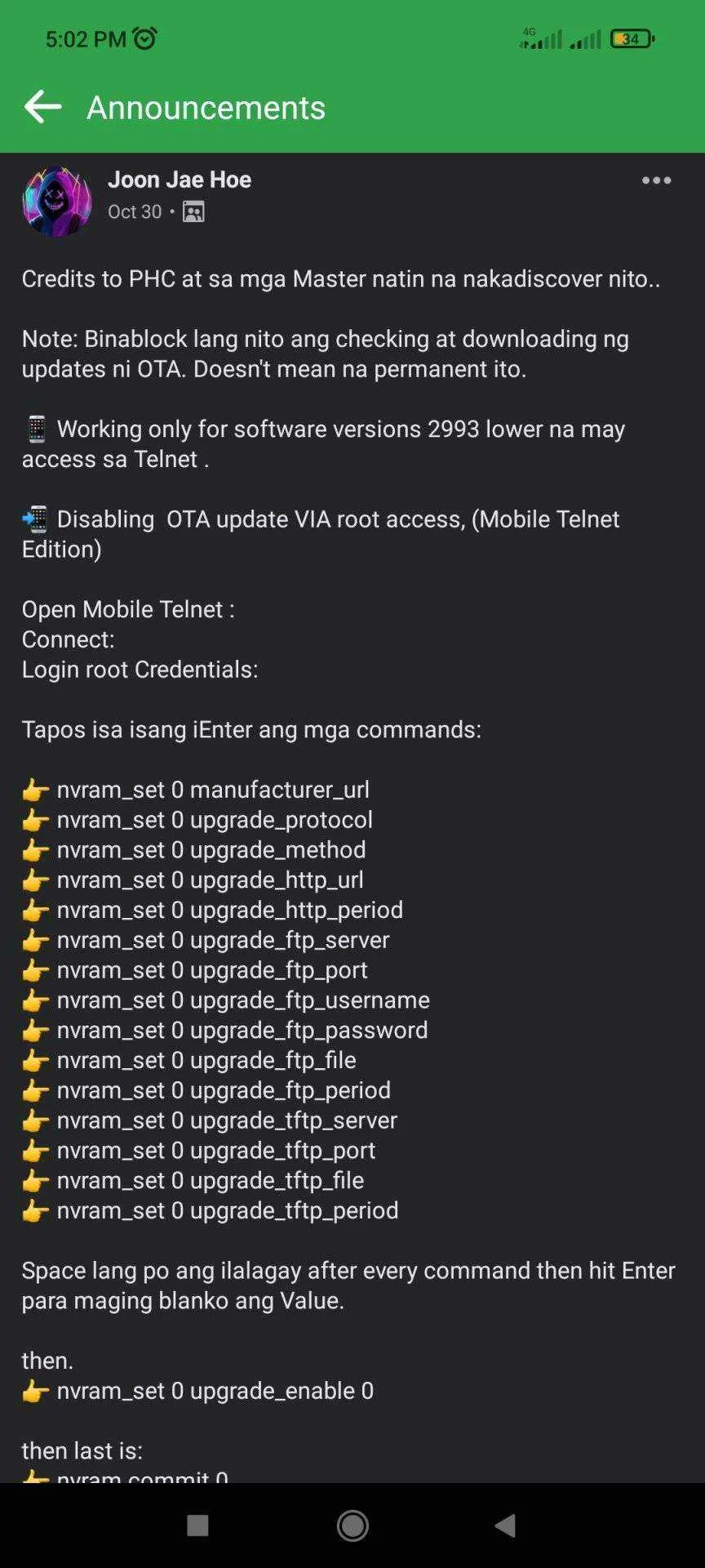

Additional question, pwede ko ba gawin itong tut mo na to to block OTA auto update, pwede ko ba gawin pareho kasama itong script na to na galing sa fb page ng d2k?
Kahit yung sa pic na gawin mo pwede na yan
Ung sa screenshot na inupload ko sir?

Hindi ko na ba kailangan itong tut ni sir BJnarco?
Kung pwede ba sir, hndi ba sya mag cconflict or ma bbrick ung device?
Or stay nlng ako dito sa inupload ko na screenshot na tutorial.

Kung gagamitin mo yung kay sir bjnarco pwede rin pero iniiba ni smart yung ip address nila. Hindi rin naman yan mag coconflict or ma bibrick device niyo po. Much better gawin niyo po yung sa screenshot dahil via nvram mo na bina block yung OTA updates.

May root access ka naman na, so diretso kana sa pag set ng nvram vars. You only need to set the upgrade_ftp_* nvram vars.

Yes sir may root access na ako. Sinusundan ko ung tuts dun sa fb page kaso unsuccessful eh, may response pa rin pag ping ko ng ota.pldthome.net
Not sure, kc ung tut na un is for android, PC ko gamit ko now, na input ko nman po lahat ng nvram scripts, kaso hndi gumana since na ping ko pa din ung url ng ota update

Unsuccessful sir ung sa nvram ko kc ung sinundan ko na tut is for android and PC po gamit ko now. May instruction dun na mag lalagay ng space every after script sabay enter but nott sure if applicable din sya sa PC
Btw mga sir, gngwa ko ung script habang hindi nka insert yung sim kasi inaalala ko bka bigla nnman mag update habang gngwa ko sya. Tama ba or kailangan nka insert ung sim habang gngwa to?

Clearly you didn't understand the guide you chose to follow. I explained in the guide that if you did the static route, then you will not receive pings from the server. But if you found a way to set a DNS blackhole for the server, then even doing the nvram set vars you will not receive pings from the server.
Setting the the nvram vars alone WILL NOT prevent you from pinging the server. It doesn't work that way.

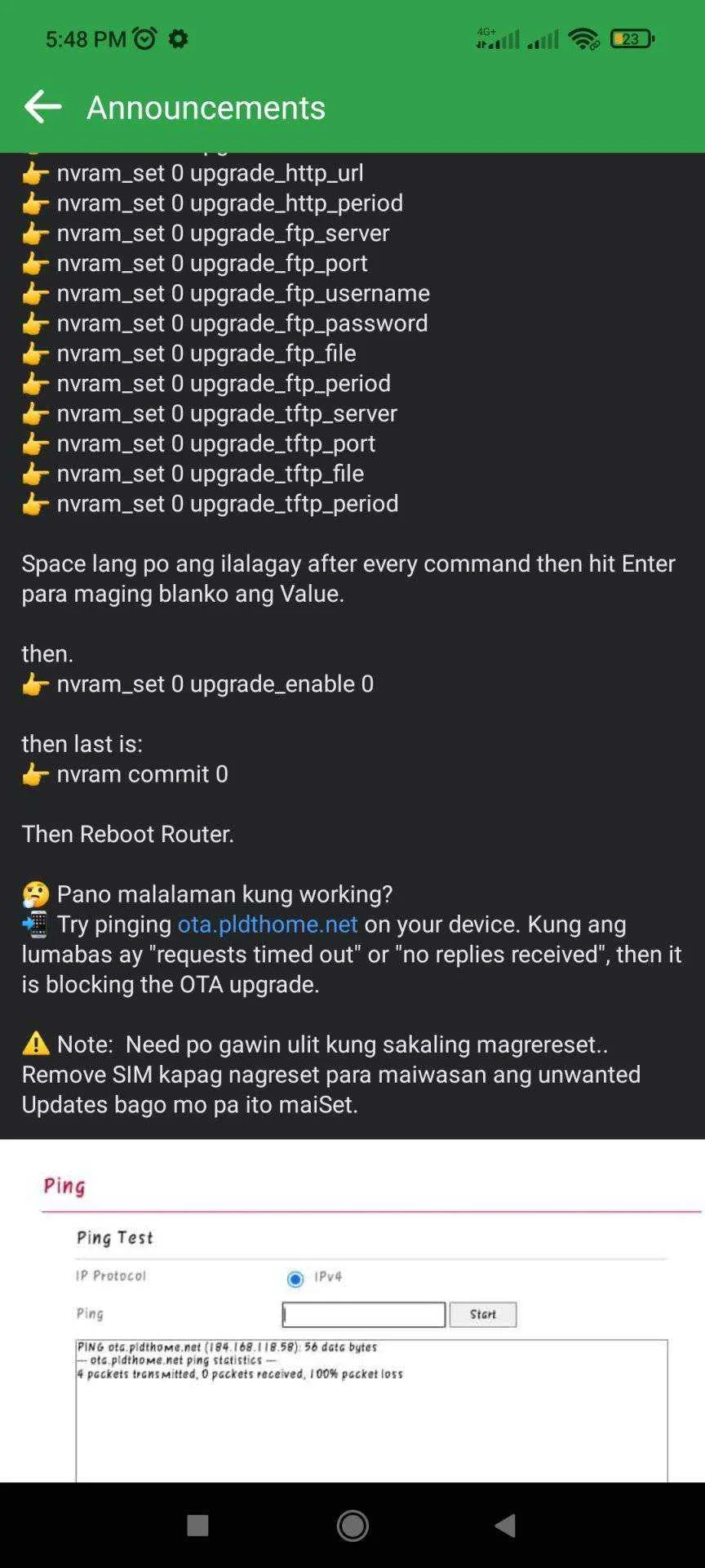

Oh okay sir so mapping pa din si ota kahit gawin itong nvram. Ang sabi po kc dun sa guide na yun is kung gusto mo icheck if successful yung pag input ng nvram script, dpat mag 100% loss yung ping sa ota or RTO.
Ps: hindi ko pa po gngwa ung static route na guide nio sir

I see, yan ang problema sa guide na nabasa mo. Hindi ko nakita yun buong script kung ano ang ginagawa noon, pero kung puro nvram set lang ang nilalaman noon, then mali yun guide na nabasa mo pagdating sa checking.
Yan ang sinasabi ko huwag basta2 gagawa ng mga nababasa lang sa kung saan2. Maaaring hindi makasama yun guide na ganoon pero mali naman ang itinuturo nito.

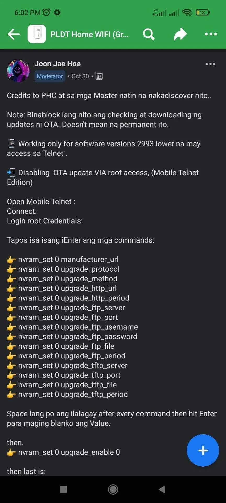

I see sir, pasensya na, sa moderator po kasi ng page ng d2k sa fb ung guide na yun and nka post po sya sa announcement, and credit po nya yun dito din sa phc galing ung source kaya akala ko po working sya according din sa mga nag comment. Hahanap nlng po ako ng guide dito sa phc. Salamat sir
hindi po ba nagwork yung mga nakalagay sa pics? nagwork naman sa akin kaya lang babalik rin once na nireset yung modem. hindi ko lang alam yung importance ng napiping yung bagong ip ni telco, kasi naka disable naman yung update.

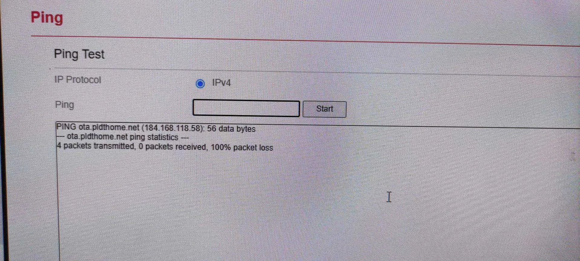

Ito na sya sir after ko gawin ung guide niyo.. 100% loss na sya, so far okay na ba to?
Not sure sir if may effect ung mga nvram na pinag lalalagay ko knina or does it matter pa ba since mukhang nag work ung sa inyo na tuts sa case ko (waiting for your verification if nag work tlga)
hindi ko kasi pinakialaman yan. yung mga upgrage_ftp_ at upgrade_enable 0 lang yung nagalaw ko tapos nvram commit 0. yun kasi yung sinundan ko tapos cell locking at band locking na. kaya lang may times na nagrered yung sim. pinapabayaan ko lang kasi bumalik naman.

Mas mabilis and convenient lng kc pra sken sa FB, besides, dun sa guide kc na yun may credit sya na Tga dito sa PHC yung source nung guide nya and moderator din kc sya ng group so I assume na legit ung guide nya, and as per sa comment section mukhang working nman sa iba ung guide
