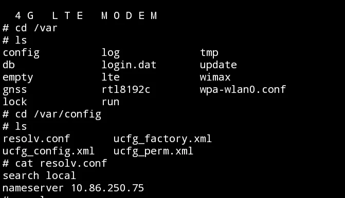

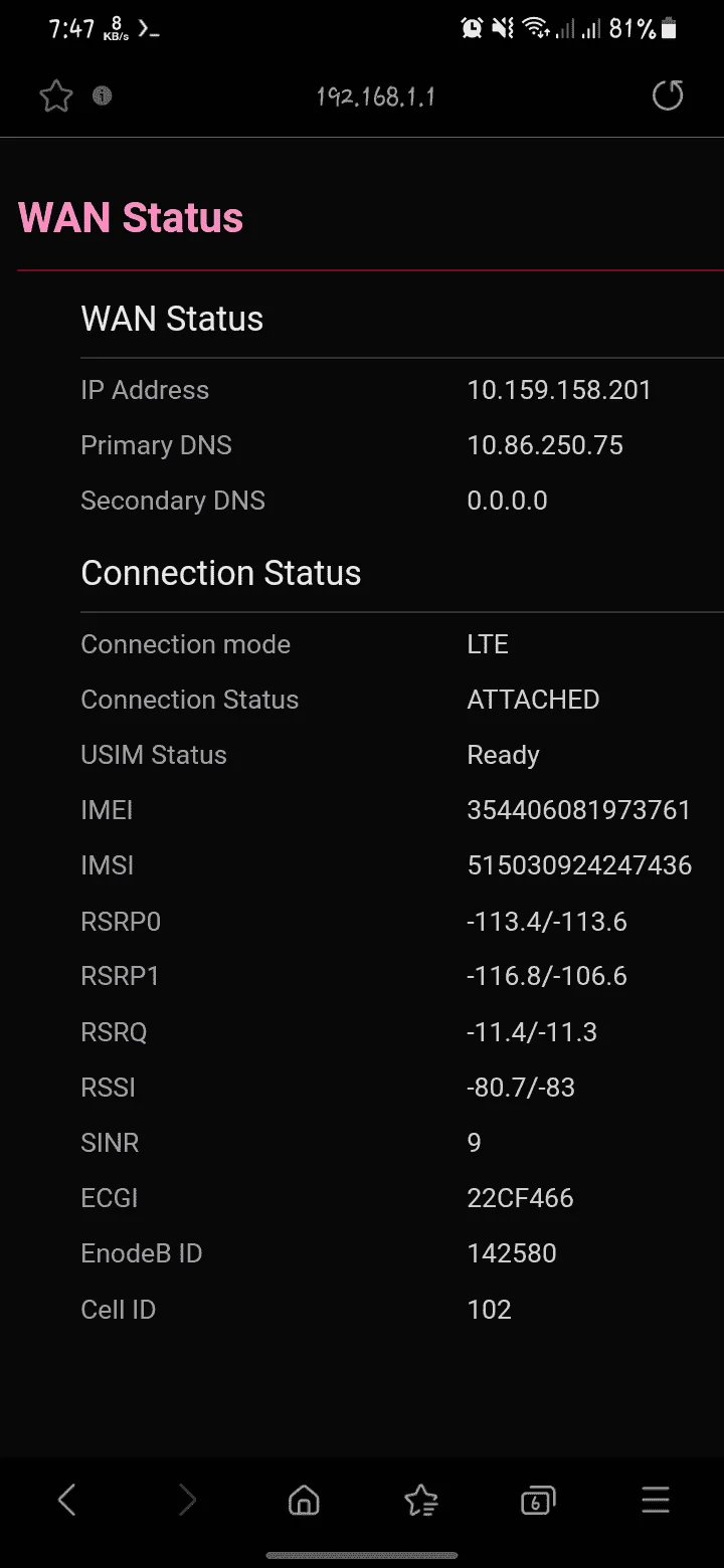

Nasa resolv.conf yung dns ng D2k. Kahit palitan mo jan, hindi yan gagana. The only way na mapalitan yung dns ng d2k is eh edit niyo yung sa loob ng resolve.conf or baka di rin eto gagana dahil mahirap
Regarding changing DNS on this device. It is not as easy as you might think. The nvram vars you find are either used only for display or not used at all.
I'll give you a high level overview, and a hint as well, on how DNS works on this device. There are two steps involved in the DNS setup on this unit. First step is from the modem that gets its upstream DNS servers from the ISP, and the second is the router that takes the servers from the modem and FORCES ALL DNS queries to be sent to these servers TRANSPARENTLY.
So even if, for example, you managed to change the DNS server taken from the modem, there is still the router side that you need to change so that it forces the DNS queries to be sent to the new server and not the one taken from the modem. Also, even if you managed to not not make the router force the upstream DNS or force it to the server of your liking, there is still the modem that will OVERRIDE these changes once it gets disconnected and reconnects again, thereby reapplying the upstream DNS server it gets from the ISP, and instructing the router to force once again the DNS queries to these servers.
Sa madaling salita po, hindi ganoon kadali palitan ang DNS sa unit na ito. At kahit na magpalit pa kayo ng DNS sa mga devices ninyo, ang unit na ito ay binabago ang DNS query ninyo para sa gayon hindi ninyo ito napapansin. Halimbawa nag set kayo sa CP ninyo ng Google DNS server 8.8.8.8, tapos ang ISP DNS server halimbawa ay 1.2.3.4, ang unit na ito hindi ipapadala ang DNS query ninyo sa Google DNS 8.8.8.8, kung hindi sa ISP DNS na 1.2.3.4, at hindi ninyo ito mapapansin. 😉
