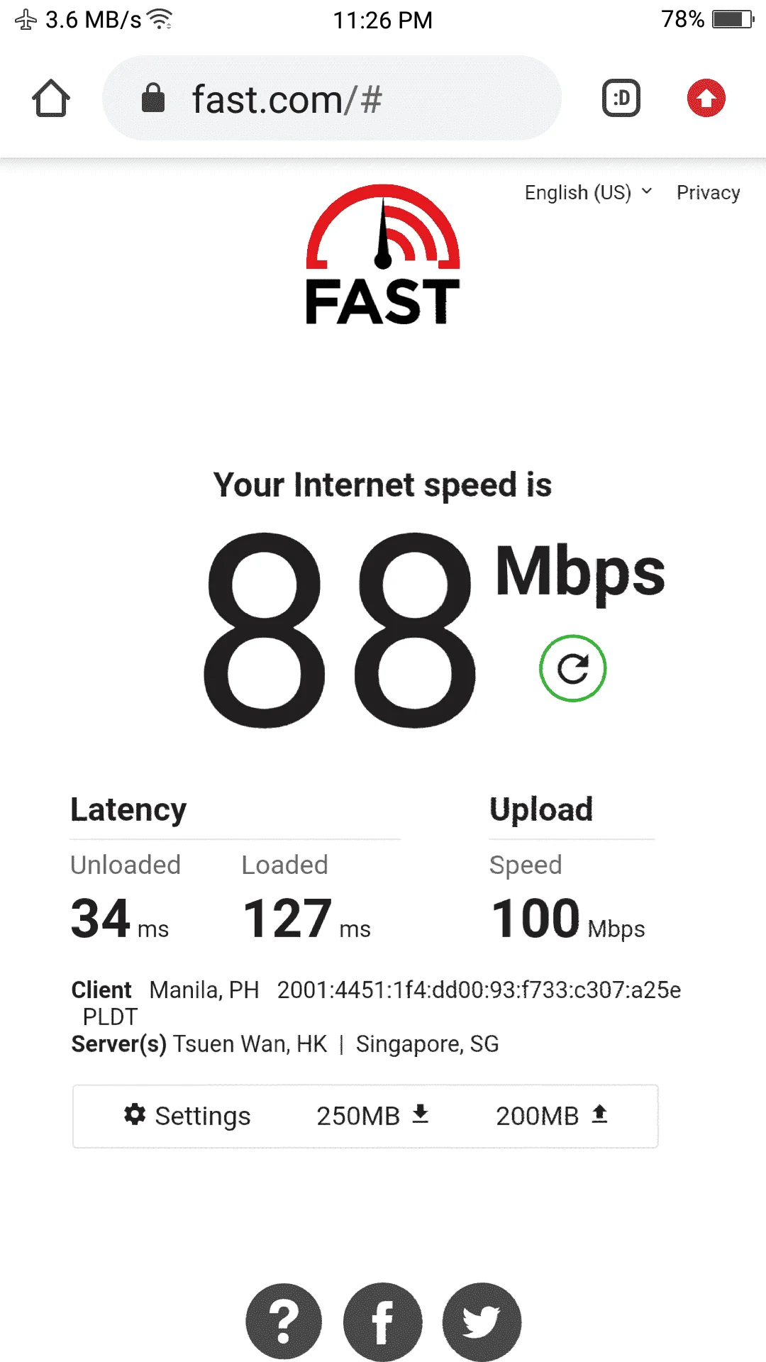

haha. Salamat sa thread na ito at sa mga masters :). Sana gumana ang mga formula at hindi na magupdate pa si R281. Sarap magownload lalo na sa madalling araw. Nakakapanood narin ng 4K videos sa youtube ng walang buffering.
Edit na lahat ng kayang i edit walang hiyang PLDT 🤣 ayaw niya ipagamit product niya.
View attachment 1619875View attachment 1619876View attachment 1619877
Uu nga Lods, Dapat hinahayaan nalang Nila, meron na Clang 5G at Fiber. Yung 4GLte pa pinag-iinitan nila, Lalakas lang naman Lte naka lockband pag malapit sa Cellsite. Yung medyo malalau. Na wala antenna, Mabagal pa rin kahit naka bandlocking
Ok yung pldt fiberlines na pang Goverment, yung kulay Black na Box. Inde masyado Mataas Download Speed pero malakas ang Upload Speed
Plan 1299 +200php Speedboost hidden charged

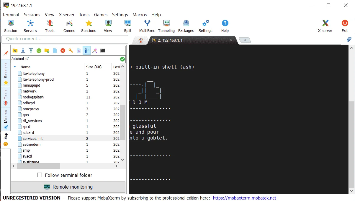

This is actually good news.
This indicates that the software (router) and baseband (lte modem) firmware update comes from openwrt on router (192.168.1.1)
Now, thanks to L E N A R, we have full ssh access to 192.168.1.1, we can disable tr069, ota and fota services and modem and router will no longer be updated.
Code:
To disable OTA, FOTA, TR069 edit /etc/init.d/services.init
comment 3 strings just add # or remove it:
#start_instance 0 "ota" "${PATH_UBIN}"
#start_instance 1 "tr069" "${PATH_UBIN}"**
#add_auto_fota_task**
reboot
check crontab:
cat /etc/crontabs/root
you shouldn't see this line: 0,30 0,1,2 * * * ubus call ota fota_upgrade_trigger_new
also check running process via top or ps you shouldn't see running tr069 or ota service
