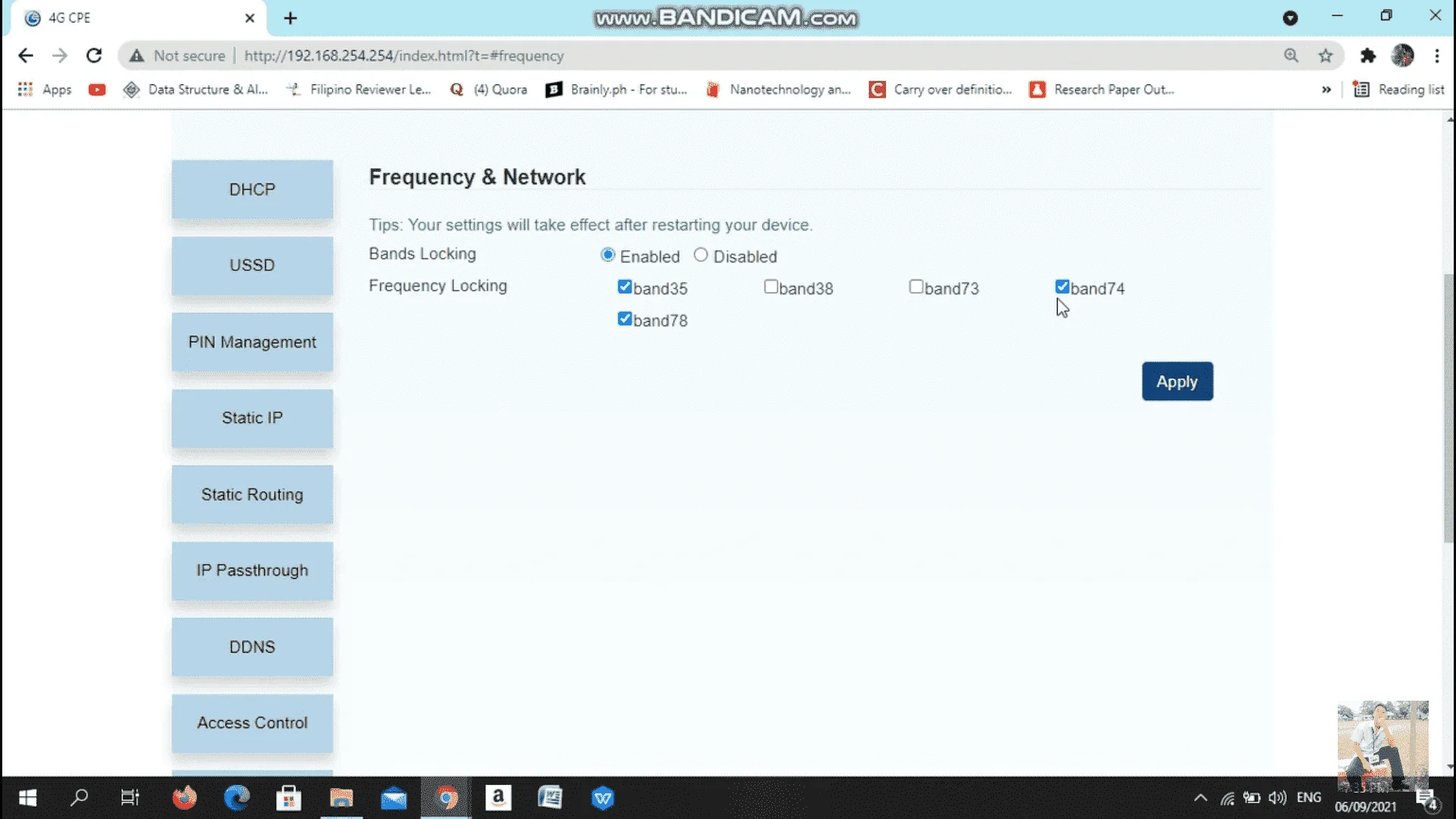

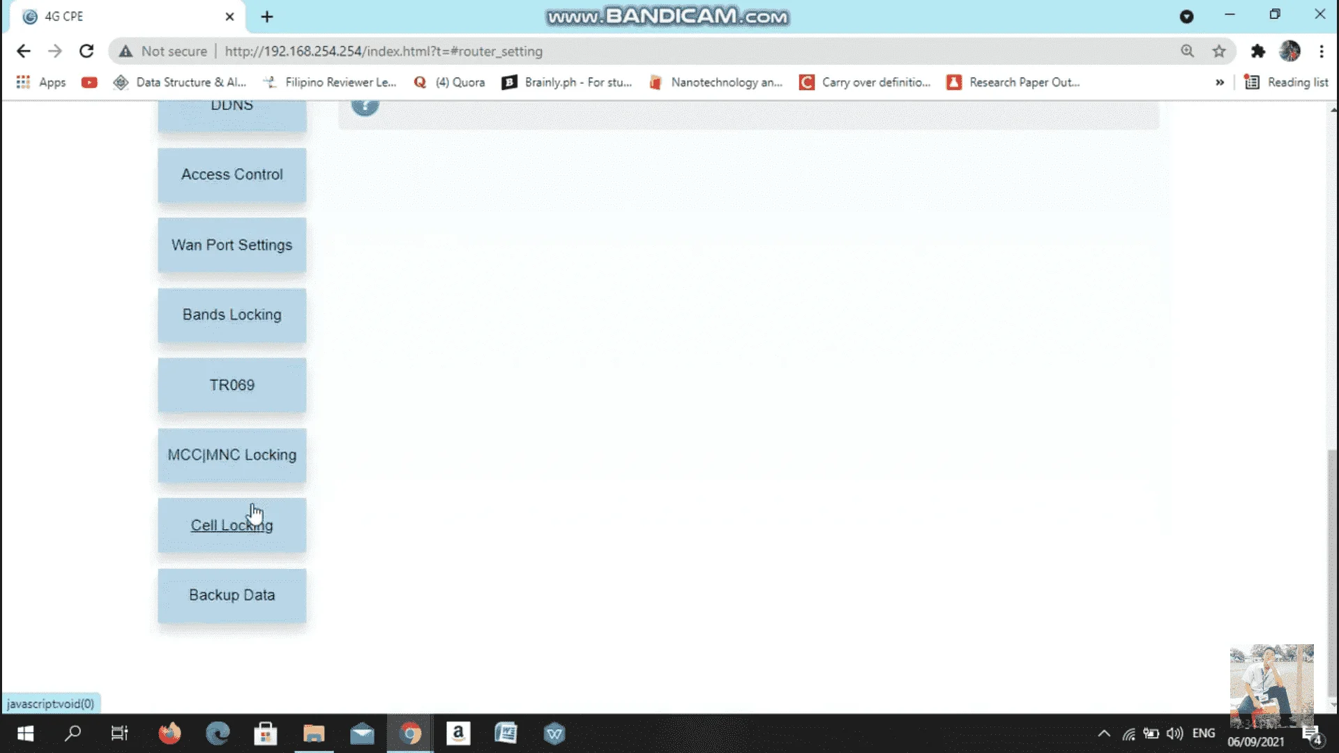

May Bagong Butas din ang ZLT S10G firmware Version 1.1 latest firmware
Pwede muli Bandlocking at Mcc locking for openline
Simple lang pala ginawa ni Globe
Yung SuperAdmin/Advanced Login and Password: admin(user and Pass)
Tapos sa unlocked sa mcc locking idagdag lang yung mcc ni smart 503, ayun BOOM bandlocking At Unlocked click Apply, Syempre need din disable Tr069 at yung remote upgrade kau na bahala mga ka phc
Credit natin dunsa Nakatuklas Nc info

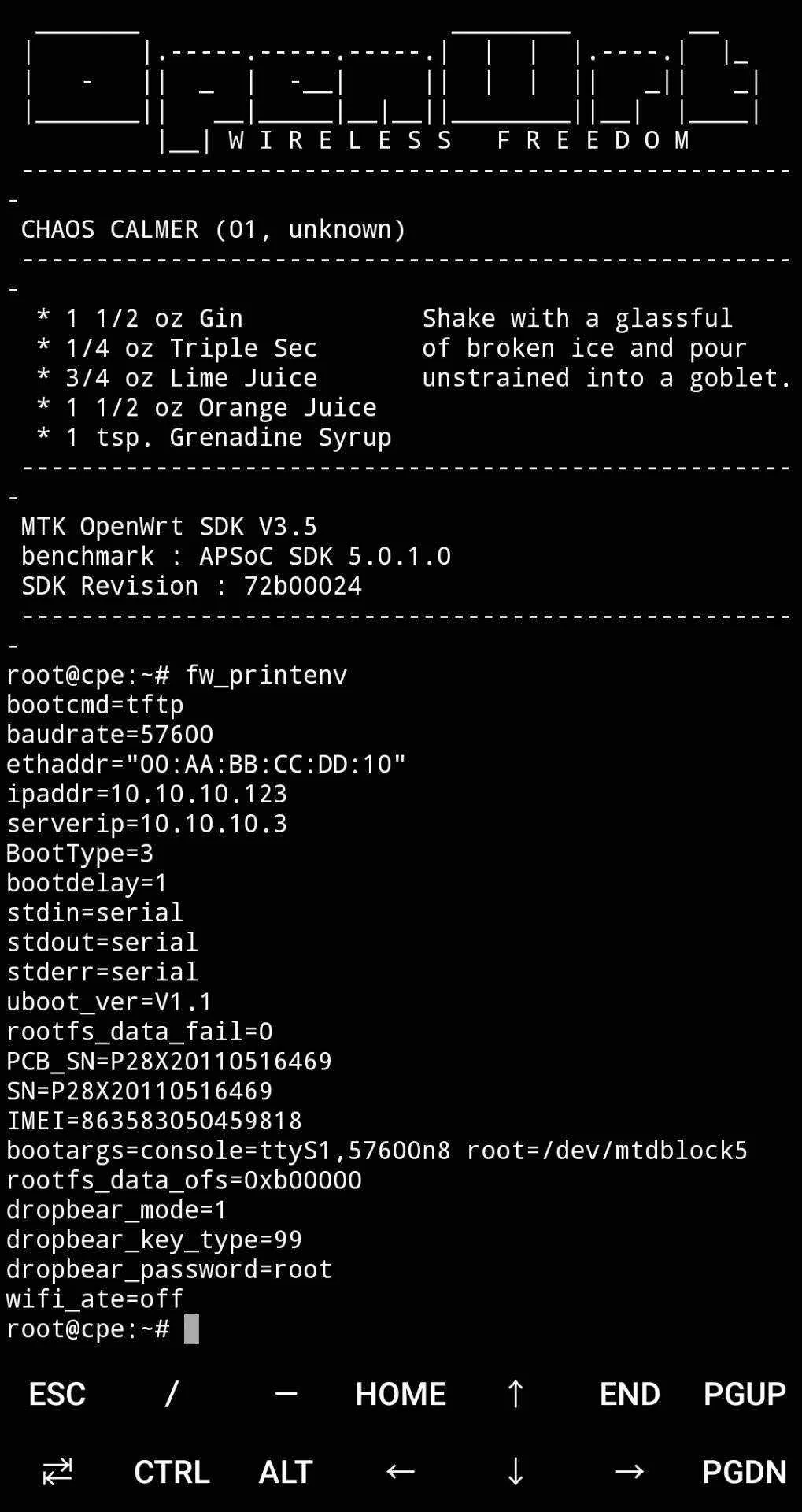

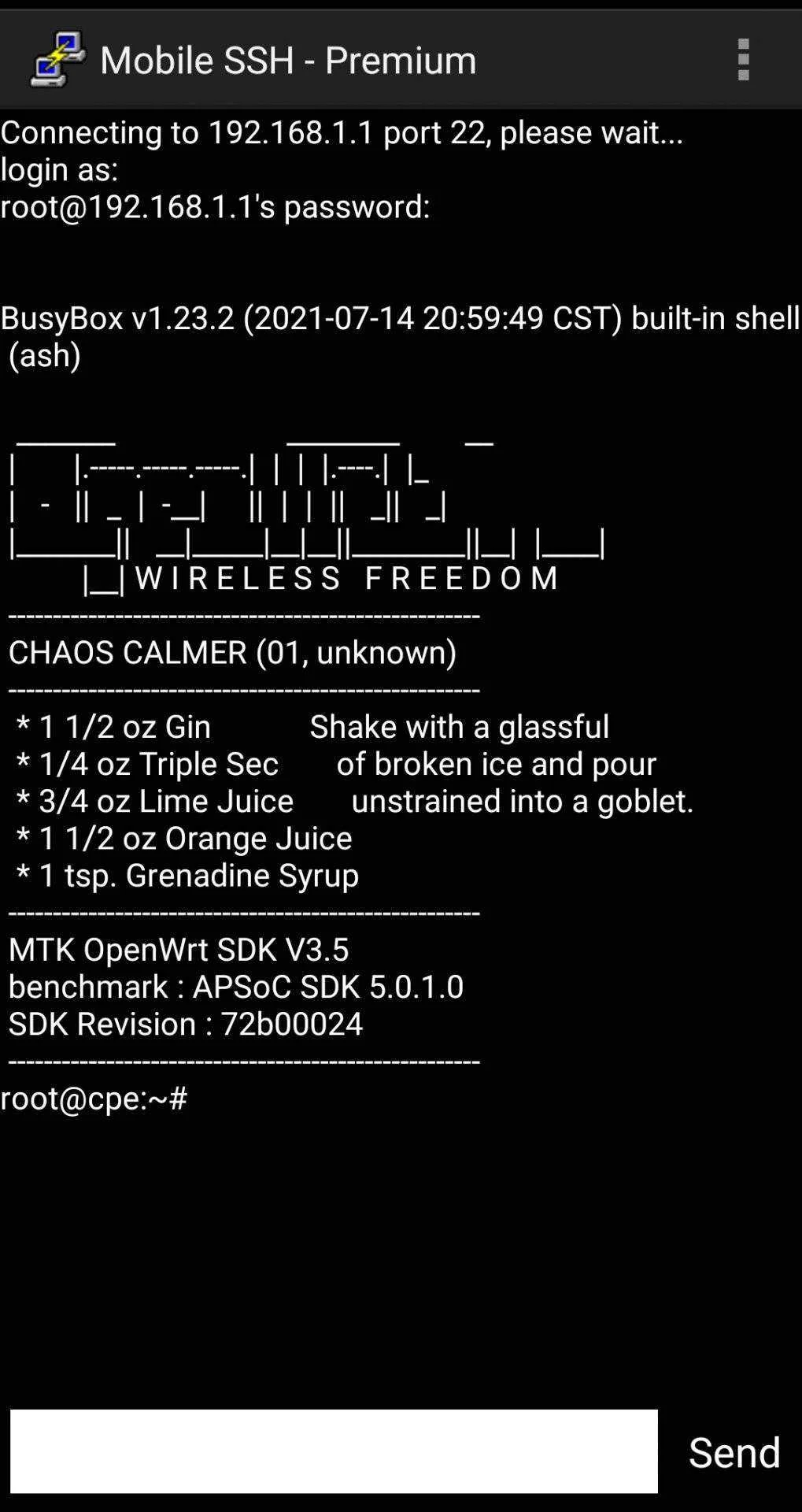

i tried resetting the modem and redid po yung xml pero di na talaga maopen telnet
telnet: Unable to connect to remote host: Network is unreachable
